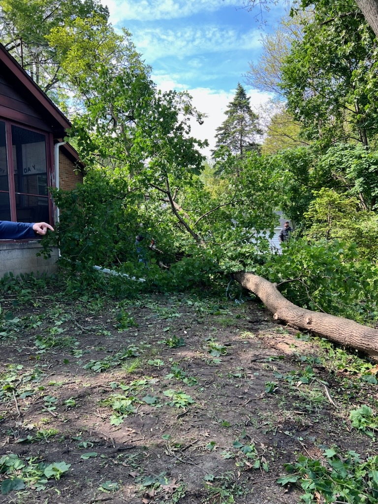

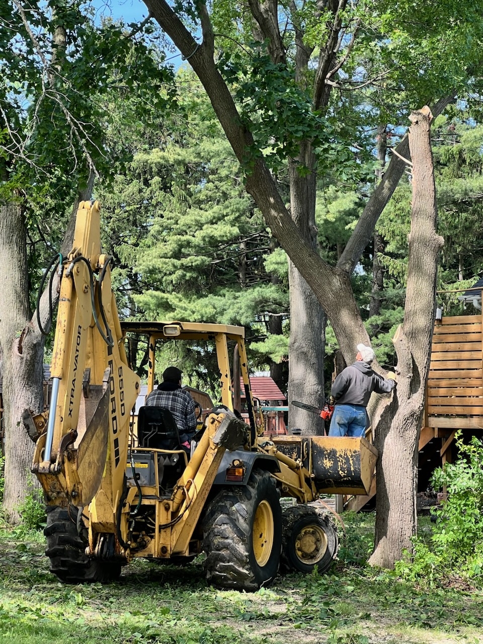

Hiya Fred. About as well as can be expected, I suppose! I did put my machine to work recently removing a fallen treetop, and subsequently, the rest of the tree. It was a tight fit dropping that tree between the house and another tree, but squeaked it in there. Controllers are still going strong. How are you doing?
