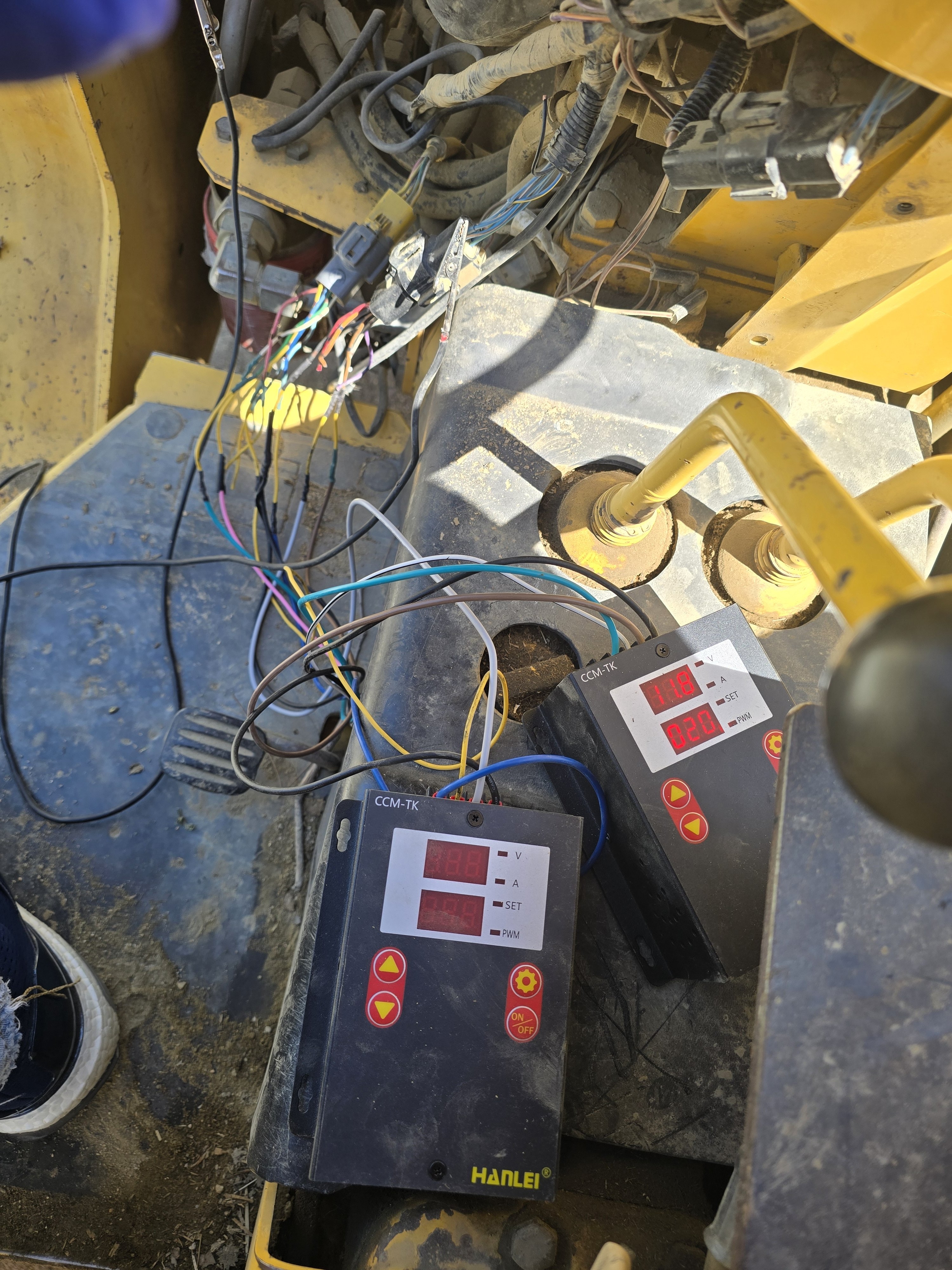

I just kind of temporarily put mine up under the dash above where the pedals are. Only one bolt in each to hold them there, in already existing holes. I haven't gotten around to a more permanent mounting yet.
My turn. Buddy says hi.

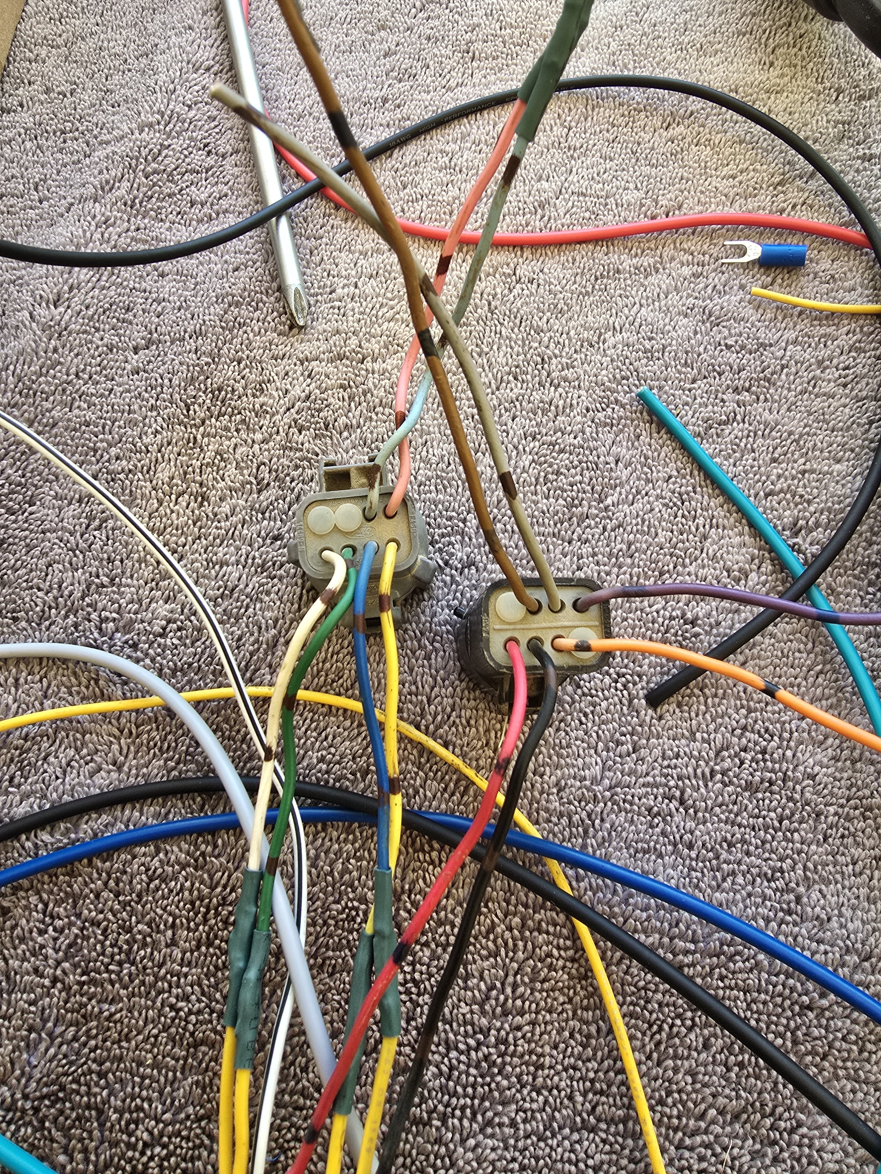

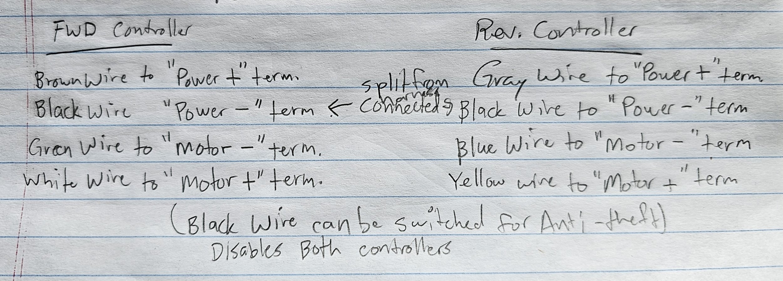

Ok, here is the pinout and connection guide for my 555D using 2 controllers, one for forward and one for reverse. The controllers are "Hanlei CCM-TK." This will allow the machine to function just as it originally did with the shuttle lever. Merry Christmas! Be sure to check your individual machine's schematic to be sure your wires are the same before using these colors! I attached photos of the controller terminals so you can see the labeling of the terminals as well as the two plugs that I sourced from the original TCM. Follow the connections in the 2nd image with the text, ignore the connections in the controller terminal image - that is currently set up for my temporary drive method that uses the toggle switch rather than 2 individual controllers. All of the original safety interlocks should still function with this setup if they were active and not previously disabled, as the power for both the brown and gray wires (FWD and REV signals) comes off of the red wire, which gets shut off if any of the interlock contacts are broken in the electrical path. If any of those were previously disabled, they will still be disabled.

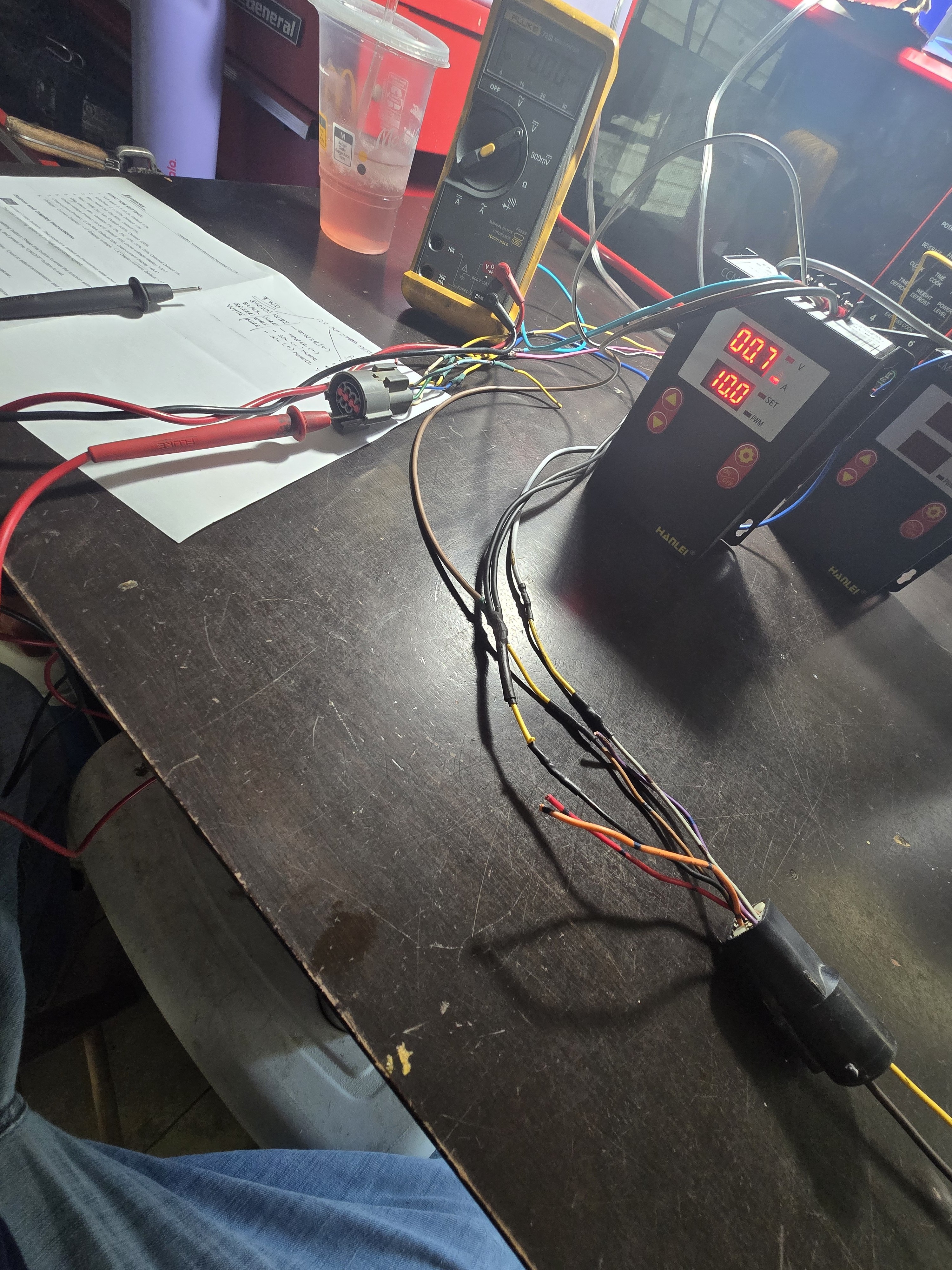

Hello guys. So, finally I'm doing the bench test before transfer to the tractor 🚜.
In the setting #1 I just increase the value one point, everything else is at default.
This is correct?

   / N H Ford 445C TCM no. FONN7Z319AAR. #136
This is correct?
Controllers get 12.5 solid when engine running. I disconnect black wire 'cause when running and switch on wire get 2v.
Tractor engage momentary then nada.

   / N H Ford 445C TCM no. FONN7Z319AAR. #138
POWER WATTAGE MOTOR NEED TO BE SET TO 60. MY TRACTOR ITS ALIVE! THANKS TO YOU @eKretz @TractorTech
