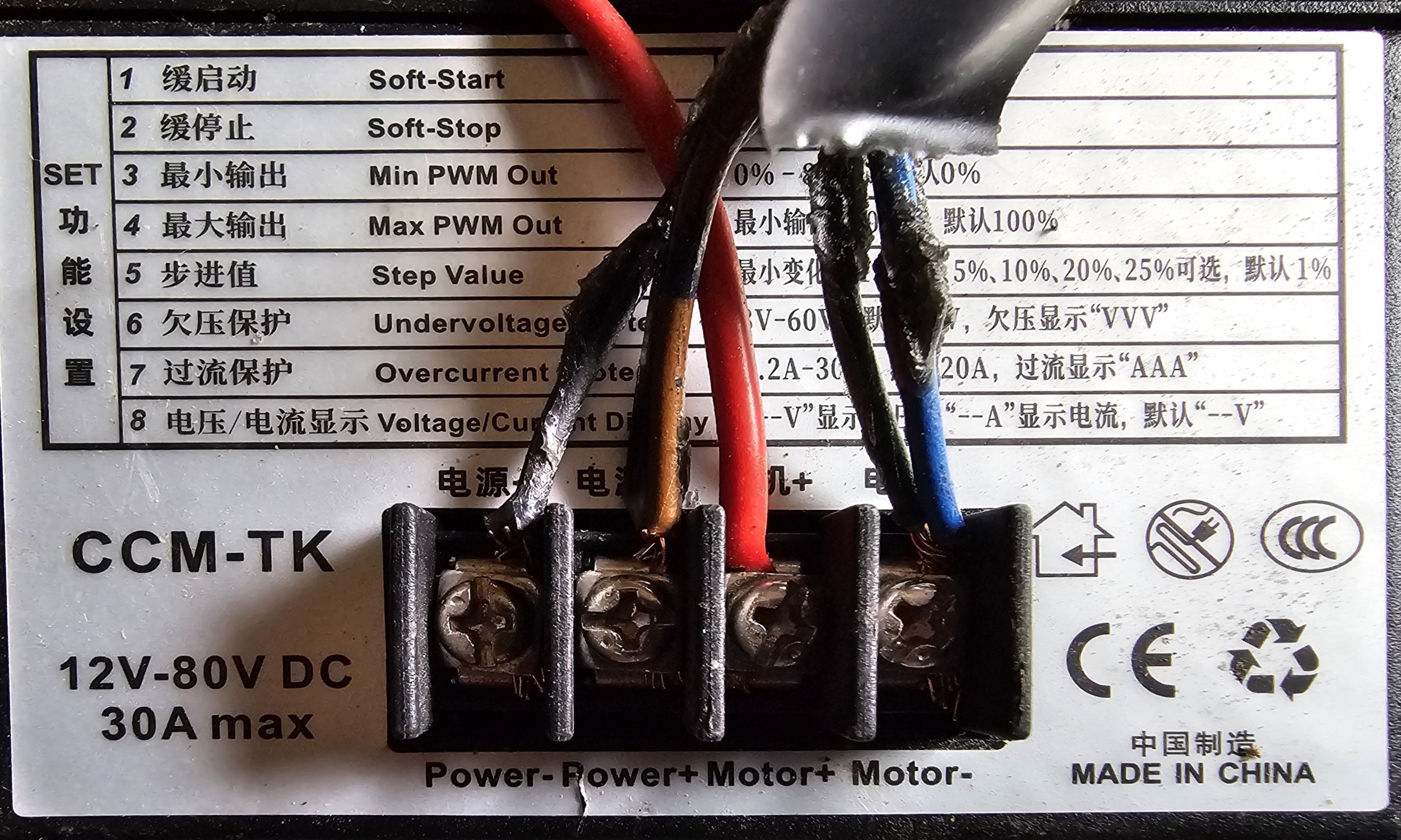

It doesn't look like that controller has soft start, is the only thing. And frequently, these controllers need a mechanical switch flipped to change direction, which would add another complication. I just want to use the original shuttle lever. I could create a small circuit with a couple relays that would eliminate the need for a second module on my setup, but they are so cheap I didn't bother to worry about it. Plus, it would be more complicated for others who don't understand electrical that well to duplicate on their own. If there was more demand I might make something to sell, but I don't expect that it would be worthwhile.
I could just create my own dual soft start circuit and that would probably be sufficient also, I don't think the PWM is actually necessary in this application. A slow voltage rise over several seconds would probably work just fine. But having the PWM module on hand already sort of pushed me in that direction. Simple, quick and inexpensive. The other nice thing about the controllers I am using is that they have a built in setting for overload, just like the original TCM. I can set that for say 1.5 amps, and if the load (solenoid) draws more than that, the module will cut off power, just like the original TCM.

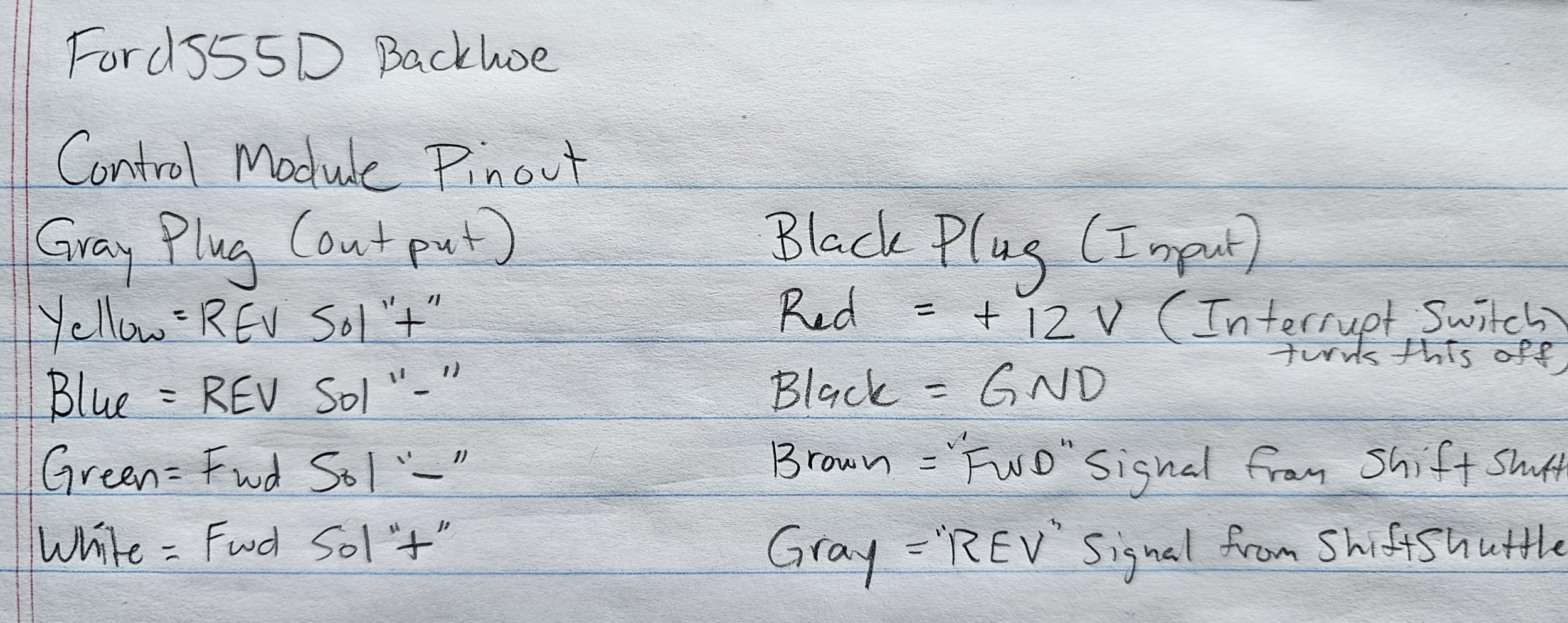

Ekretz, 1st: Merry Christmas, or Happy Holidays. These holiday greetings can get complicated these days. But to me not as complex as my TCM. Mr. ekretz please. sketch me a wiring diagram of this installation. My two little controllers from China will arrive about mid January. TractorTech lead me to you. TractorTech and others have been helpful, but you appear to be the closet to bingo!

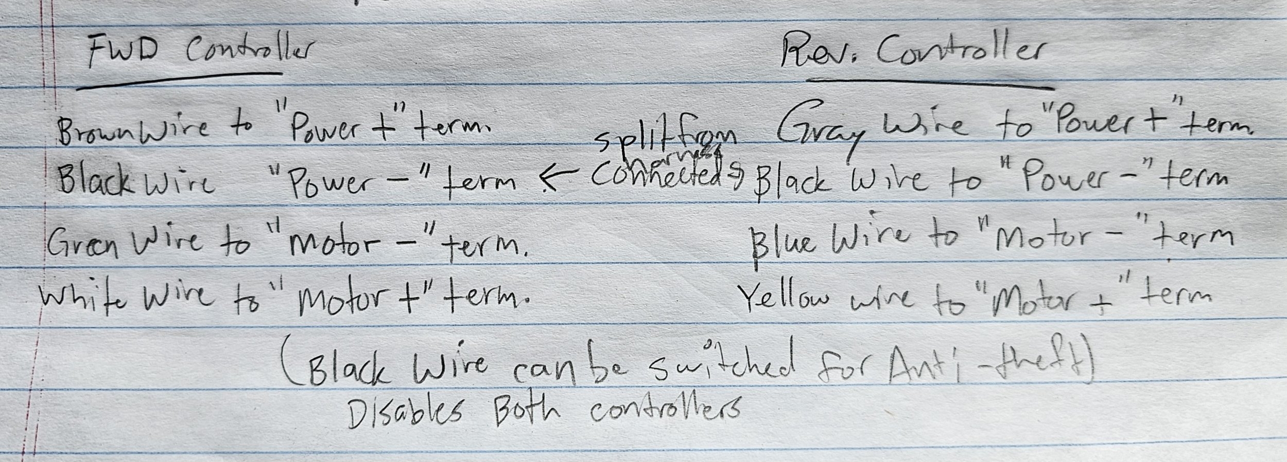

Sure, no problemo. I will draw something out for you and add it shortly. Keep in mind that your wiring harness and colors on the 445 may not be exactly the same as my 555, so I will add descriptions, not just wire colors.

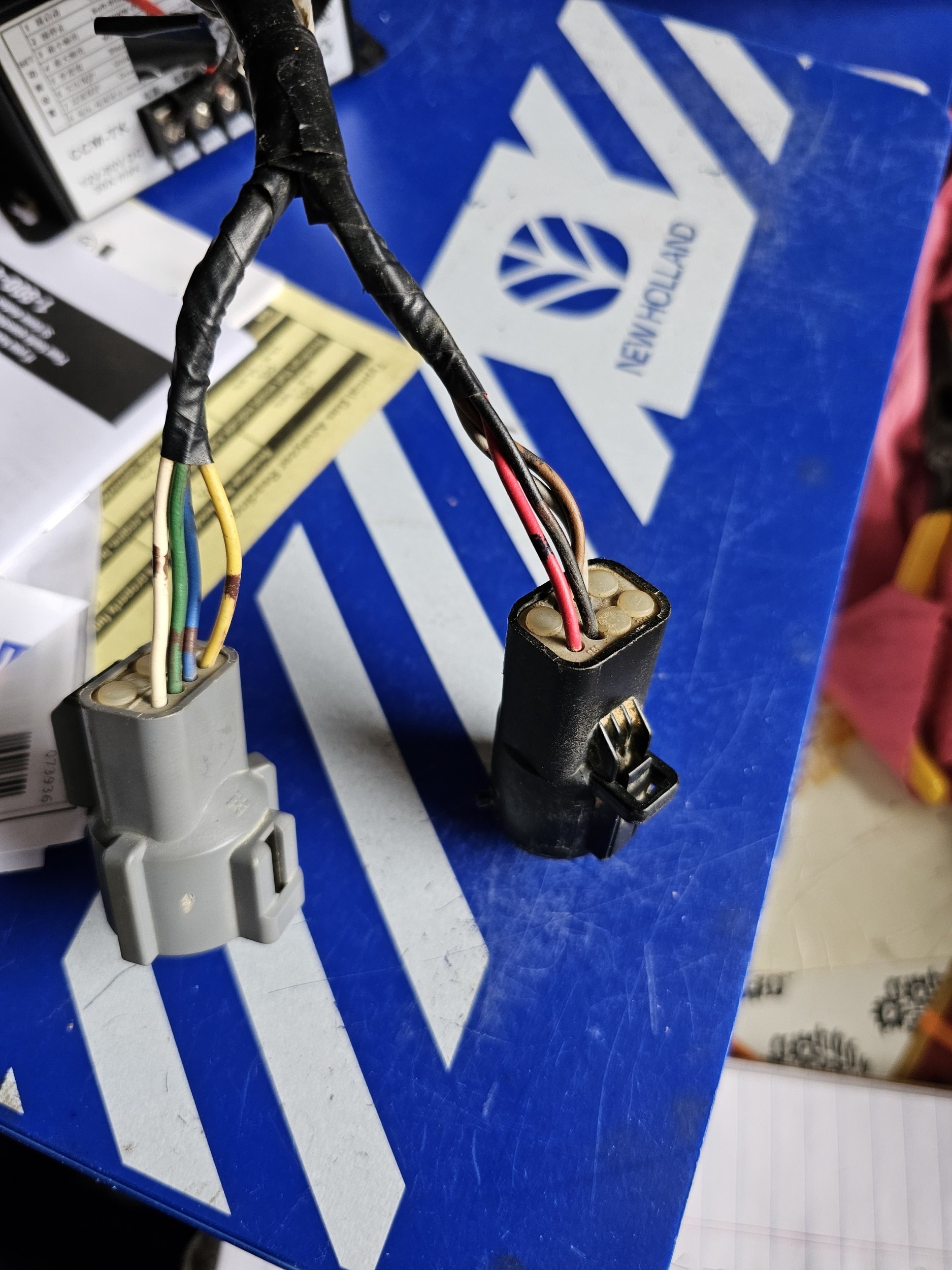

Ok, here is the pinout and connection guide for my 555D using 2 controllers, one for forward and one for reverse. The controllers are "Hanlei CCM-TK." This will allow the machine to function just as it originally did with the shuttle lever. Merry Christmas! Be sure to check your individual machine's schematic to be sure your wires are the same before using these colors! I attached photos of the controller terminals so you can see the labeling of the terminals as well as the two plugs that I sourced from the original TCM. Follow the connections in the 2nd image with the text, ignore the connections in the controller terminal image - that is currently set up for my temporary drive method that uses the toggle switch rather than 2 individual controllers. All of the original safety interlocks should still function with this setup if they were active and not previously disabled, as the power for both the brown and gray wires (FWD and REV signals) comes off of the red wire, which gets shut off if any of the interlock contacts are broken in the electrical path. If any of those were previously disabled, they will still be disabled.

Mr. ekretz, now, this is a Christmas present, especially for you to do this for me today. I noticed your plugs are 4 wire, mine are 6 wires. I'm going to look this over. everything takes me a couple days, these days. Thank you Fred
   / N H Ford 445C TCM no. FONN7Z319AAR. #26
Fred, you are very welcome. FYI, the extra two wires on your machine are going to be for the torque converter lockup solenoid.

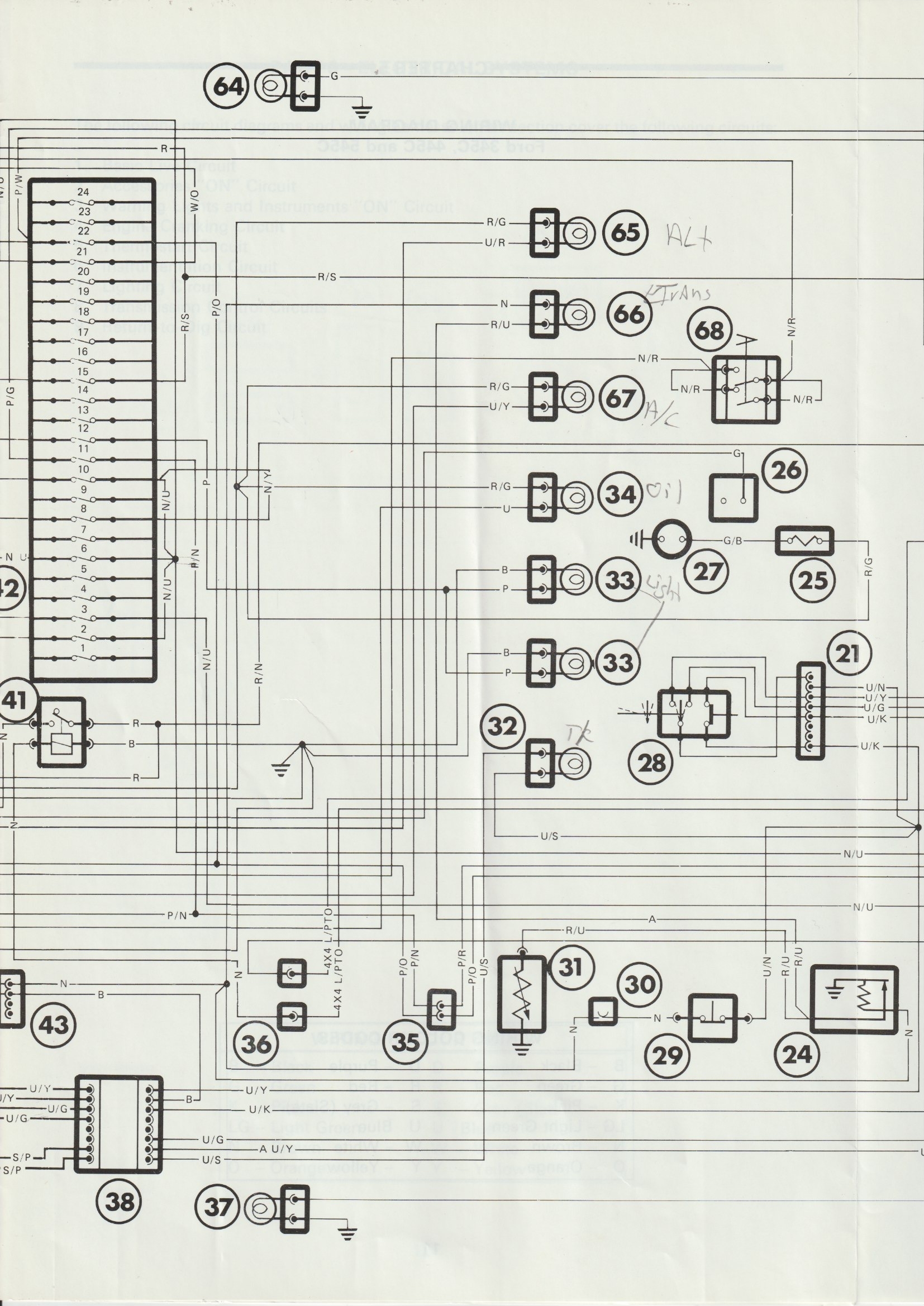

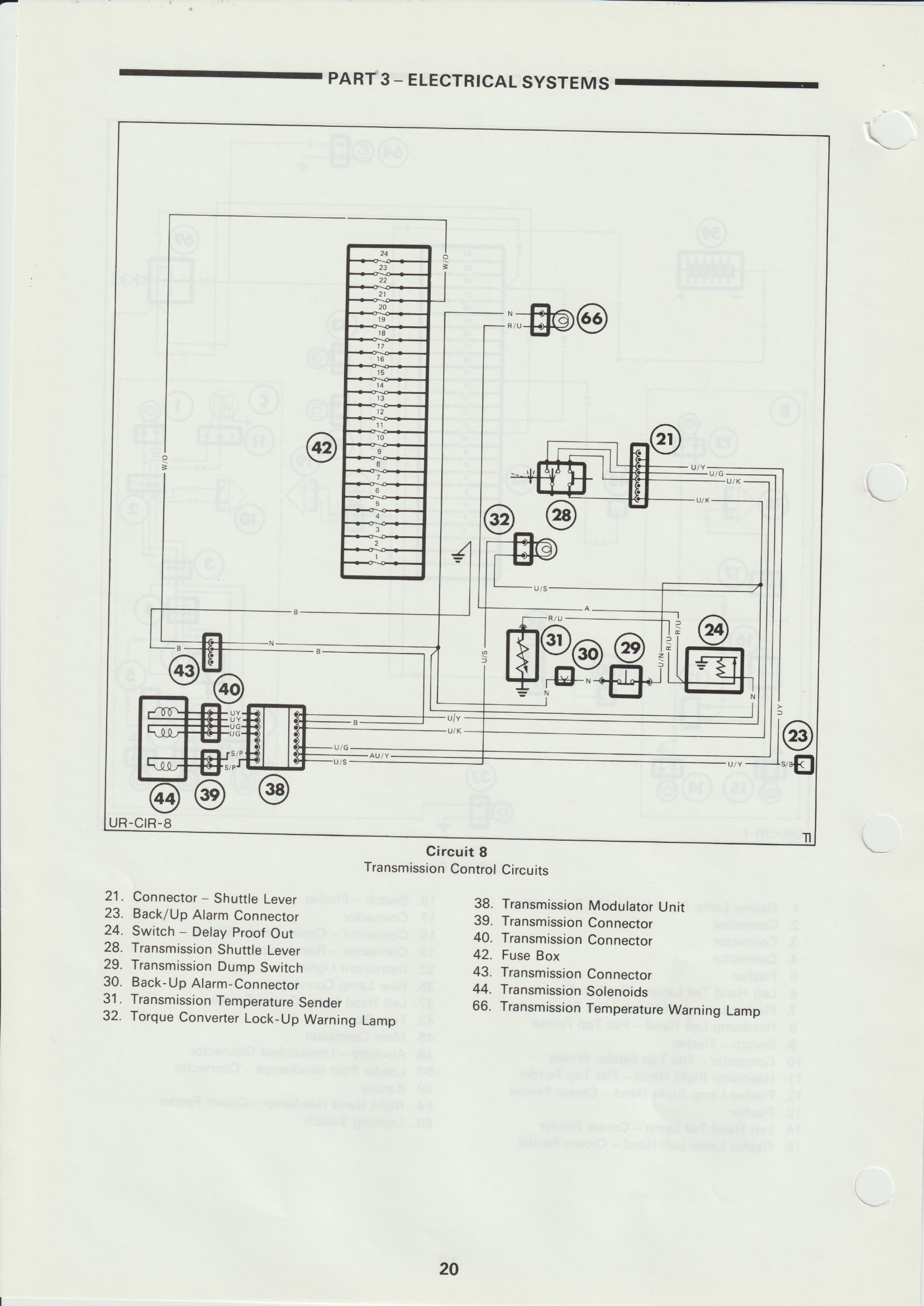

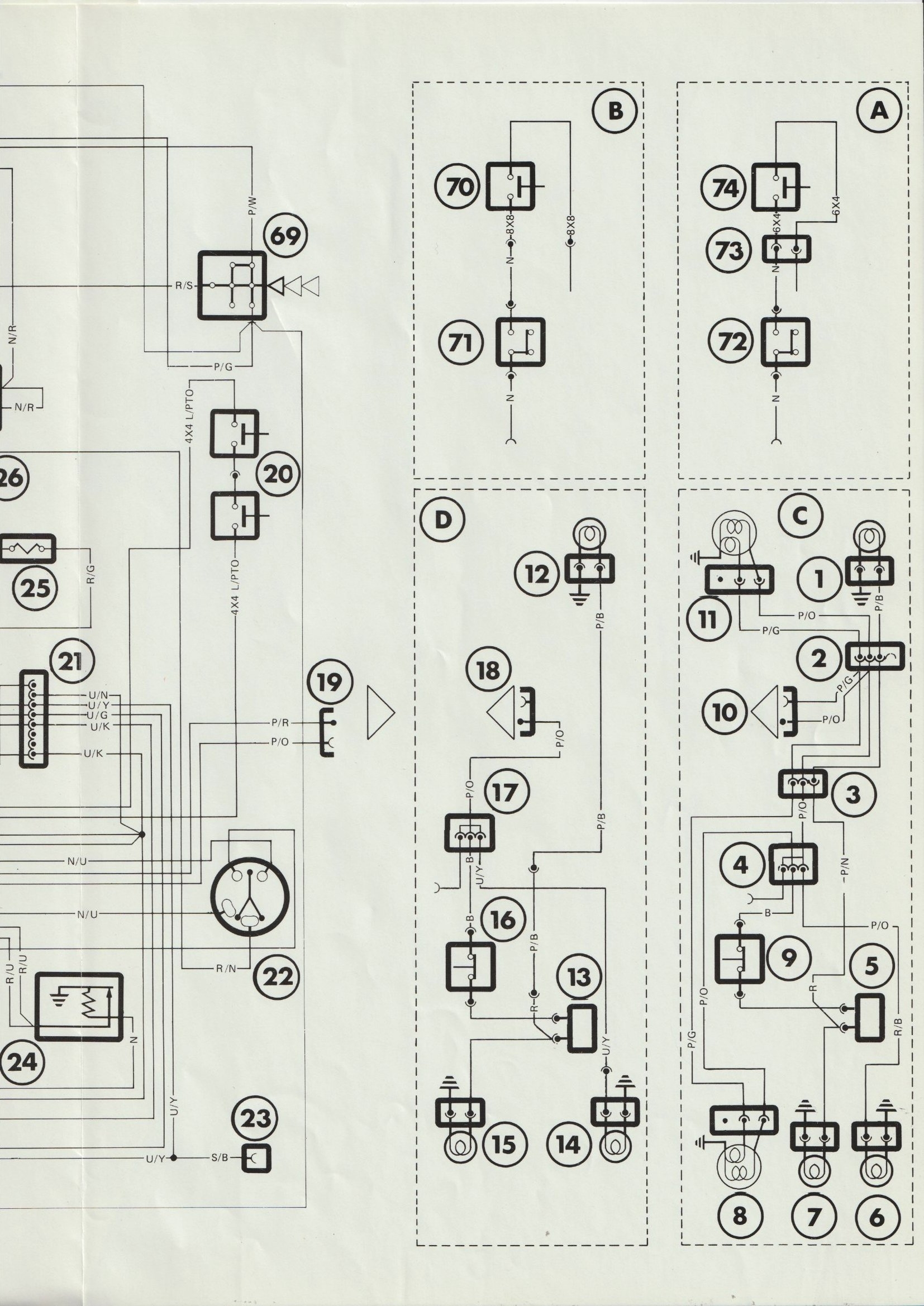

I don't know if this will help, or muddy the waters, but this is from the 345C,445C, 545C service manual
   / N H Ford 445C TCM no. FONN7Z319AAR. #30
I'm not sure I am following those wire color codes. What is U/K for instance? UG, UY may be green and yellow? Ah, missed the color legend in the previous image...
