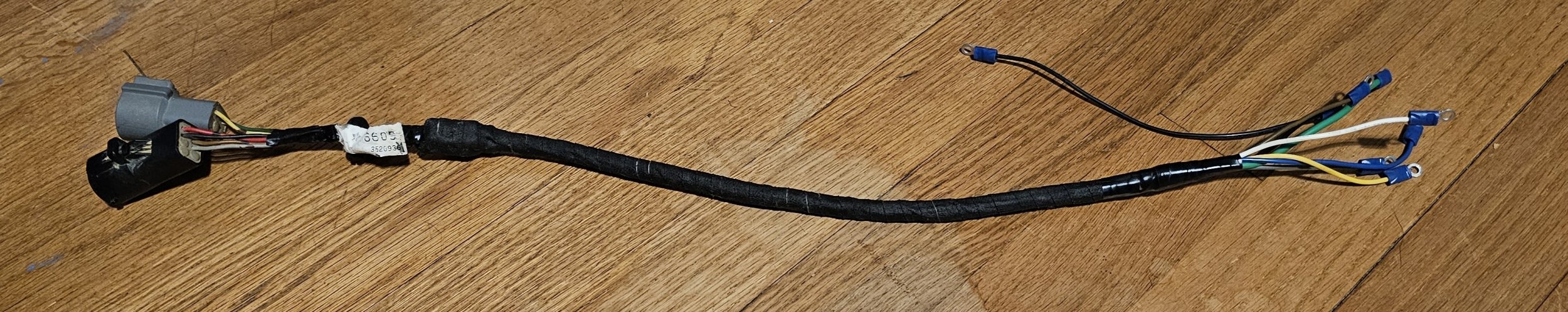

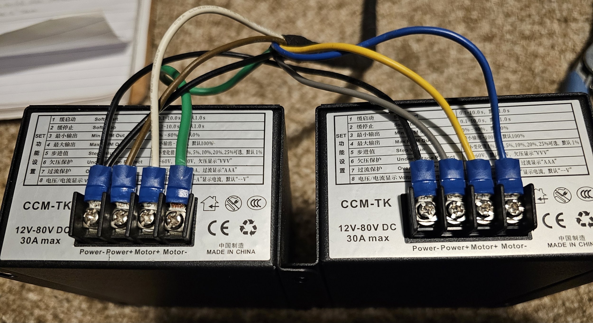

On that note, I finally received my correct order and got the other controllers I ordered. I made up a small extension harness tonight and tested the controllers, everything is working perfectly via shuttle switch. I used the same color wires on my harness that the original harness uses. I'll include a photo of the wired connections. I just ran a jumper across from "Power -" on one controller and connected it to the same terminal on the other with a black wire. On the overload setting I set it at 3.0 amps, and I think I'm settled on a 3.0 second soft start. I left the under-voltage protection setting at 10.0 V. I left my displays set for amperage so I can monitor the current the solenoid coils are pulling. Oh, and the "soft stop" timer I set to 0.2 second so that it's almost instant off.
