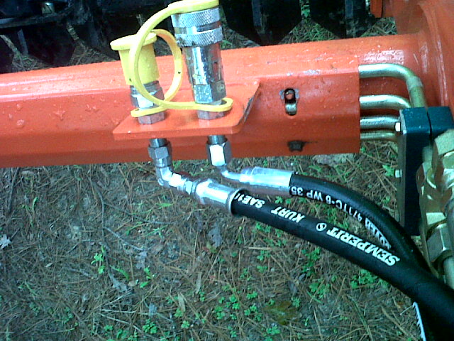

J_J,
Mine look like the attached pic.
Tell me the secret sir! I will FOLLOW directions, I PROMISE! ;)
David

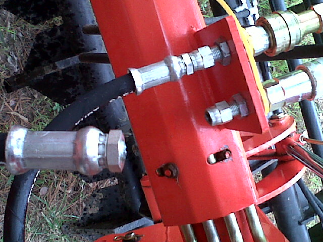

Hmmm... Try this pic...

Actually there is no secret. Sometimes you just have to fiddle around with them until they connect . If it is not pressure causing the problem, it is the fluid on the fittings, making them slippery. The heat will also cause problems with implements left in the sun, but there are ways to prevent the pressure build up, such as making up a dummy plug for the QD. The fluid just expands into the dummy plug setup.
Some QD will connect with low pressure, and others will connect under operating pressure.
/ n00b HYD quick Connect question #7
I believe I would put a 90 or a 45 degree fitting there so as to relieve the stress.

J_J,
I changed the back side to 90 degree to prevent the breakage I had.
I am sorry the picture is cropped, but I believe they are already 45 degree on the QD side...
Not sure I understand how that reduces pressure though...
David

J_J,
David
A lot of fitting will reduce pressure somewhat. Some more than others. Far instance, a 90 degree fitting will reduce the pressure, but two 45 degree fitting will reduce the pressure even less. Just a couple of fittings will not make a big difference.
