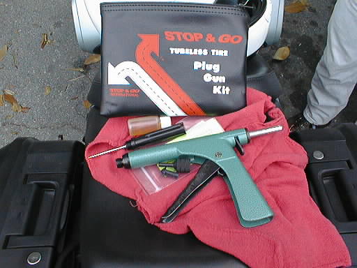

I bought a manually pumped plug gun kit years ago. I plugged a front R4 tire on my Mahindra after running over a nail about 8 years ago. It was still holding air when I sold it last year.
Remove nail, insert reamer tool with screw on gun collar into the tire, prepare plug inside gun tube, unscrew reamer from the collar and QUICKLY screw on the plug gun (note that air will escape once you unscrew the reamer from the gun collar which stays in the tire), pump the gun handle which forces the plug into the tire then pull the gun away from the tire. Trim off excess rubber from plug even with tread. Clean gun when done.
I have done this procedure on many tires. It works best while air is still in the tire. Just top off the air PSI when complete and leak check the plug. I've never had a plug leak in the 15 years I've been plugging tires with this type gun. Here's a pic of the gun like the one I have. There is a more expensive air operated version of this type plug gun but the manual type works for me just fine.
Disclaimer: I am NOT a professional tire guy. I've only been mounting, balancing, and repairing tires for the past 45 years either working in commercial garages or my own.

George2615, I've plugged and patched hundred of tires using Safety Seal products, but I've never seen a tire plug gun before, so I ordered one. Thanks.
