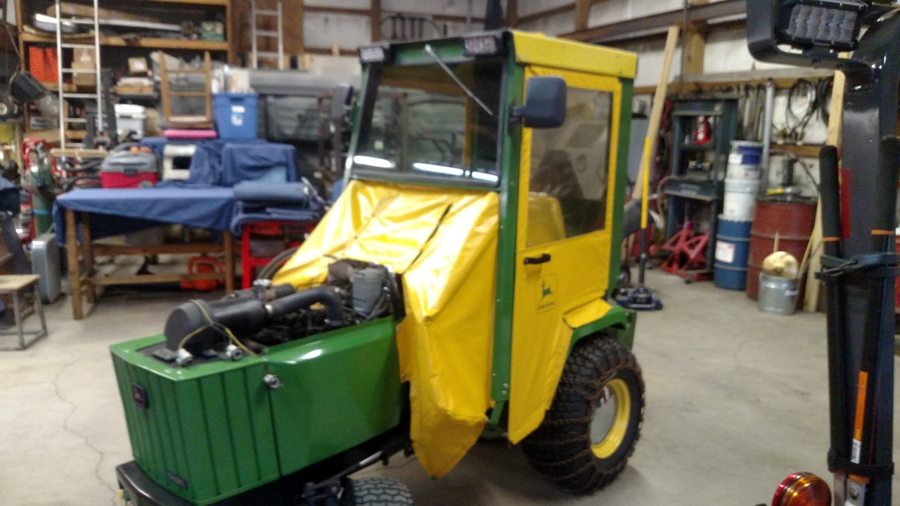

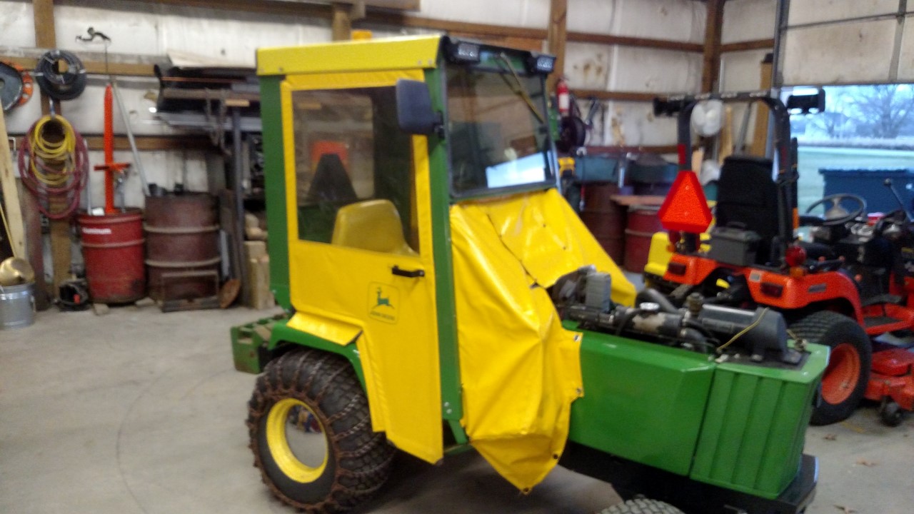

Worked in the 430 this afternoon. Was so nice outside, in the 60's, I opened the overhead door and let the sun and breeze in. Not going to have any more days like this for a while.

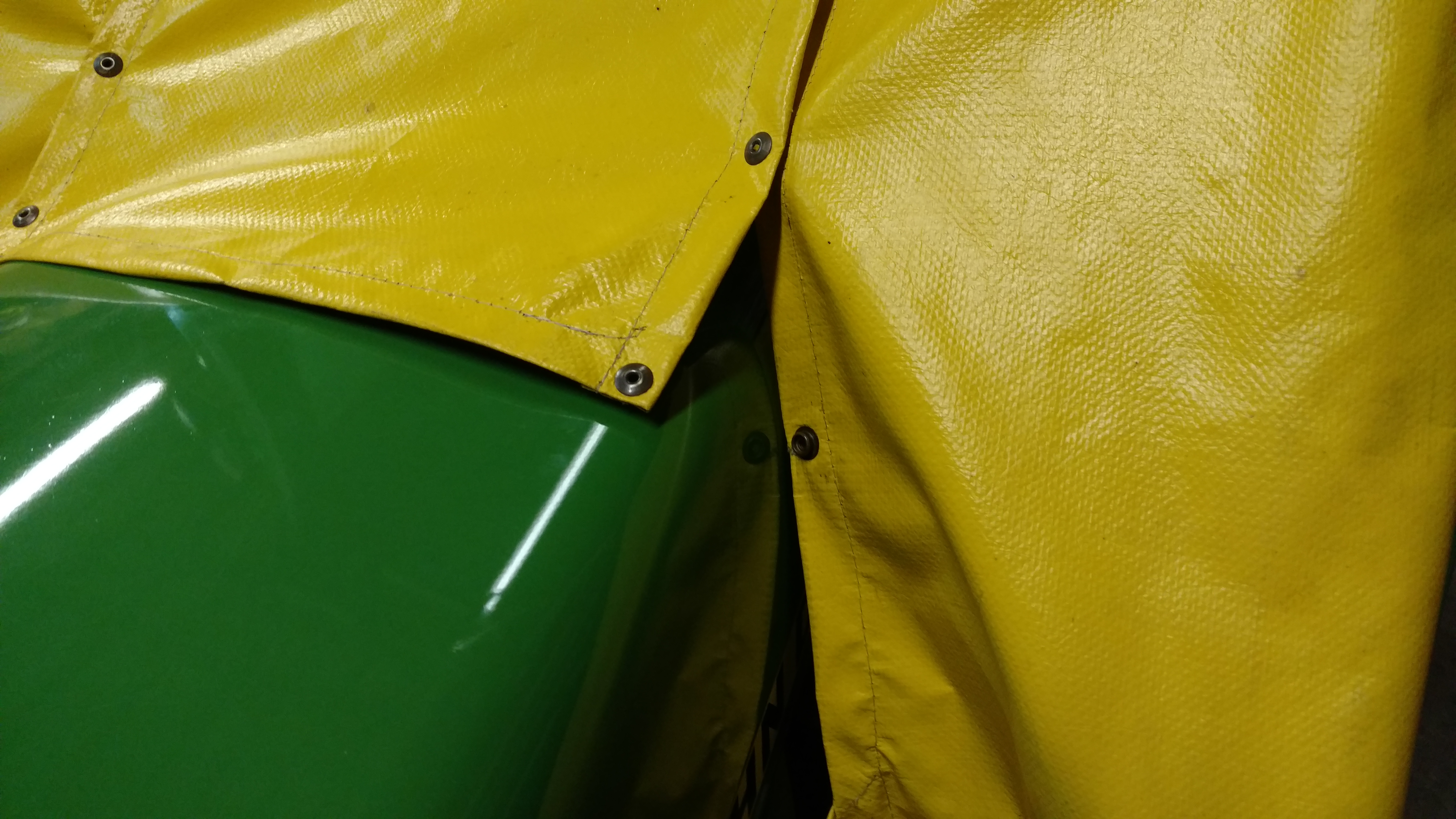

I modified the front cover by removing two of the brass grommets and replaced them with stainless steel marine twist fasteners, like the clasps on some women's purses, Now I can put the twist locks on the side panels and hood to seal out a lot of the cold that would come in around them. Once I get the hood back, that will be about the last thing to do to finish this project up.
After I got those installed, I slid the metal anchoring bars into the pockets and fastened them the the front posts on the cab and did the same with the one that attaches below the front window. I connected the wire for the cab lights and when I turned them on, nothing, no lights. AHA! Then it dawned on me, that I had mounted the cab on rubber pads and they insulated the cab from the chassis. The seat pan is mounted on rubber mounts too, now that I think about it, so I wonder how they ever got a ground before. Hmmmm.
Oh well, after I ran a ground wire to the chassis, the lights work fine.
I got the doors mounted too, so it's starting to look like a real snow fighting machine again.
One other thing that needed attention, as the GF pointed out, were the six 20kg suitcase weights. They really are pretty bad looking. I pulled a couple off, scuffed them up with some 80 grit sandpaper, wiped them down with paint thinner, let them dry and gave them a couple coats of JD green. Tomorrow or Sunday I'll get the rest of them spruced up.

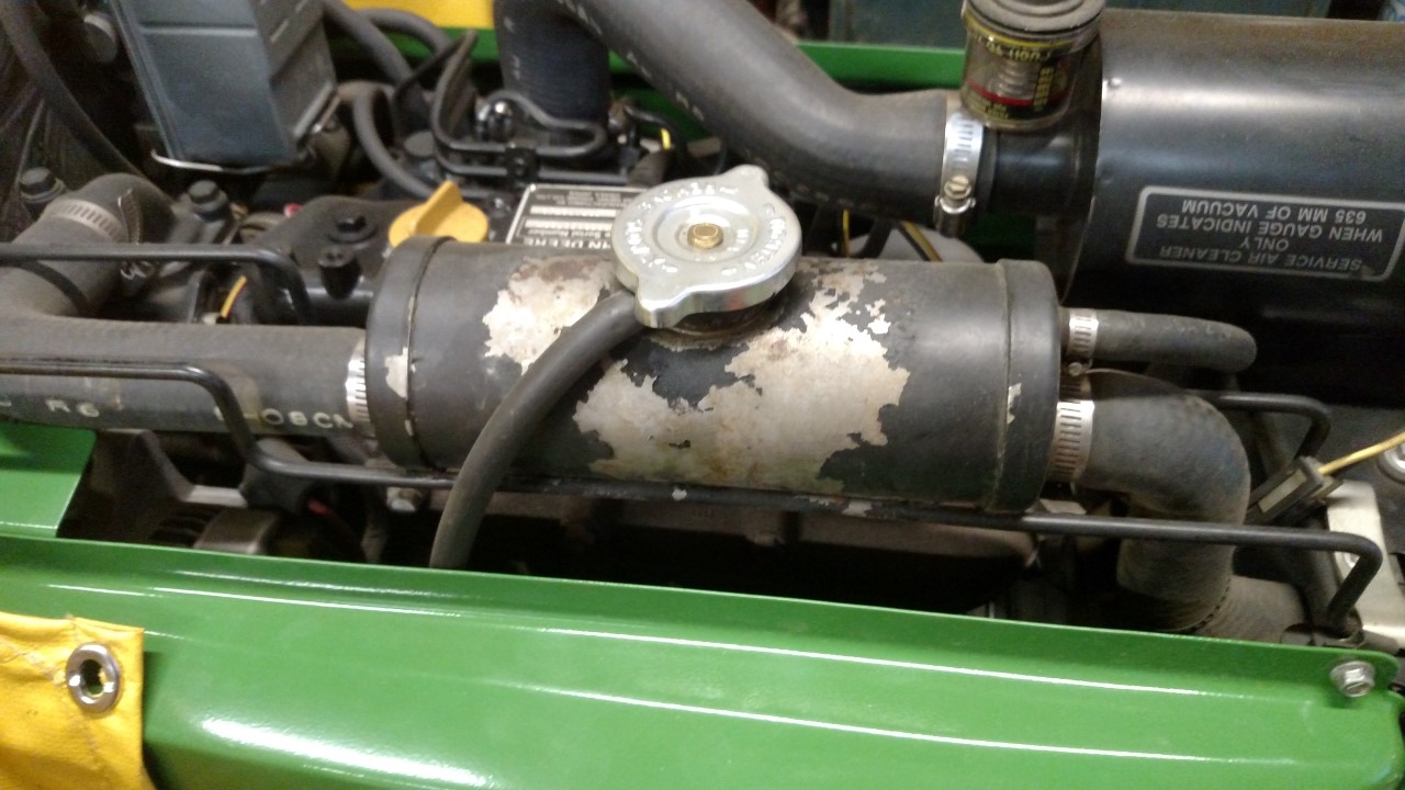

Oh yeah, one other thing that's bugging me is the cooling system surge tank on the engine. The antifreeze has taken the paint/powder coating off and it has a lot of bare metal showing. I'll drain the cooling system so I can remove it, and clean it up, prime and paint it while I'm in the mood.
Gotta check with Brian in the morning to see how the paint on the hood is coming.

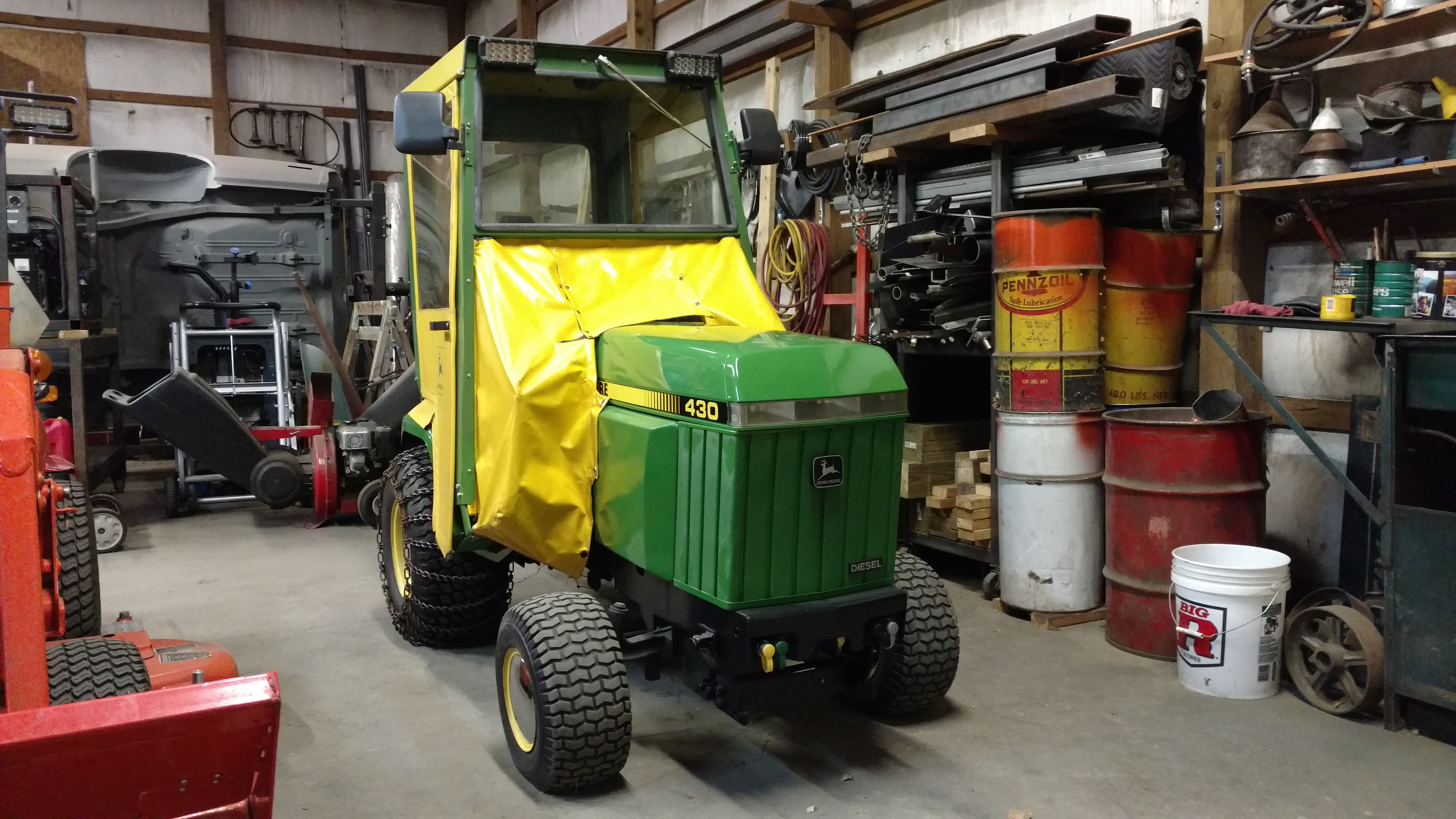

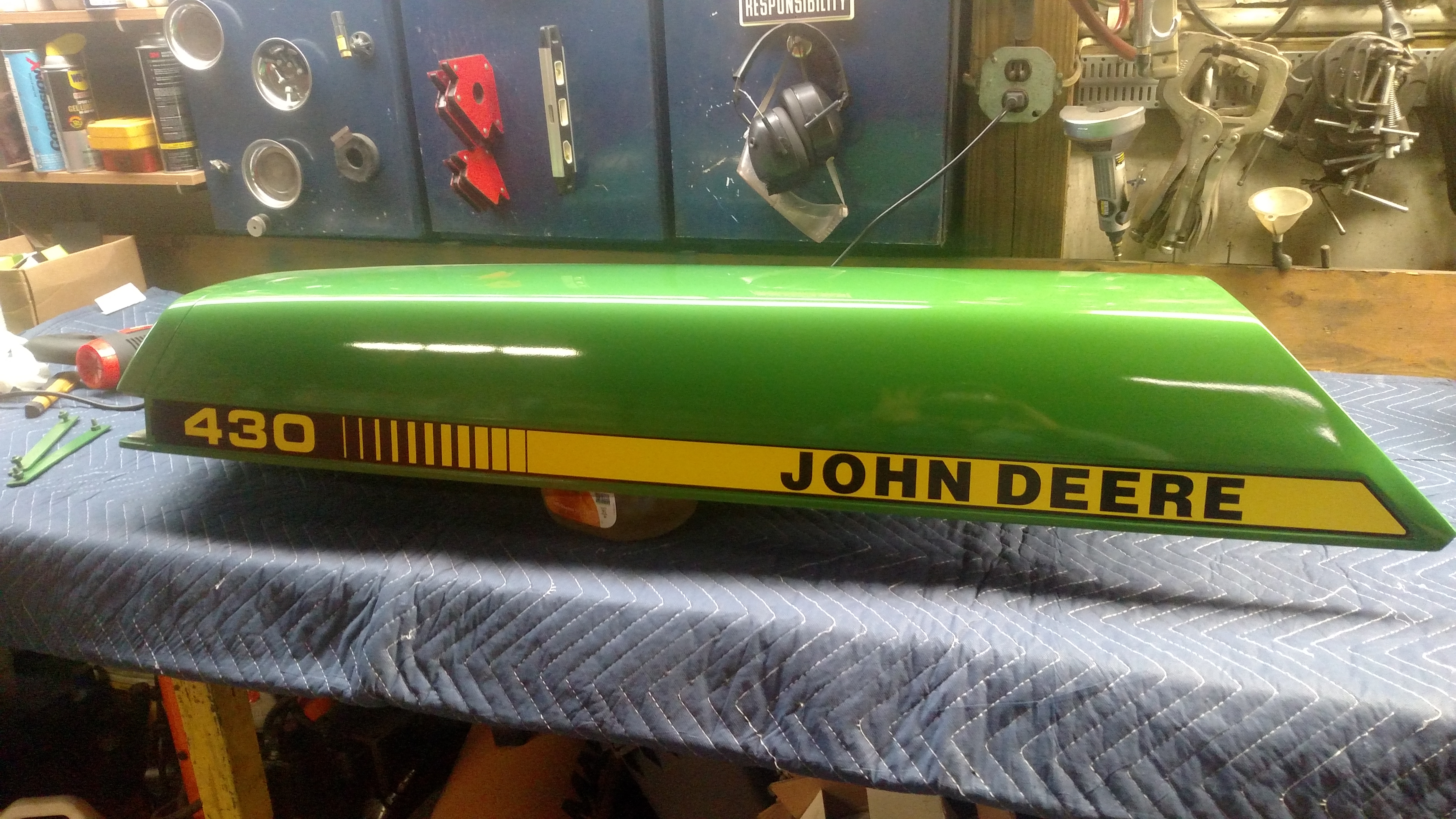

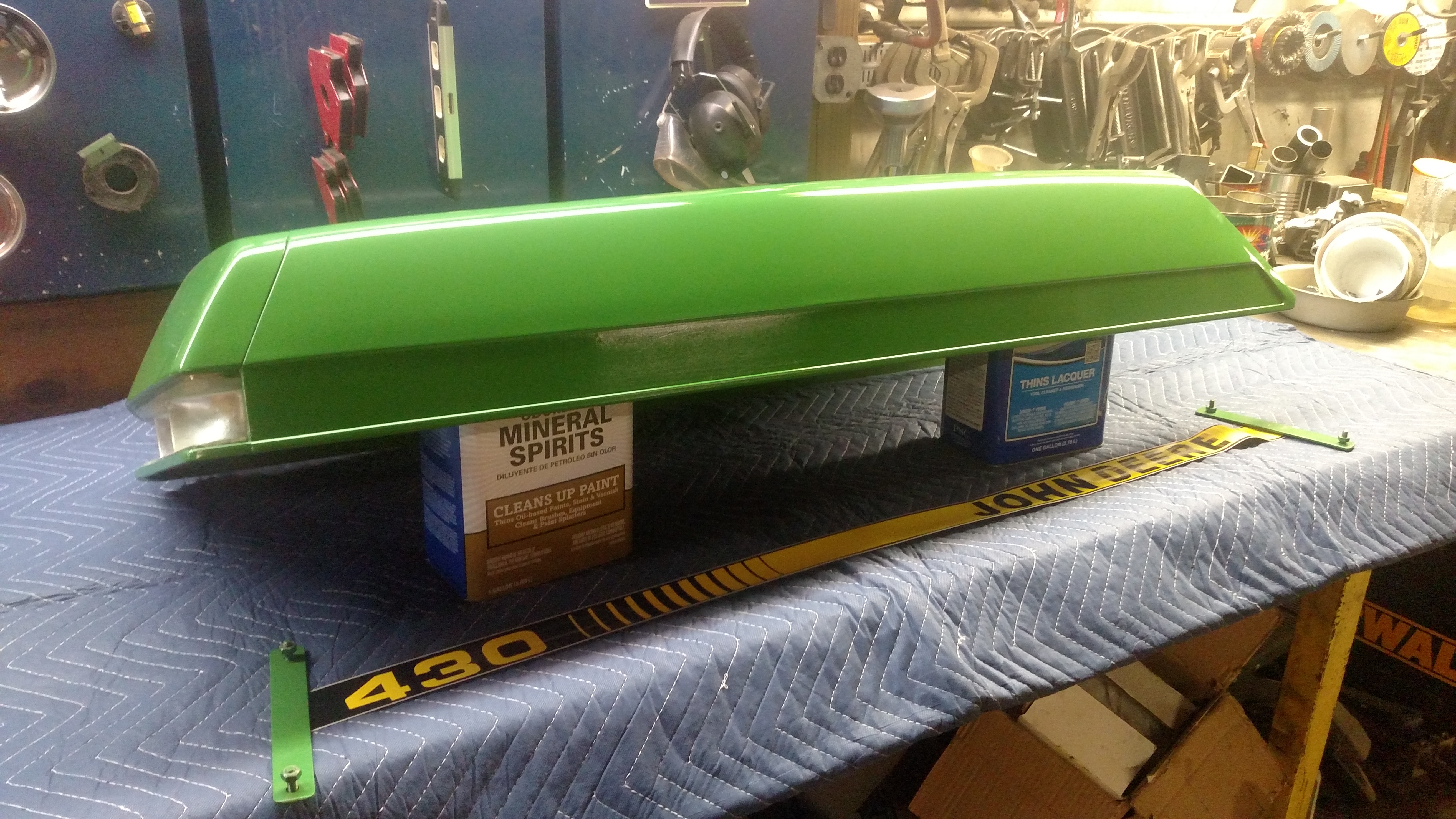

Well, I got the hood back from my painter friend, he did a great job on it. Had another friend come over today and give me a hand putting the 3 foot long decals on the sides of the hood. He has done a lot of work with decals and paint masks in the past, so he was the man to call. Went pretty smoothly, the only problem is that the decals were probably 20 years old and had a ridge where the split in the backing paper was at. It may flatten out when it warms up some or the hood gets good and warm from engine heat.
Tomorrow I'll get it installed on the tractor, and then I need to get some protective film to install where the front fabric drapes over the hood. Previously it had rubbed completely through the paint and down to the plastic/fiberglass, and I don't want it to that again.
Looks like I'm going to need it soon, they're predicting 6-8 inches of snow this week. Time to give the blower overhaul and new mount a workout.

A heat gun or hair blower might help on the fold problem.
   / Naked 430
#36
We tried to flatten it out with a heat gun, helped a little.
Got the hood installed this afternoon. looks pretty good with all the pieces back on it. I still have to put the protective film on the hood where the fabric drapes across it, and put a couple of snaps on the side panels to secure the sides of the fairing. The film will be here tomorrow and I'll get it applied and the snaps installed.

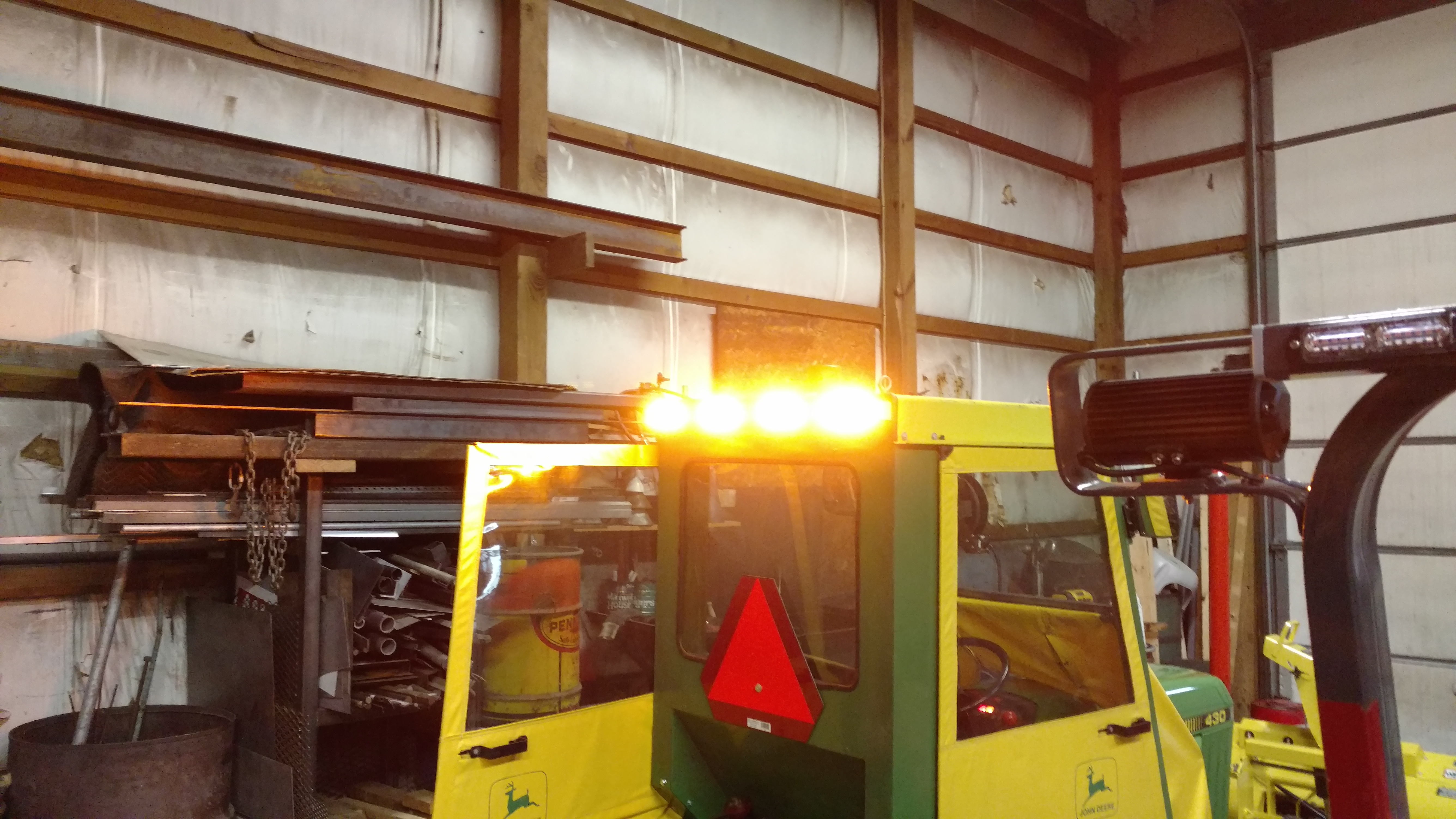

I'm also making a light bar for the rear of the cab. It will have four flashing LED lights on it. I got the bar they mount on drilled, tapped and painted Sunday, and I'll try to get the lights installed and wired up in a day or two.

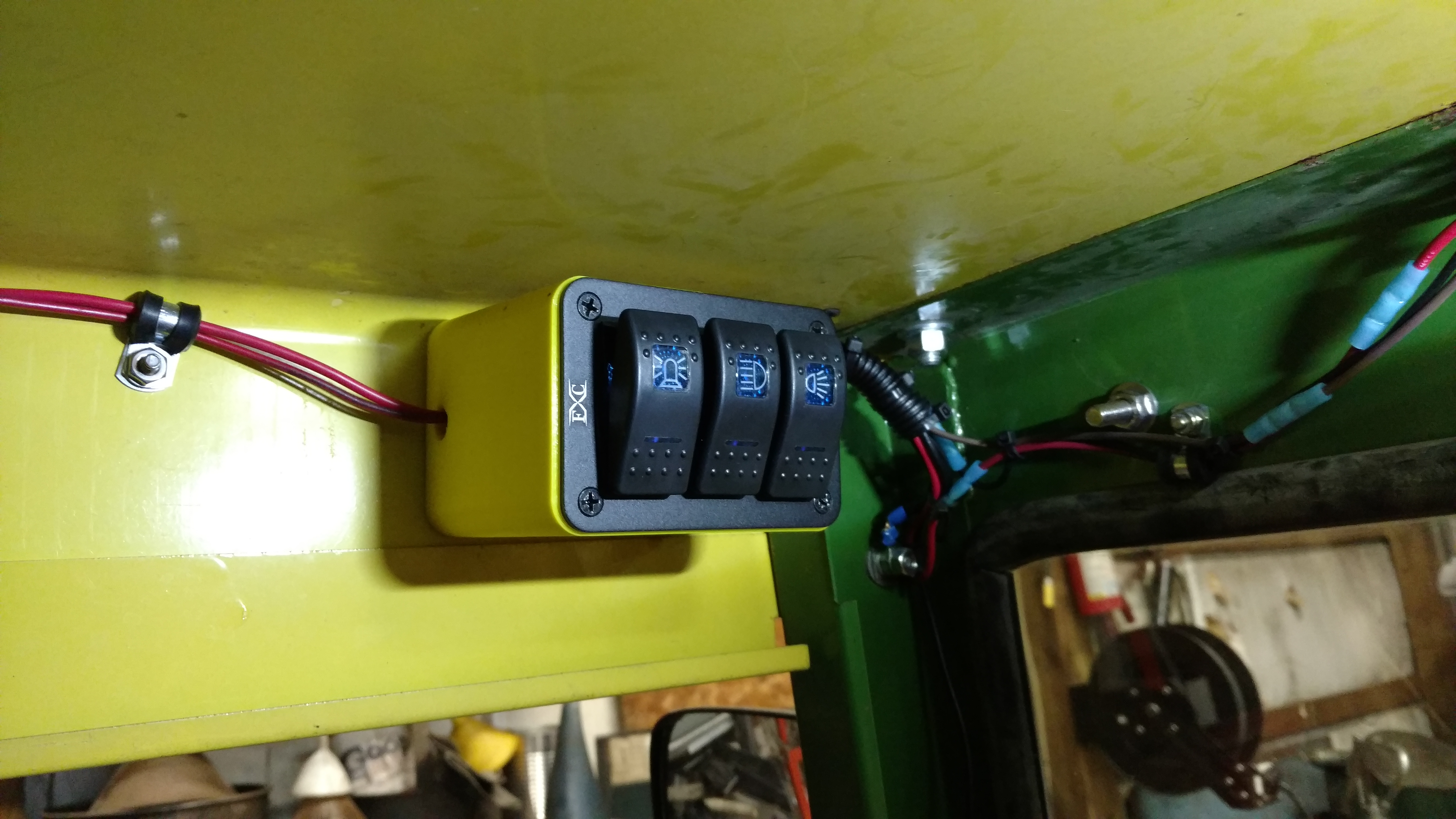

#39
I installed a box with three switched in it above the left cab door this afternoon. I got the gang switch off Amazon for $20, and its all wired up right out of the box, Just connect 12 volts, ground and the leads to the three lights, pretty slick. I printed up a box to mount it in on my 3D printer, with a couple of holes to run wires in and out. I had a cigarette lighter socket I don't use any more mounted where I wanted put the switch box, so I removed it and used that hole to mount the plastic box. So now I have separate switches for the strobe on top of the cab, the four light bar I just installed on the back of the cab, and the flood lights on the front.
Link to the switch: Amazon.com : FXC Rocker Switch Aluminum Panel 3 Gang Toggle Switches Dash 5 Pin ON/Off 2 LED Backlit for Boat Car Marine Blue : Sports & Outdoors
The light bar has four 12 led lights that can be set to different flash patterns, by grounding one of the wires, and are synchronized by connecting all the sync wires together. I mounted them in a 1 1/2" square tube and 3D printed caps for both ends, one with a hole where I mounted a weatherproof push button switch so I can change the flash pattern if I want. It only draws about 1.5 amps maximum as my power supply showed.
I got the 3M adhesive stone guard material today, laid out where I want it on the hood, and have it taped down in place. Saturday I'll turn the heat on in the shop so it will get warm enough to apply it properly.
Now I have to talk to a local tarp shop about modifying the center piece of the front fabric cover so I can get all the snaps fastened. Since I modified the formers that frame the area where the pedals and your feet go, they won't pull together enough to get them snapped. I need the piece remade about 2-3 inches wider so they can snap together. We'll see what they say.

Great work BX, and rather clever using a 3D printer to create a box for the switches.
BUT, isn't there always a but.
I'm not to excited about your use of crimps to connect your wires. Moisture, time and a little salt mist will cause the connections to fail. The copper wire strands will corrord away, starting with intermittent and then total failure.
A much better way is to solder them and then use shrink tubing that has sealant in it. The tubing protects the connection from any unintentional contact with other wires or frame and the sealant seals out any moisture.
Richard
