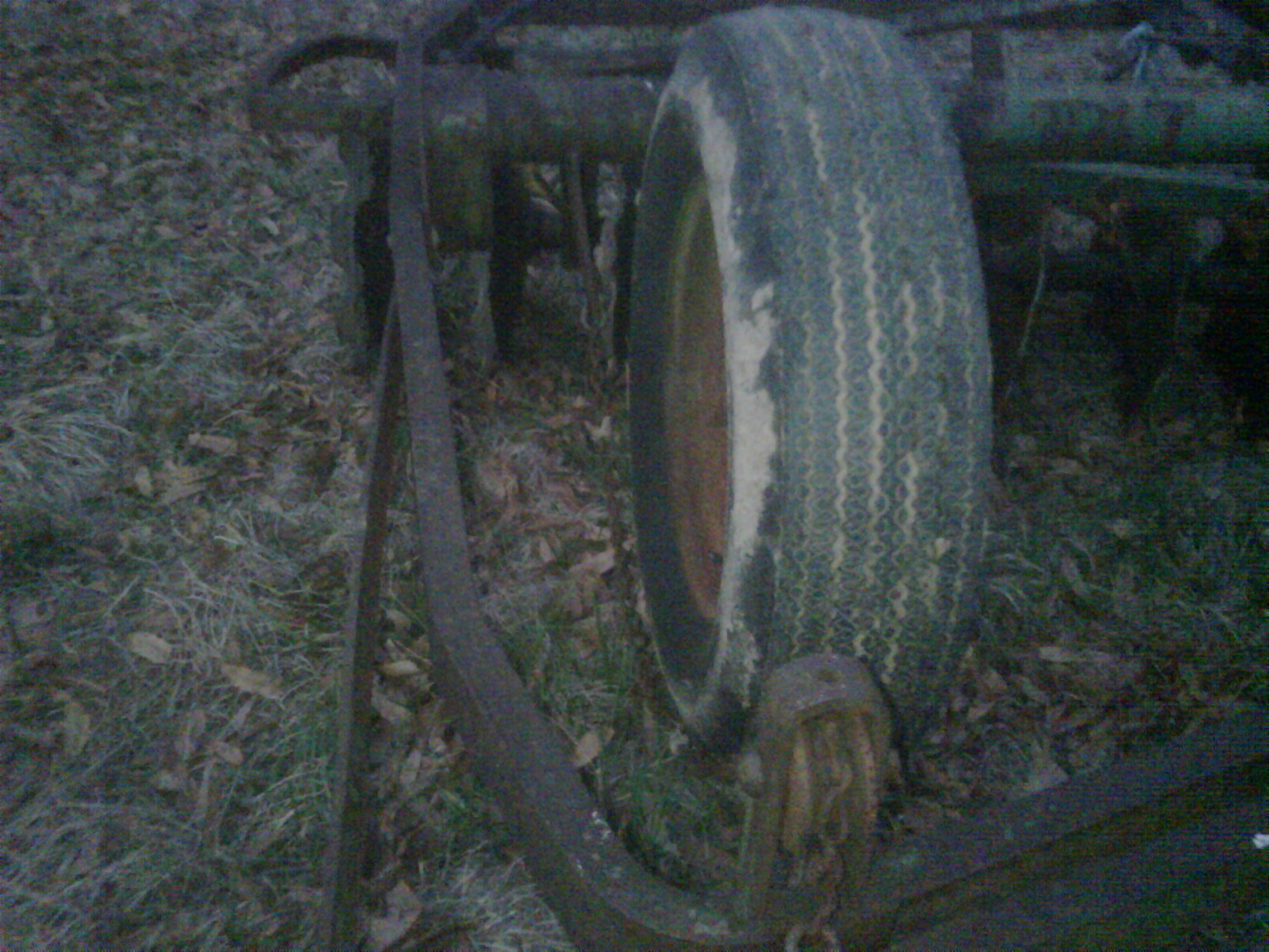

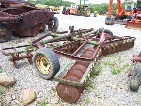

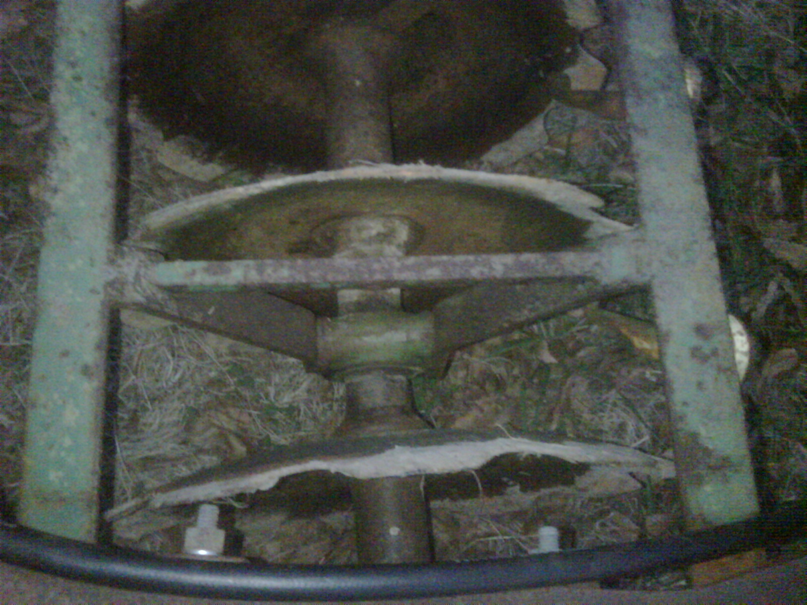

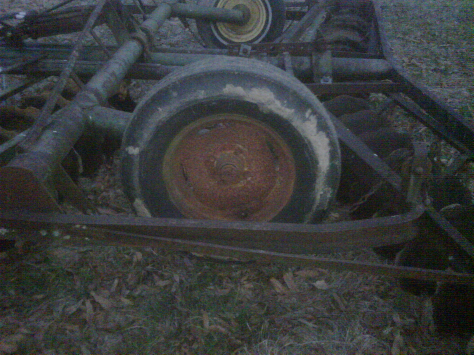

I am re-working my father-in-law's old JD disc that I recently acquired, but don't know the exact model. I found a JD KBA 12' (1st attached pic) on the internet that is real similar, but this one is a 14'. I am pretty sure that many of the KB, KC, KBA, KBL, and KBY parts are interchangeable, but I still want to know model of this disc. I couldn't make out any model # on the disc. Any suggestions?

It is also similar to RW and RWA models.

The pic looks like a RW to me. I have a lot of Used parts for the RW series. Ken Sweet

If his disc is like the one in good first pic in the OP. It is not a AW, I have a AW and they are on roller bearings and have flex built inti the frame work with limiting chains and pulleys. The RW's are on Cast Box bearings usually and are all rigid framed. Ken Sweet

I got to a computer with better reolution and the 3rd picture on the top set is a AW. Ken Sweet

Thanks, after looking at pics of an AW, I believe that is what I have.

Found AW on the side of the disc. Still not sure exactly the reason for the chains and pulleys.
