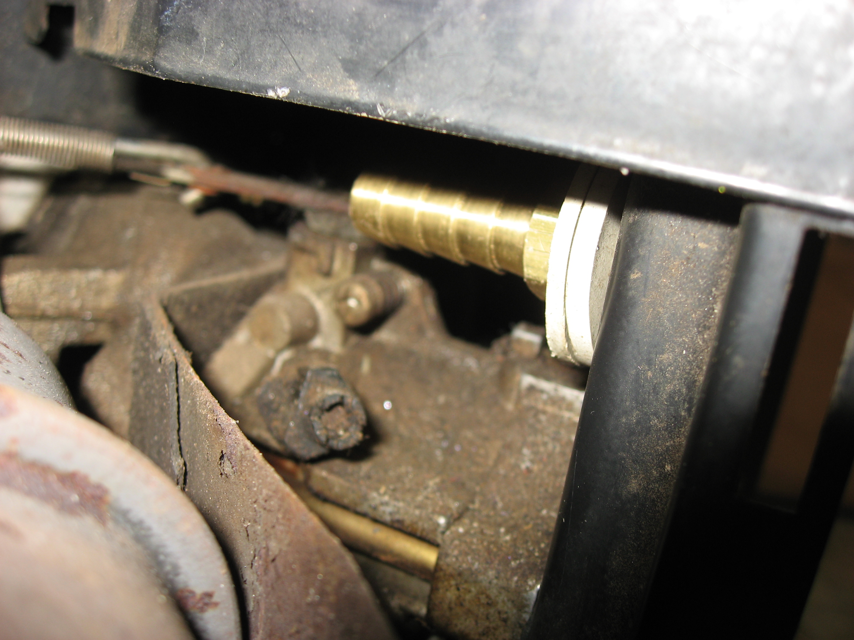

#21

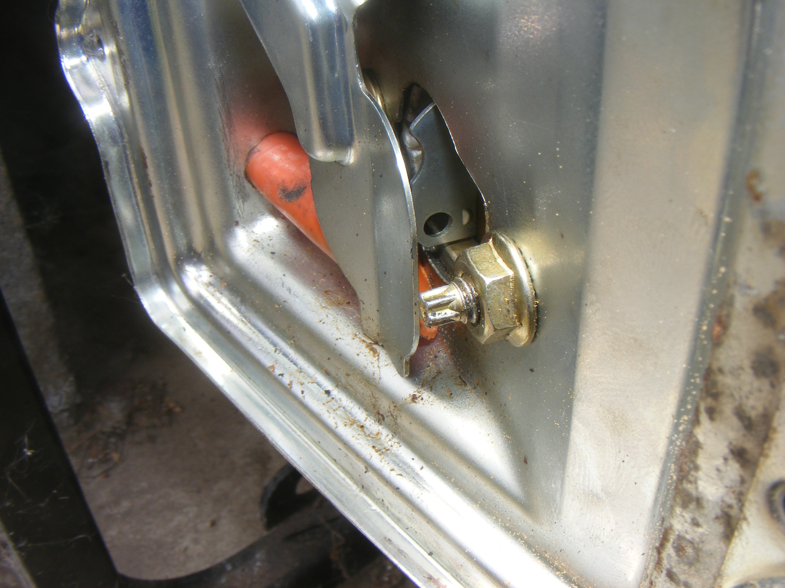

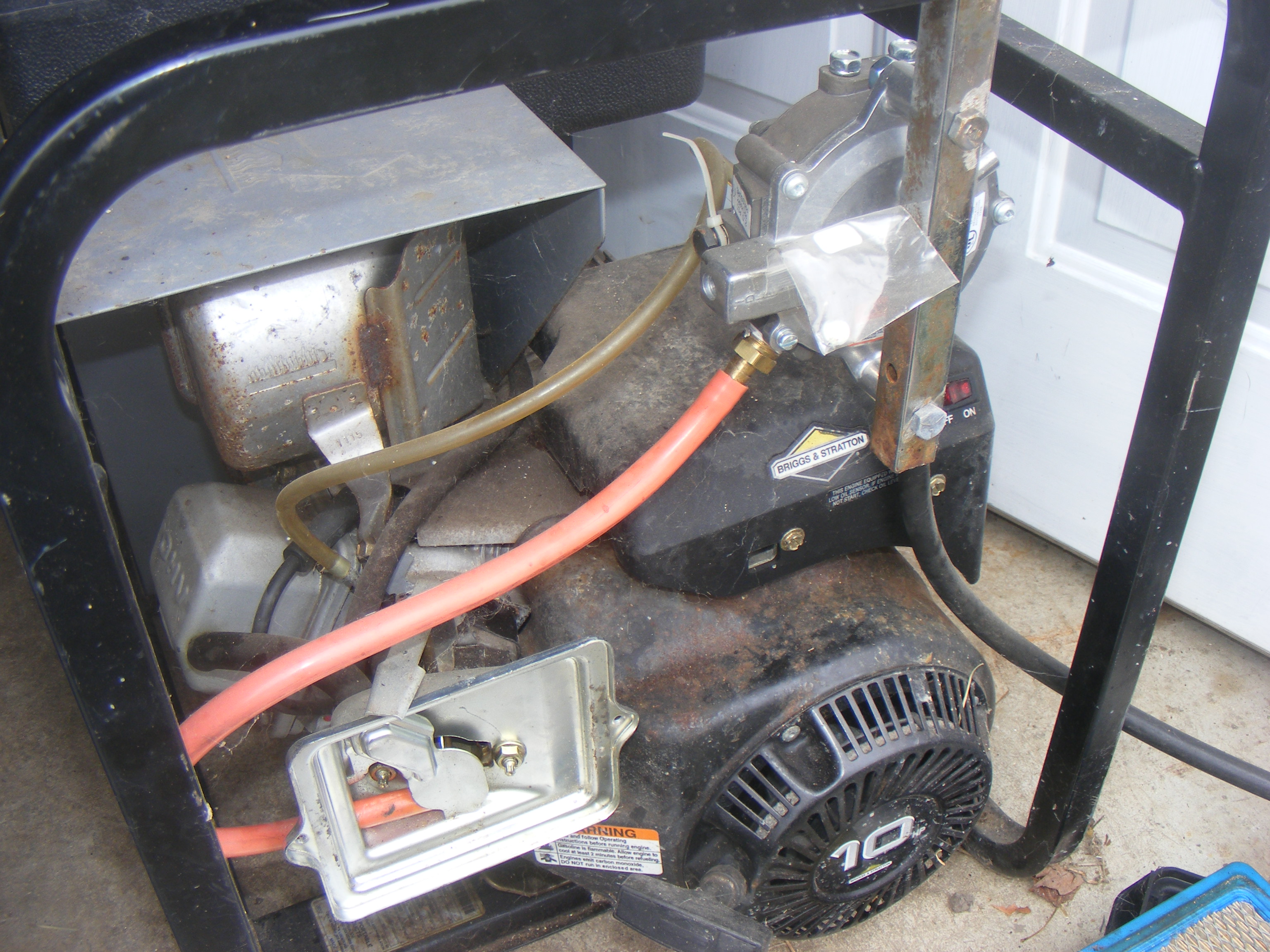

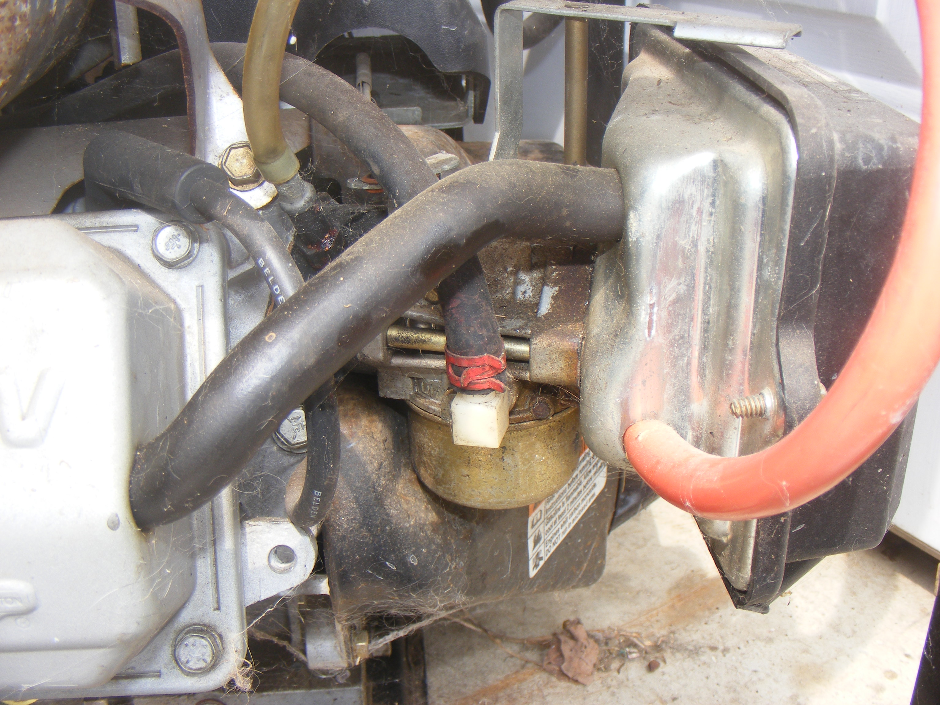

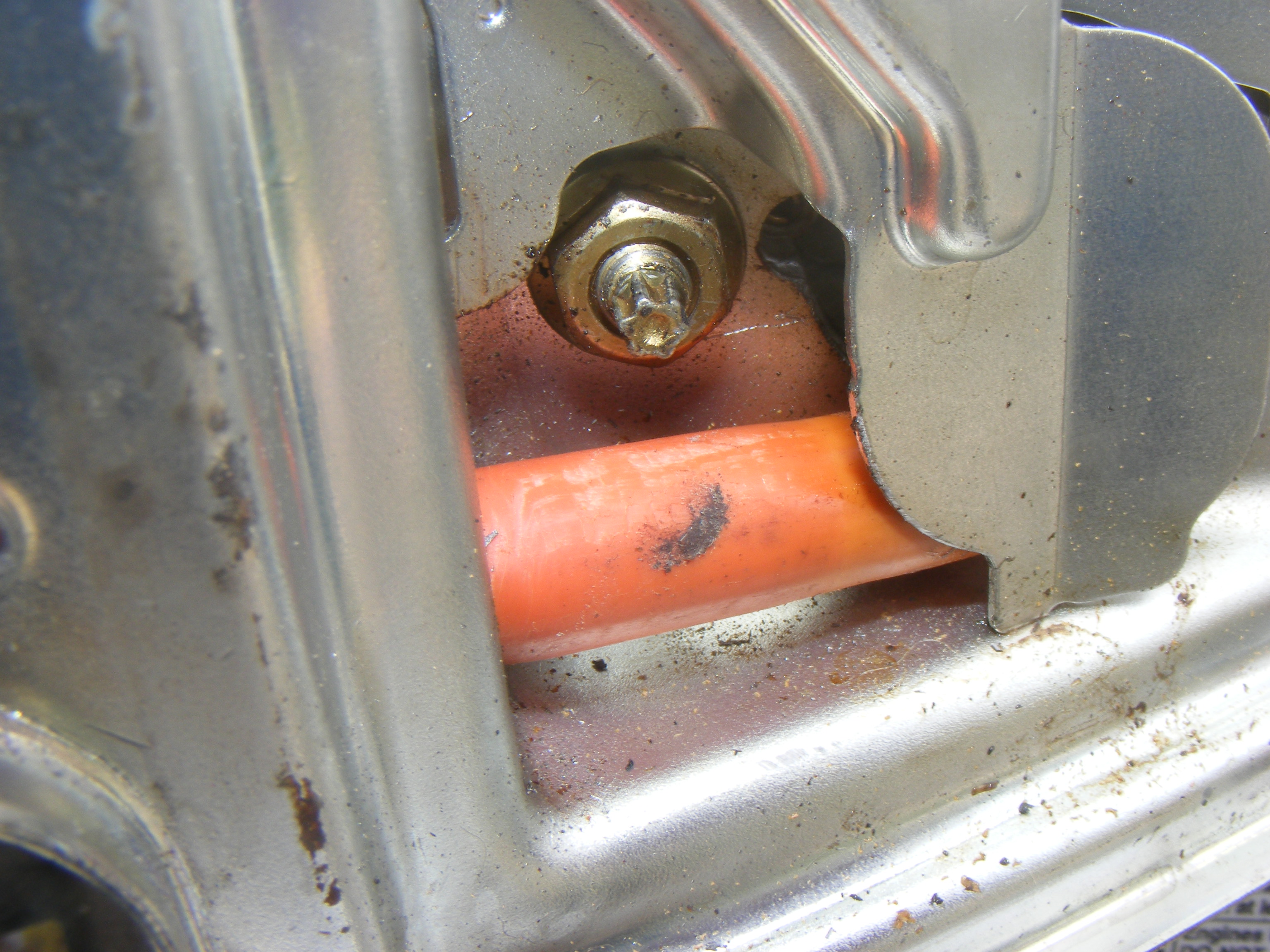

This is what I did, yes it egg shaped the hose a bit.
Looks simple enough. Does the end of the hose just terminate under the plate?
   / Natural gas conversion - where to feed the gas #22
yes about center with the inlet, I used a tapered ream to size the hole for the hose in the air box , tight enough I had to wiggle the hose all the way into place , after a good seal around the hose, If you over shoot the size use some RTV sealant around it .

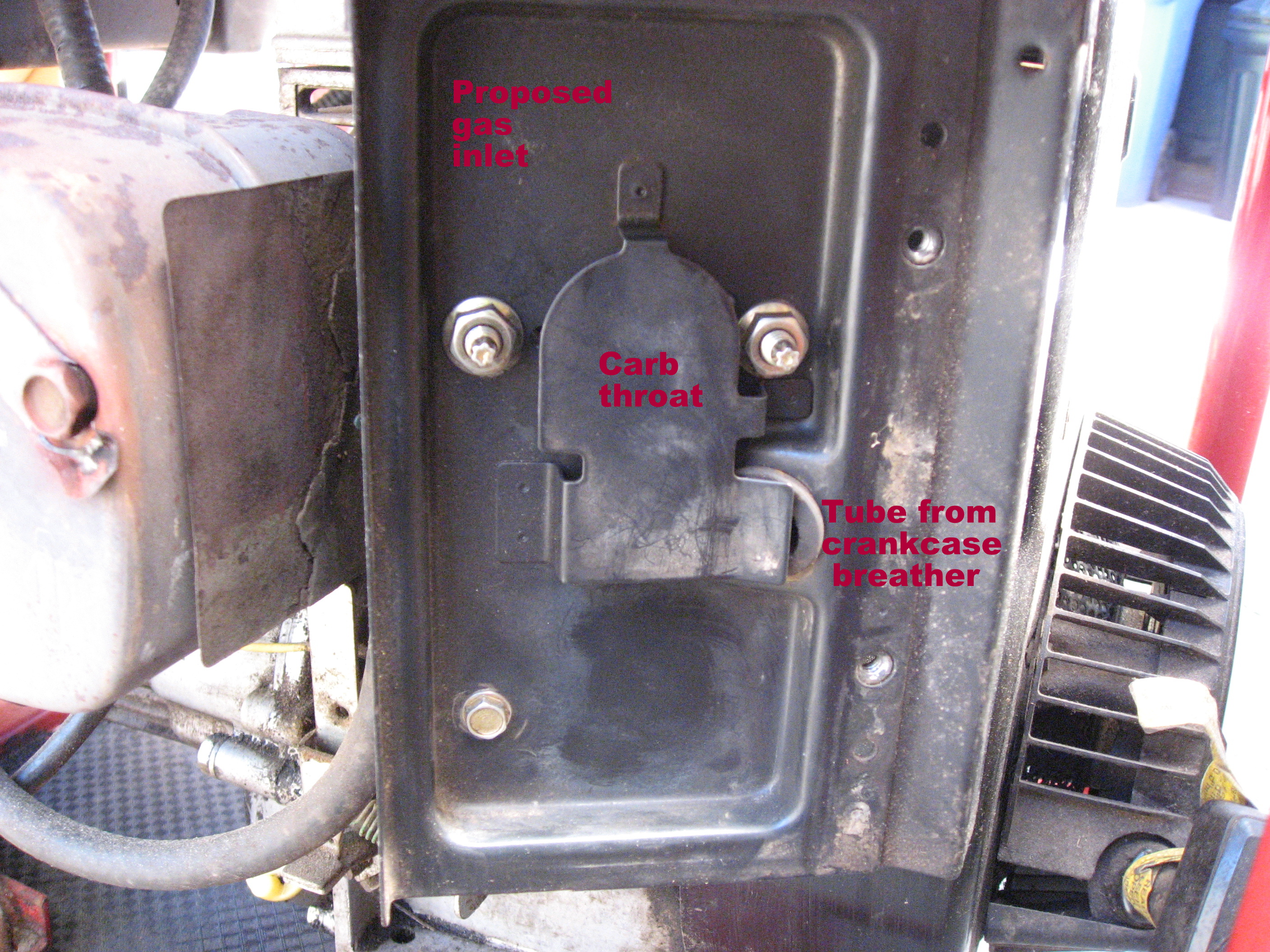

I have procured all the parts and fittings. I tapped the air cleaner housing with a 3/8" barb and made a metal hood / extension to the carb throat to maximize the vacuum at the natural gas inlet. Next step is to mount the natural gas regulator to the generator frame and install the quick disconnect on the gas meter. I made my own adjusting valve by screwing a 5/8"-18 (fine) bolt into a 3/8 NPT T fitting. It should give me a wide range of adjustment. The photos are of the modified air cleaner housing.

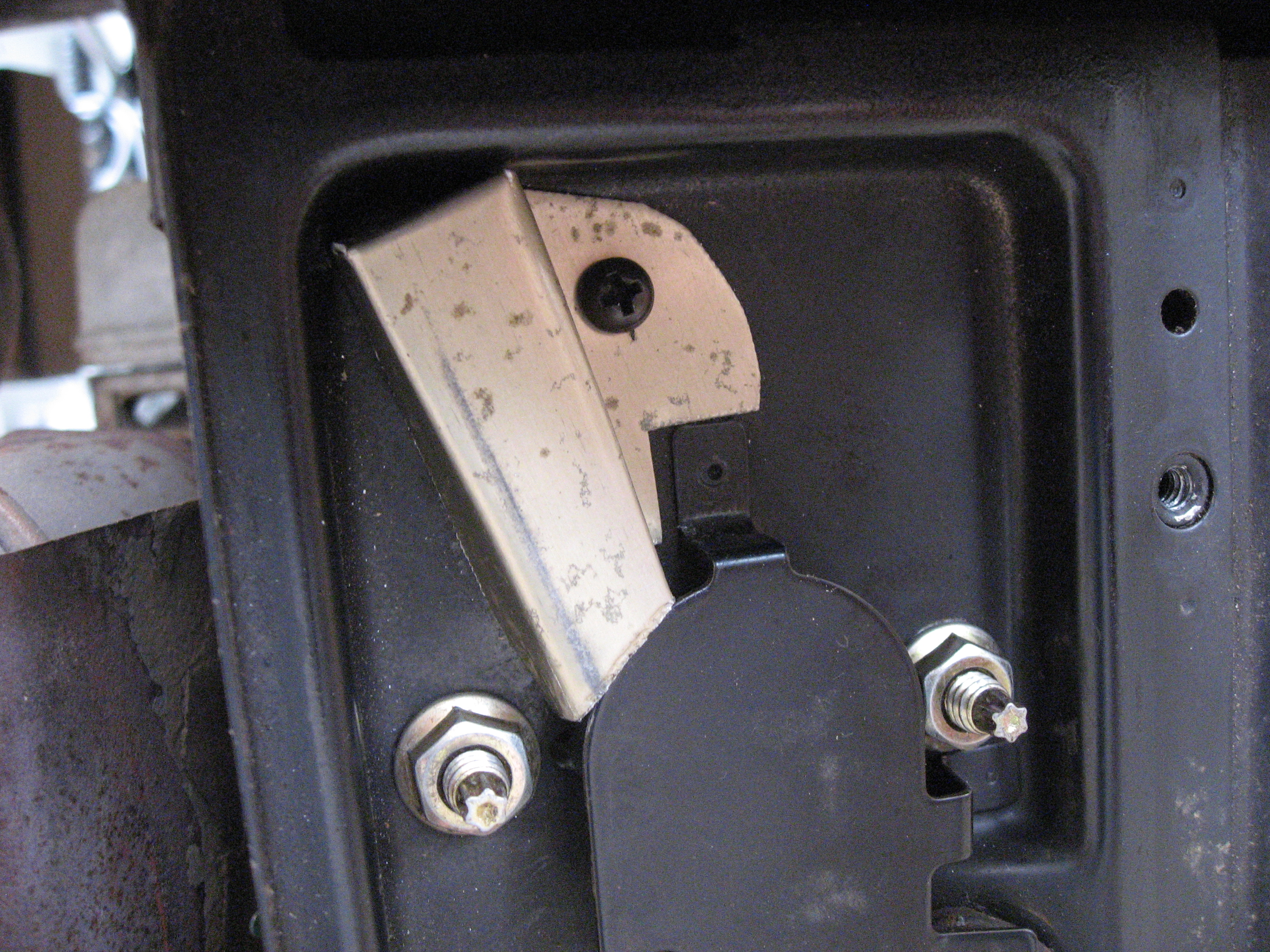

OP here. I finished this project and thought I'd post a few photos and comments for anyone interested now or in the future. I mounted the Garretson regulator to the generator frame and made an adjustment valve out of a 3/8" NPT Tee fitting and 5/8 fine (18 TPI) bolt. This allows you to fine tune the gas mixture. With this set up I could use low pressure natural gas or propane. I have added a quick disconnect to my gas meter that feeds a 12 foot hose to the generator.
My initial attempt to feed the gas into the throat of the carburetor did not work properly. I needed more cranking vacuum and vacuum variability so I drilled and tapped the side of the carburetor right at the venturi (narrowest) point. This gives enough cranking vacuum to open the regulator and allow gas to flow and also enough vacuum "signal" to allow the regulator to open more under loaded conditions. There is an additional adjustment on the regulator to dial in the gas feed under load.
The generator still works as before on gasoline as I did not damage the carburetor when I drilled it (watch for the low speed jet passages). I've seen a number of YouTube videos where engines are converted, but they don't show them operating under load. The key to doing it right, IMHO, is to load the engine down and adjust both the regulator and the mixture valve to ensure it has the right mixture under no load and high load conditions.

Follow up. I recently replaced my breaker box and added a generator interlock so I can plug the generator right into the whole house. We had a power outage and I hooked up the natural gas line, plugged in the generator and we were off to the races. Ran my well pump and everything in the house except AC and range. The regulator does adjust automatically depending on the load on the generator. It is really nice not to have to worry about stale or insufficient gasoline.
