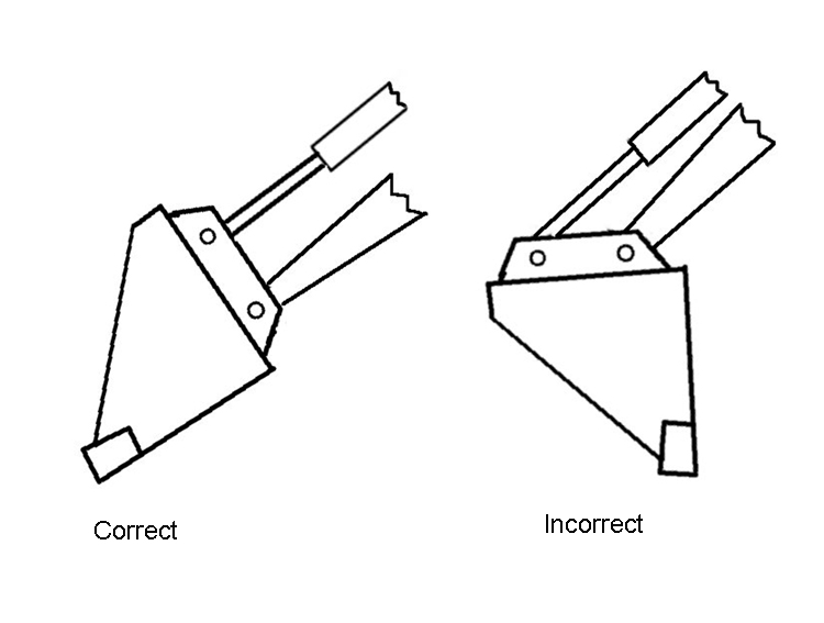

thatguy said:
Im a little confused.. Can someone post pics of what not to do AND the proper way??
sorry to be so dense..
Brian
Here is a very simple picture of the right way and the wrong way.

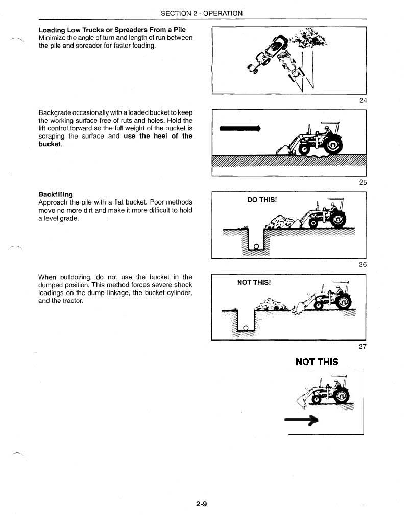

MadDogDriver--Those are the EXACT same diagrams that are in my Kubota loader manual. They must be universal technique instructions and warnings. . .except for Deere of course.:D
The correct way (jerry's diagram) makes for a smoother fill anyway....

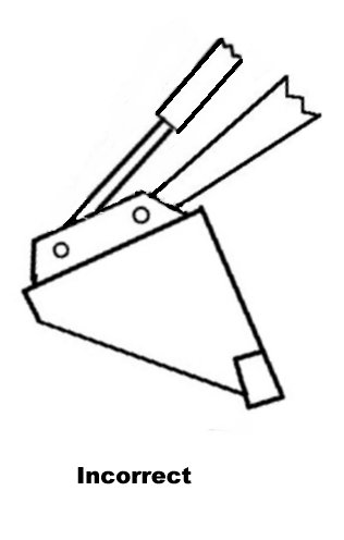

Hey guys ease up, I'm sure DayDreamer just meant that perhaps the heavy duty (300cx as opposed to 300) loader was built strong enough to do this.
In any case it's very good to know that I shouldn't be doing that. But I'm going to post a photo of the way I *was* doing it, because it looks to me like it puts way less stress on the cylinders than your guy's "WRONG WAY" diagrams. Namely, I roll it *fully* upside down so that there isn't that kind of leverage against the cylinders. The force from just looking at it is on the joint pins, not the cylinders, because the angle is to small to give the bucket edge much leverage on the cylinders.
I'm *not* saying I'm going to keep doing this, only that the pictures you guys are showing don't show what I was doing, and they look a *lot* worse (to me) than what I was doing. Anyway I'm grading out my RC car track so I'll take some pictures and show you what I mean, just for the record.
Nathan

Was it like this?
Nathan
If you are dragging through something that is "cuttable" you are correct that the torque producing force applied to the bucket edge is at a very steep angle. However, a catch on a rock or root will reduce that applied angle to near perpendicular (max torque) and apply an explosive force to the cylinders which are now fully extended and most vulnerable to buckling. Don't do it.

OK, I dusted off the operator's manual for the 300cx and found this. This seems consistent with what other brands are advising. It seems JD encourages using FLOAT which may have saved me from serious damage. Good forum for newbie’s like me. Thanks for everyone’s input.
I don't bleed green but I have a dream that someday all hydraulic cylinders will get along...
