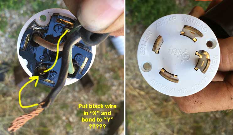

Resurrecting this thread because I have to run a 3wire 240v compressor off my Generator. I can buy all the plugs etc and make ay-dapters, but that stuff is hours away. I wanna use what I have on hand.... which is put this 4-wire plug on a 3 wires cord, plug it in, and compress air ----->Now.
473745d1467756295-need-220vac-electrical-help-change-bond-xy-jpg
SO....... Green wire is in G, White wire is in W.
I suppose to bond it within the plug - I simply choose X or Y for the black, and jumper across from X to Y? It can't be any other way, but just wanna check first. Sometimes just a little delay is best.
   / Need 220vAC electrical help - change 4 prong outlet to 3-prong #59
No. Don't bond. Omit. You've got to have red/black opposite of each other. Looks like you have the red hot in the neutral position. Red and black should be next to green. Neutral would not be used for a 240V compressor. If you were running to 120V circuits then you'd need neutral I suppose, but not if the compressor is 240.
#60
No. Don't bond. Omit. You've got to have red/black opposite of each other. Looks like you have the red hot in the neutral position. Red and black should be next to green. Neutral would not be used.
OK thanks. The wire colors are White Black Green. The "white" wire is faded (to look like red in the pic).
SO.... What you are saying is ---- black and white (the two hot legs) must be across/opposite each other? If thats the case then GWXY does not help me. What if you look at the prong end of the plug? What is the prong with the "hook"? If that is either neutral or ground, then across is the "other" cross pair. So my hots go on the OTHER two prongs. Is this right?
