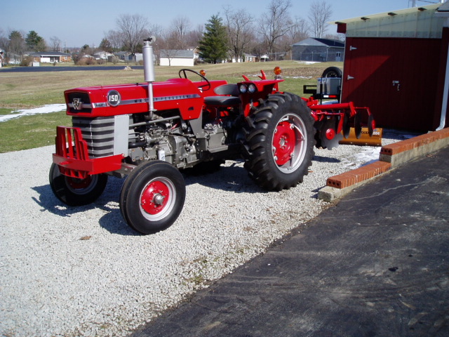

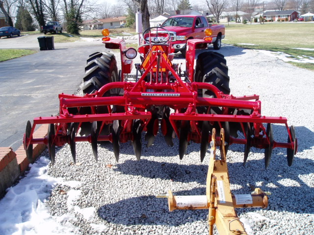

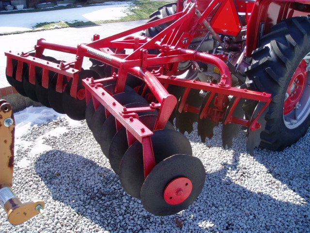

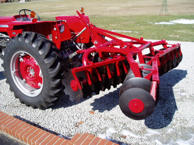

drz400 said:
The disc is a MF 25 tandem. It does have adjusting levers for the front and back gangs.Maybe I need to adjust so they are even. Thanks
The #25 MF disc is one of the best 3-point mounted disc's there ever was as far as leaving a nice level seedbed, IF set properly. You DON'T want it set full tilt aggressive, especially so once you have the ground loosened up a bit. Front gangs should be either one OR two notches from full cut, and the rear gangs one position LESS than the front. If you set the disc down while on a hard surface (driveway?) the front gangs should touch first, with the rear about half an inch off the deck.
As far as USING the disc, try your best to make successive passes at angles to previous ones. Go north/south, then swap to east/west. Repeatedly going over at the same angle will cause ridging with even the very best disc. The heavy drag behind the disc is also a good idea. I've always used a section of railroad rail. Anything H.E.A.V.Y. and straight will do the trick.

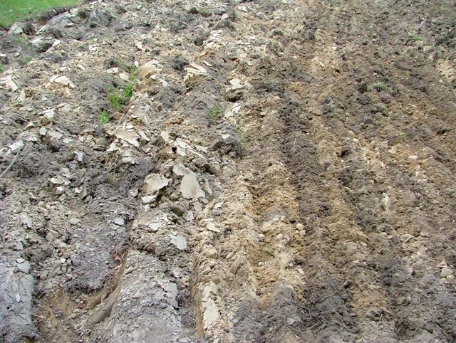

Here is a picture of my first time plowing and discing. There was a week from plowing before I disced.
   / Need a disc lesson #15
SS, if it rained between your plowing and discing, you did a great job. I've started plowing before, got rained out and gone back to disk and it took forever to bust the clods up and get it smooth. Farmwith listed a huge mistake I was making too, my harrows have cutting disk on the front and smoothing disc on the rear, I learned to set the smoothing disc a less aggressive than my cutting disk, that helps a lot, just keep on keeping on with the harrows and that soil will look like suger before long

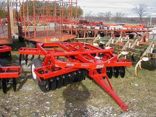

FWJ here are the two that my local dealer have that I down to choosing between...:rolleyes:
$2975 for the 10 FT MF 520 or $3000 for the 8FT White 252...
Care to throw your TWO CENTS in?
   / Need a disc lesson #17
@ approx. $3000 each, $.02 won't help you much...;)
I've always preferred International Harvester wheel disc's, but that's not the question is it? Between the pair, I like the LOOKS of the White. Any idea what sort of weight we're talking about (with either)
MF had a good rep with a few disc models, but sort of a neutral rep over-all. White, clear back to the Oliver days, has a sterling rep on tillage equipment. With AGCO owning BOTH nowdays, there may be little difference between the pair.
