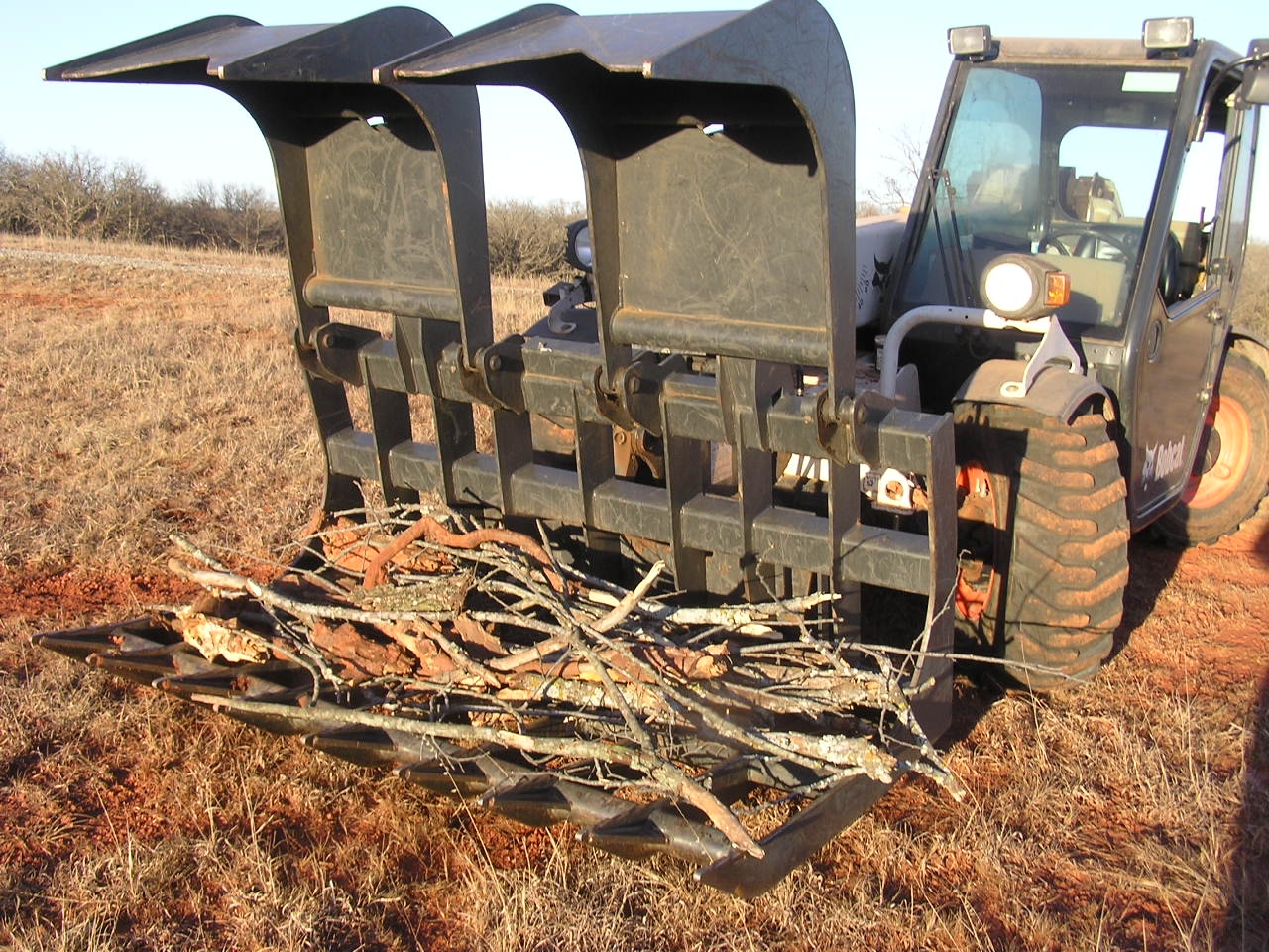

While I love the thing and it makes log/brush handling a breeze, I sometimes wish it had a longer bottom 'shelf'. That way I could physically stack some scattered things in there

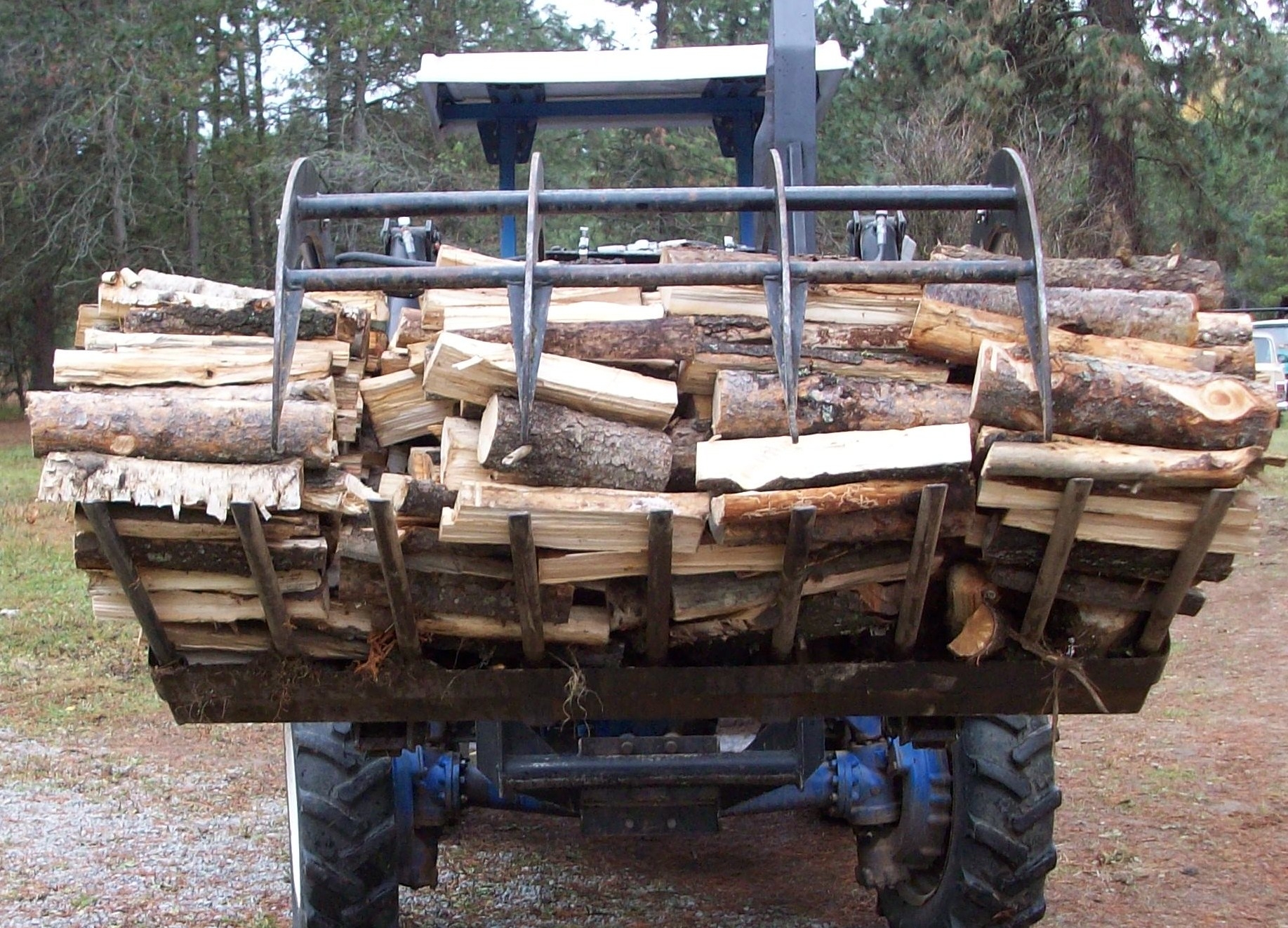

Yep, the "shelf" is very handy, picked these up by hand and threw them on the grapple:
   / Need a grapple for my tractor... help me spend some money. :) #62
Xfaxman - excellent picture. That pic shows just one of the advantages of a grapple with long lower tines or a "shelf".

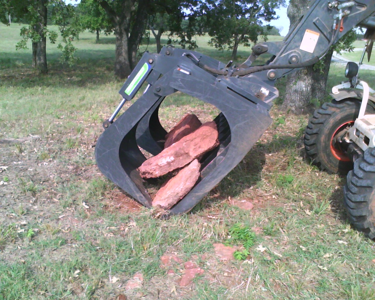

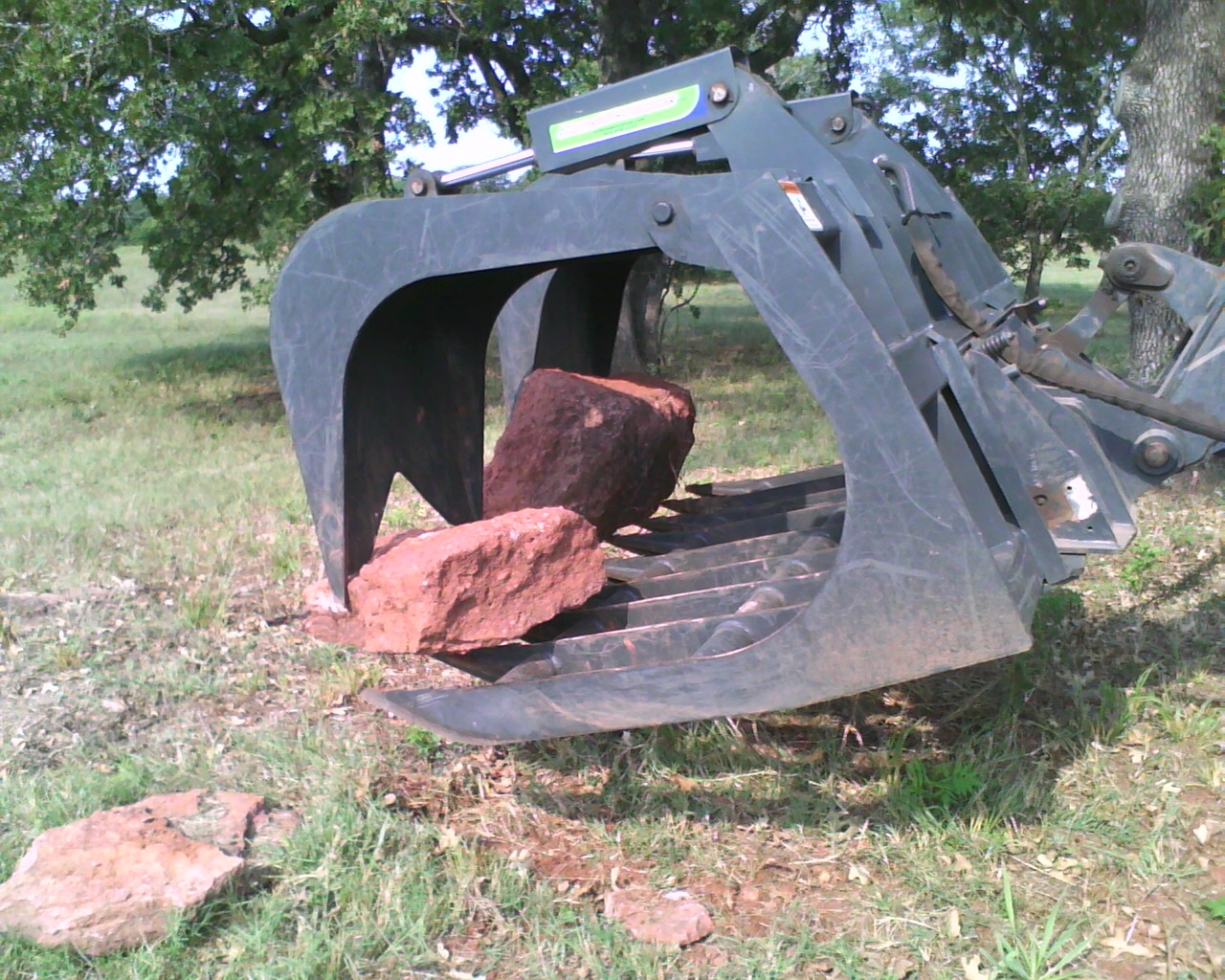

On my rock/root grapple - I have to tip the grapple back to get anything like a shelf. The grapple with a shelf can scrape forward along the ground and collect sticks/limbs/brush, etc. Mine will push it all forward and - hopefully - contain it when I lower the top lid.
My rock/root grapple will be stronger when dealing with large rocks, root wads and tree trunks. Stronger meaning - less likely to bend or crumple.
Again - know what you plan to do with the grapple and choose accordingly.
That is probably why many have more than one type of grapple.
That is why I choose a rock/root grapple. I have essentially no brush and only very limited limbs. My major needs encompass moving large rocks and chunks of pine tree trunk.

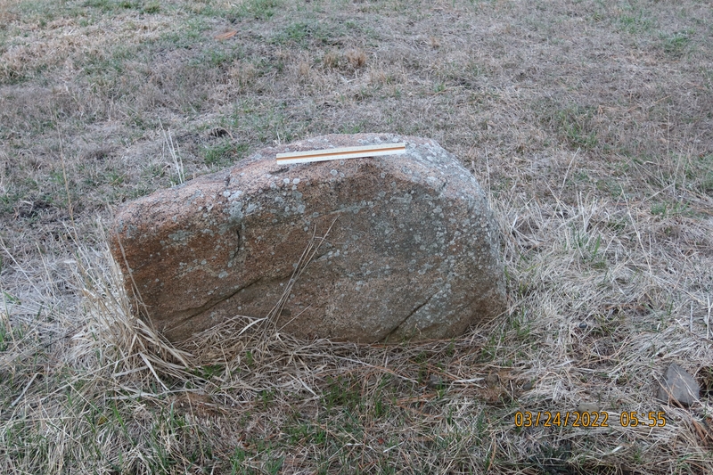

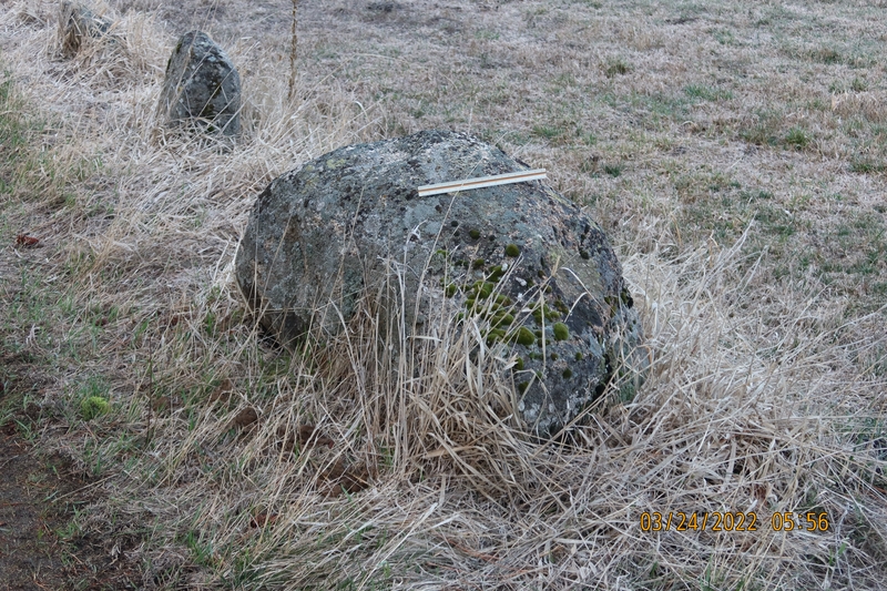

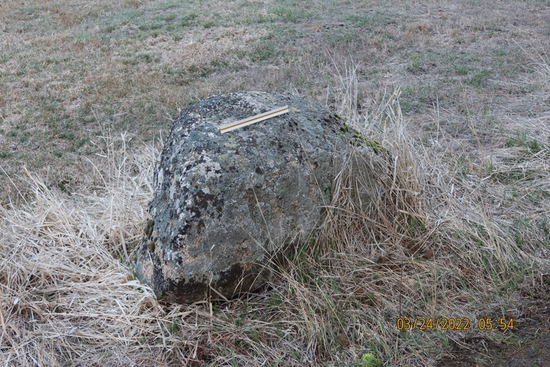

Some of the larger rocks I've moved with the tractor & grapple. They are solid basaltic granite and line the inner portion of my driveway. Meaning - they keep folks from "accidentally" driving on my drain field.

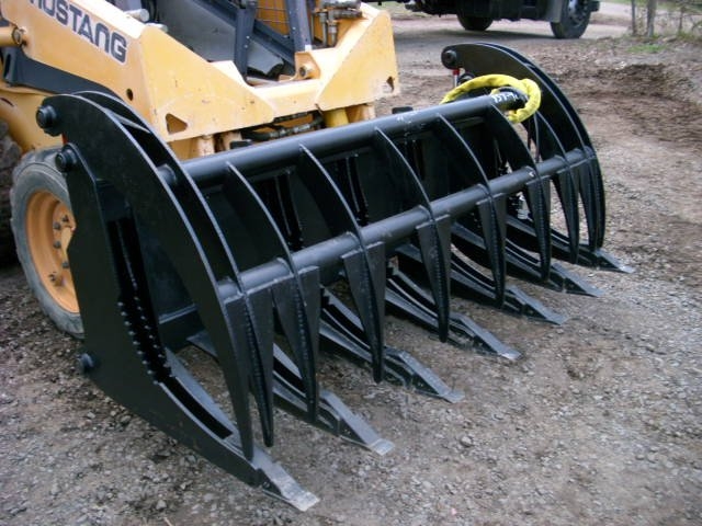

How about this one ?
Wildkat 84”. Made in USA. AR36 Steel. Weighs 900lbs. Opens 46”.
