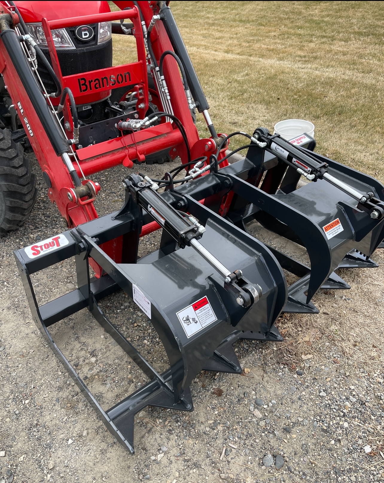

Bought a Stout Buckets grapple for my 48HP Branson. Really like the grapple, and it’s held up well with a fair amount of use. Got the Stout Skid Steer Brush Grapple 66-9 With Skid Steer Quick Attach. USA made.

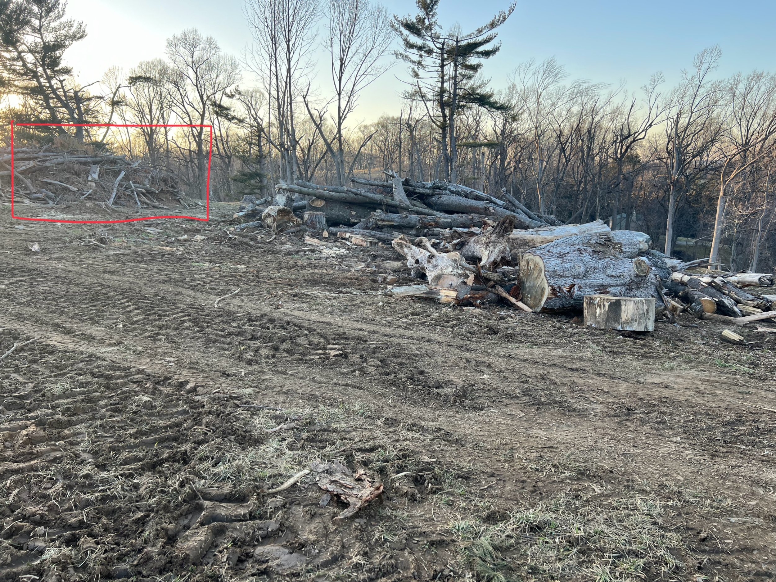

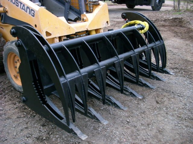

The “root rake style” grapple looks ideal for driving into an pushing large brush piles. Can’t understand the nickname “root grapple”, though??
Already have a log grapple.
Need something that I can drive into a tall & deep pile of brush, close grapple, and come away with lots of brush.
See the brush in the red box? I have 10 piles bigger than that.
The problem with the root rake grapple and brush is your radiator and grill are a lot closer to the pile of brush and it's harder for you to see when you are making grabs. Ask me how I know!
I've switched to the long bottom style grapple and feel it is superior to the root rake style for moving brush, rocks and logs. Easier to see my grabs and keeps the skewers away from my grill.
