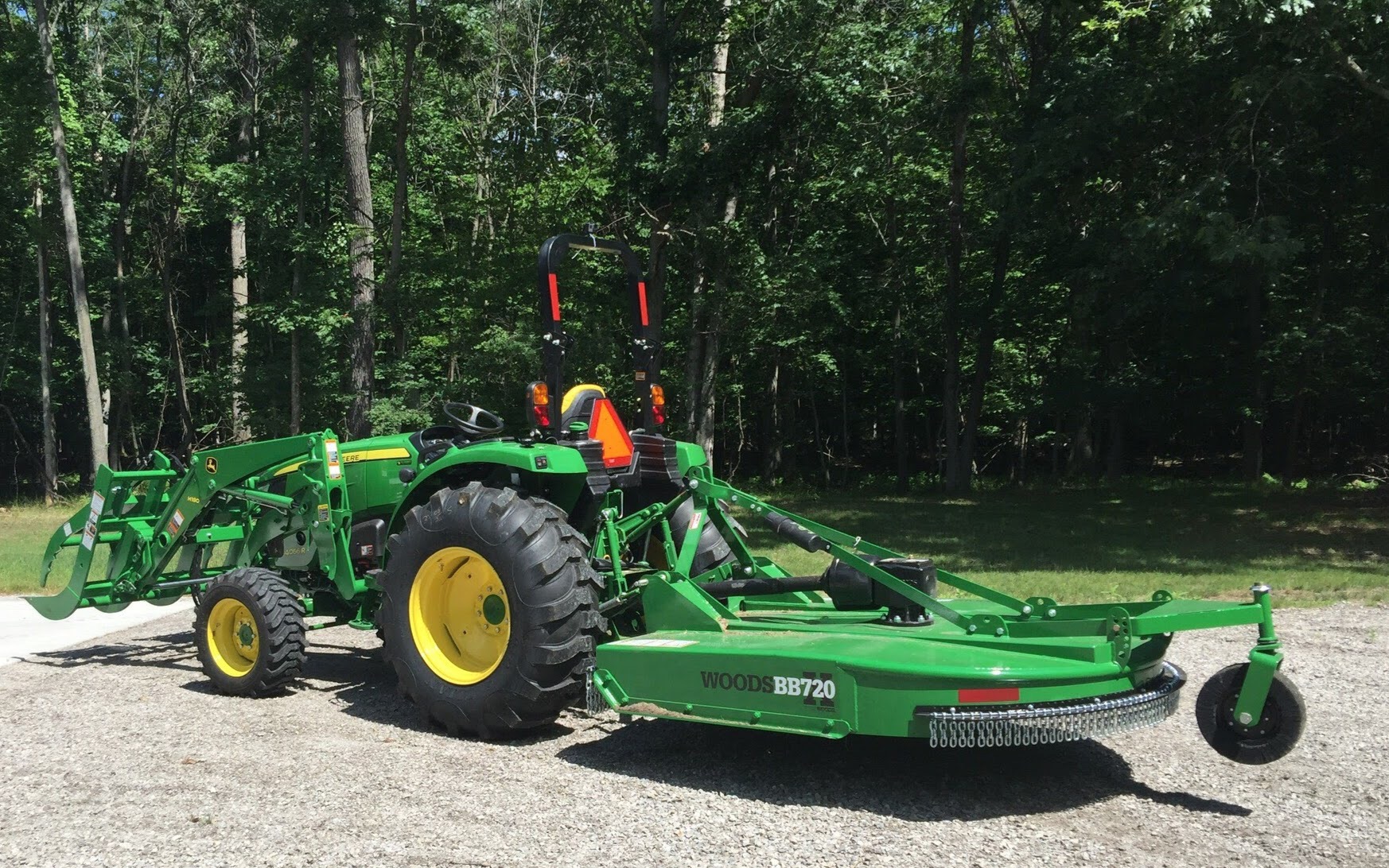

I've got a Wood's BB720x. It's a beast. Very well built. My previous was a John Deere MX-5...also a nice mower, but much lighter construction than the Woods. Highly recommend.
