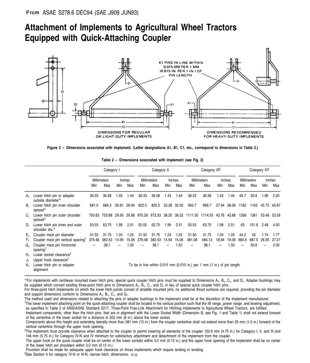

For those still mulling over quick hitch, here is supposedly industry standard... Some manufacturers have not found it yet... If you buy QH and it does not fit you implement, modify implement, it will always fit your rig then.... Do it once, cry once, life gets better after that....

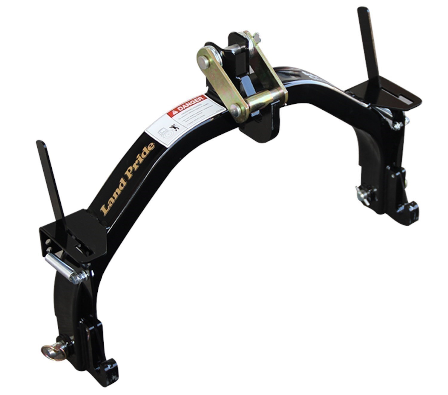

The Harbor Freight quick-hitch is on clearance right now for $99. Is this the right one?
3-Point Quick Hitch for Tractors - 27-3/16" Clearance
The Northern Tool
https://www.northerntool.com/shop/tools/product_200660668_200660668
Agri-Supply
Quick Hitch-3-Point Quick Hitch
and Harbor Freight
All three seem very similar in price/function. Any important differences you see?
The upper hitch vertical adjustment seems to be the most limited on the Northern Tool unit. This would be important when using it on older or non standard implements. I can not tell on any of these lower end units about quality of the linkage or metals used. The Agri Supply unit looks the best on first blush to me. Or maybe they are all the same, given the quality of pictures it is hard to tell.
Dale
Affirm on that. Make your implements fit your hitch, and then do it again 'cuz you welded something in the wrong place. That's my method! But when it's done, you can swap out your counterweight or box blade or sub-soiler or stump grinder in just a few minutes.
   / Need a quality quick hitch #55
I've had 2 or all 3 of those... no significant differences, other than possibly the number of holes for the top hook. All of the 5 cheap QHs I've had needed a longer top hook. As fast as I know all QHes are still in use & functional. 1 was welded to a SSQA plate to mount a plow, it & another ran off with the old L3200. 1 went to a friend. 1 is on my L4060. Another was recently purchased used from another TBN member (who doesnt like QHes as he found out) & is sitting around spare waiting on a use (likely getting welded to a SSQA plate again).

The Agri Supply QH comes with the top hook that sticks out a little further. They also carry a mower adapter for $12.99.
Not sure if this is the shaft extender I bought but it says it extends the shaft 4-3/8" which is just right for adding a quick hitch. They don't show a picture of it. The one I bought is quick release like an air coupler that you pull back on a collar, push the splines on, and let the collar go to secure it on the PTO spline of the tractor.
I bought my finish mower after the fact and do not use the extender with it but my brush cutter already had the shaft cut a little short. I can also use the AS adapter on my finish mower top connection while on my brush cutter I use a short piece of chain and just stick one pin through one of the hook bolt holes.
