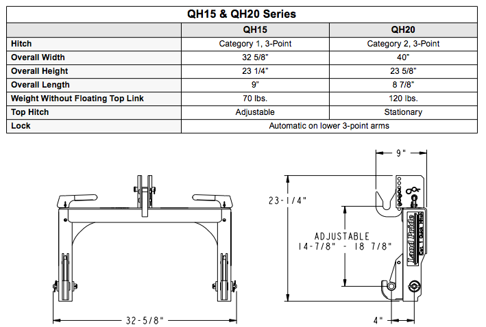

I spent a lot more on my Quick Hitch from Land Pride. I had given thought to the Habor Freight unit till I watched a few you tubes. Nearly every one they said you had to modify or buy extra things to hook to all your equipment. The last one was one all bent out of wack when the fellow got stuck in the mud with a tool on the quick hitch.
The Land pride QH 15 hooked up nicely to my L3301 Kubota. Came with bushiungs for the small size lift pins also. back up to my back blade and hooked the bottom pins. Removed the 2 pins from the top hook sliped it thru the back blade top pin and reinstalled those 2 pins with the hair pins.

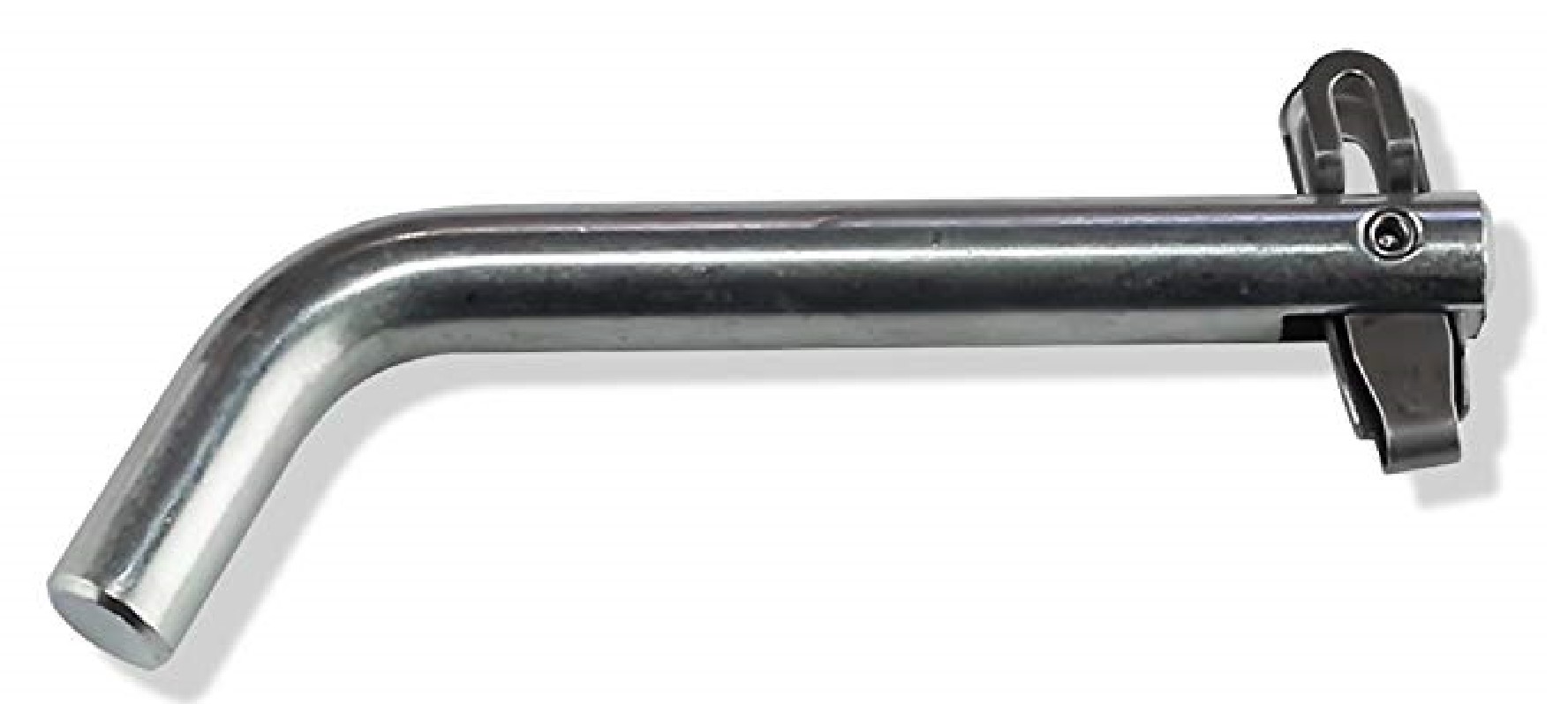

Best thing I see to do with a HF QH is to remove the bolts holding rhe top hook in place and buy removable pins that fit in their place.Al
I had to drill out the holes slightly since the HF bolts are metric but I bought 2 of these 1/2" trailer receiver pins. Paid about $6 each but they work great and it's just a pin, no extra clips.
