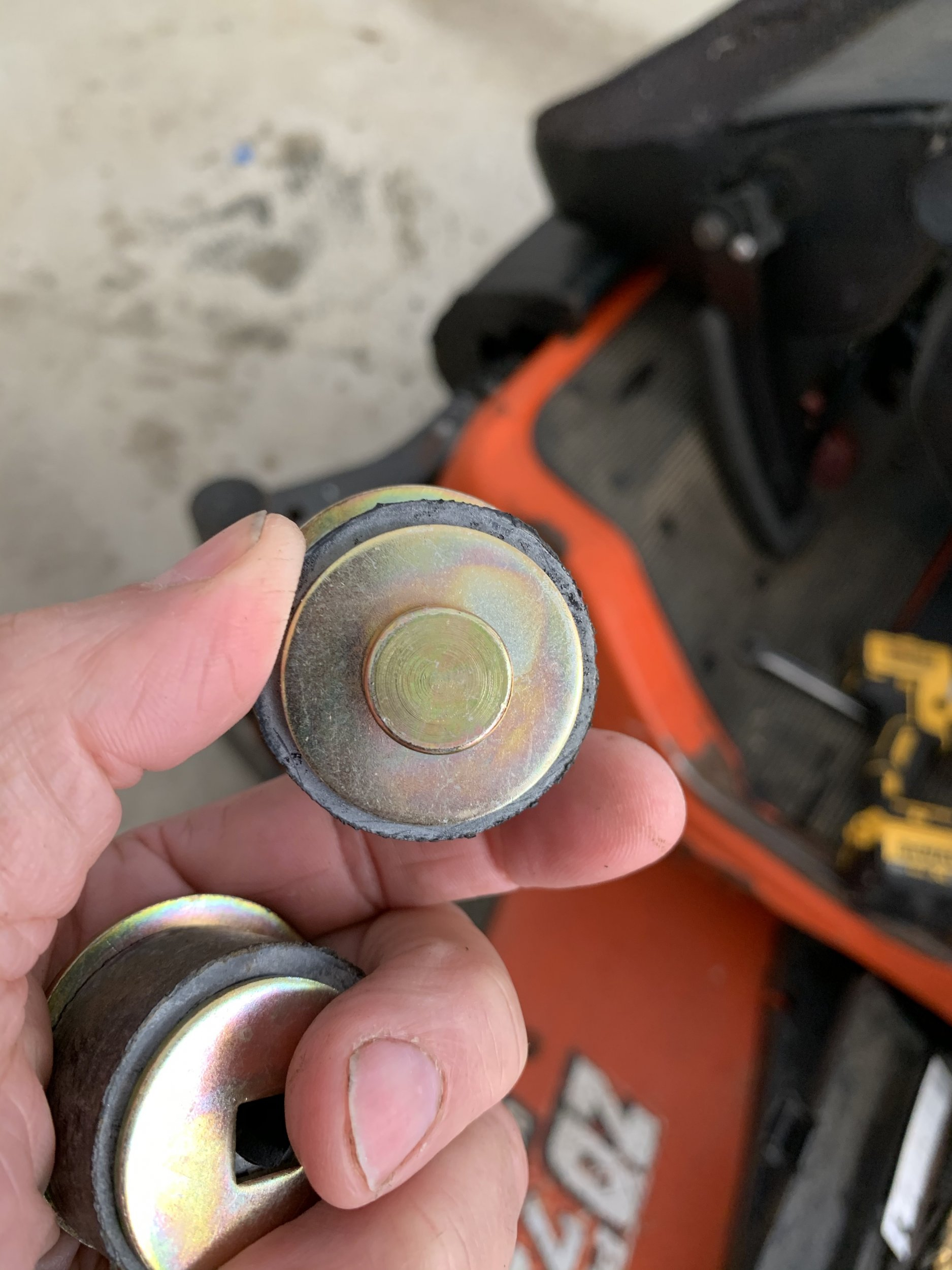

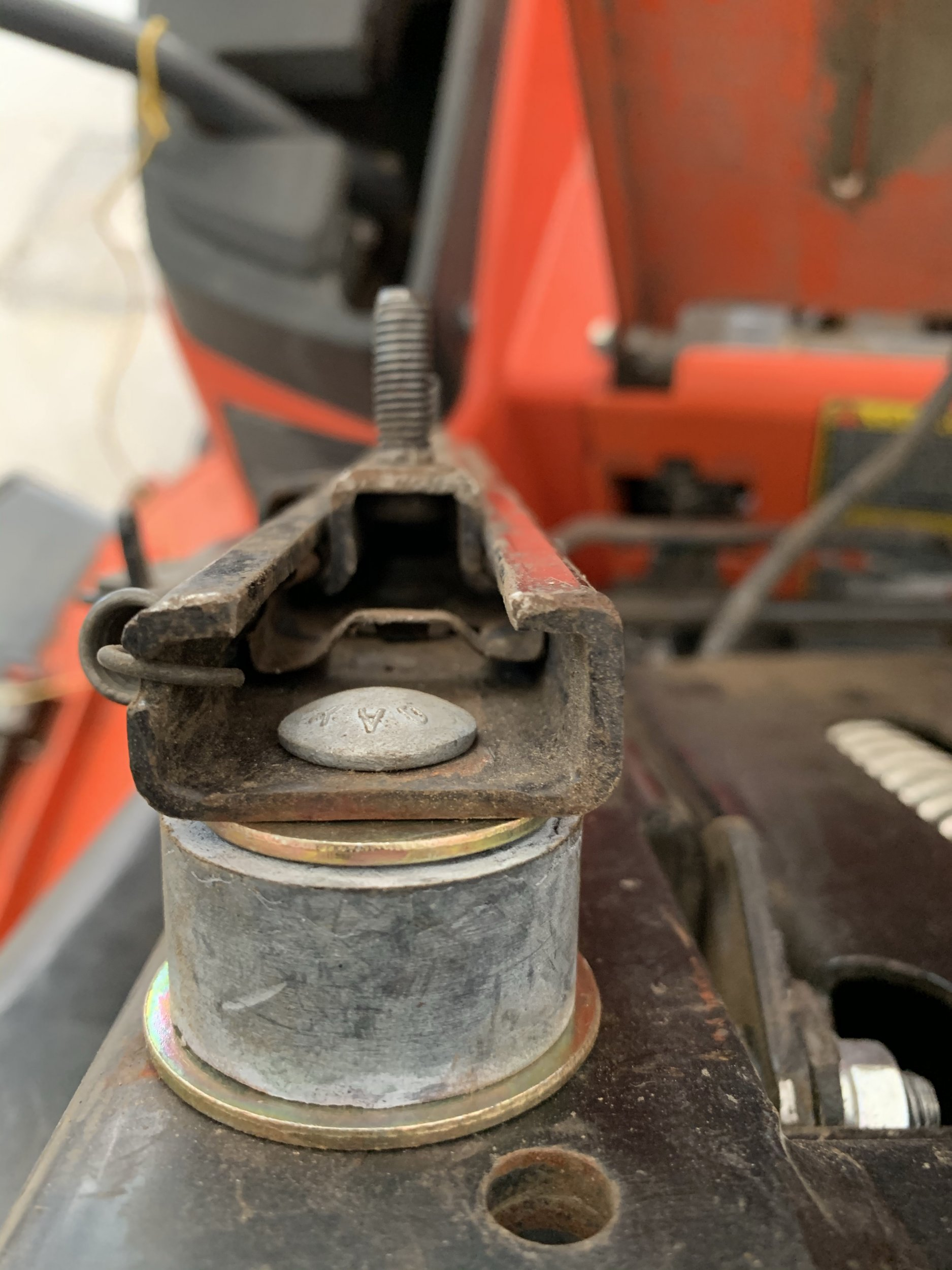

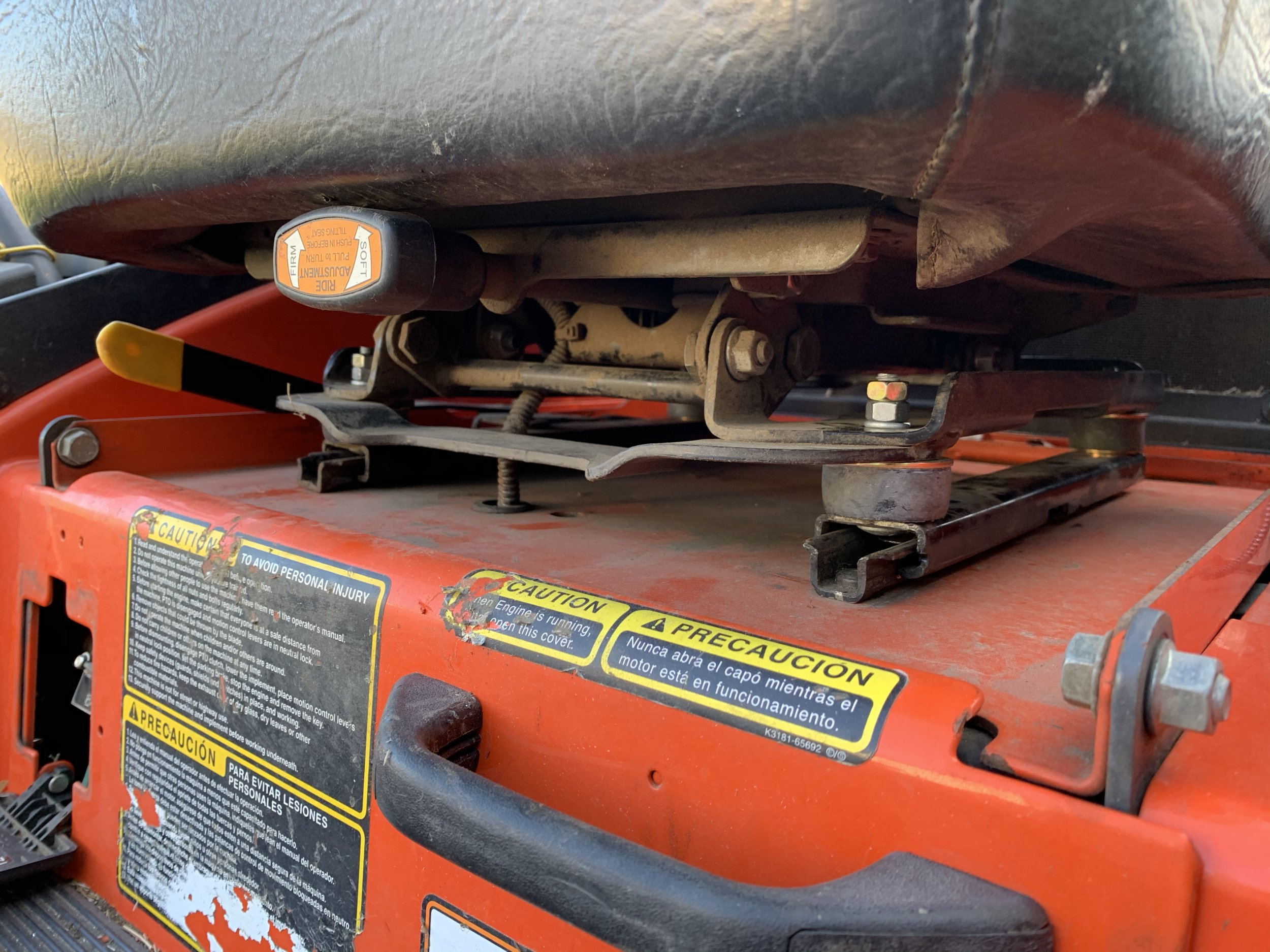

Might not be enough, but have you ever replaced your seat frame bolts with these? I have lower back pain from battles at work and injuries. I’m pretty big, so the seat suspensions usually bottom out on me.
I put them under my seat in place of the rigid steel on steel mounts and it took a lot of the “shock” to my back away.
Here’s what it looks like done. Cost me about $50 in hardware and a couple hours total start to finish.
Only downside I see from it is you sit an inch higher, but as shot as my seat probably is, it’s not the same height as a new seat.
Been running this way for 2-3 years and I like it a lot. (y)

I like this. I have used old dual coil tappet springs in a similar manner for suspension (not seats) in the past.
