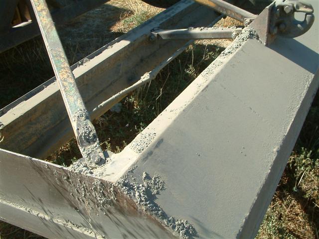

I made this from my scrap pile. I used two old grader blades. I shape the road a couple of times a year with my back blade to get/keep the crown the way I want it, then I use this drag about once a month to keep the road smooth.
The drag goes a lot faster than back blading it, and keeps the road nice. One thing I would do over if I was to rebuild is to make it about a foot wider and much heavier.
brucewj: The drag you built is almost exactly what I envision for my needs. Where I will make a change is at the front blade. I will flip it end for end and weld it to the bottom of the sides so that the cutting edge will shave the high points but not dig aggressively. Other than the sides being heavier channel than yours, mine will be almost a copy. Also, instead of using a top link I plan to have a length of chain there. That way the drag will be self balancing while in use.
