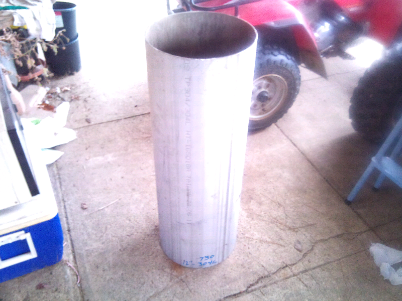

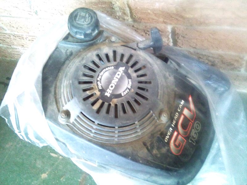

Finally, after years of looking, and slinging a 8 lb maul splitting wood, i am finally getting ready to start my build. I work at a fabrication shop, so material and things of the sort is not a problem. As long as its scrap I can get what I need. I searched the net and found some free cad drawings for a wood splitter. I changed a few things up, but am staying pretty simple. All i beed is a splitter. I have all my steel gathered, all the fittings for the hydro tank and hydro lines. I got a honda gcv 5.5 off a pressure washer that the pump blew up and was practually brand new. The beam for the splitter is a w6x25, should work nicely. The tank is actually going to be a piece of stainless pipe, 12" sch 10. Should hold about 20 gallons of hydro fluid do if i ever change out the 11 gpm pump, i can. Cylinder is a 4"x24"x1.75. Set at 2900 psi I should get close to 19 tons of force. I am waiting til right after xmas to order the hydraulic parts (northern usually has a after xmas discount promo) so we will see. More pics to follow.
   / Woodsplitter build #1
#2
Photos

Photos of motor and w6x25
