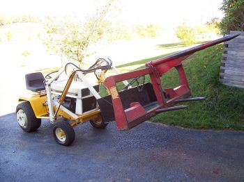

I'm running 1/4 inch hoses on my loader. Works great. I've lifted as 400 lbs. with mine so far. The tractor is definetly the limiting factor here, not the hydraulics. with that much weight the front tires were punished but didn't pop. As soon as I figure out how to add pics here I'll put 'em up. My tractor and loader sound just like what your attempting. You'll love yours too!!

Here's my first shot at posting a pic. Fingers crossed.
   / Need Advice for Homemade FEL #18
Alright! That worked. Here's another pic after the wheel weights were added. The hay spear was brought to me by a local farmer to be repaired. The Cub loader made it easy to move around.

wrencher, you are welcome and thanks for the photos!! That tractor is so cool... I had to do a double take on the bale spear!?!?!
