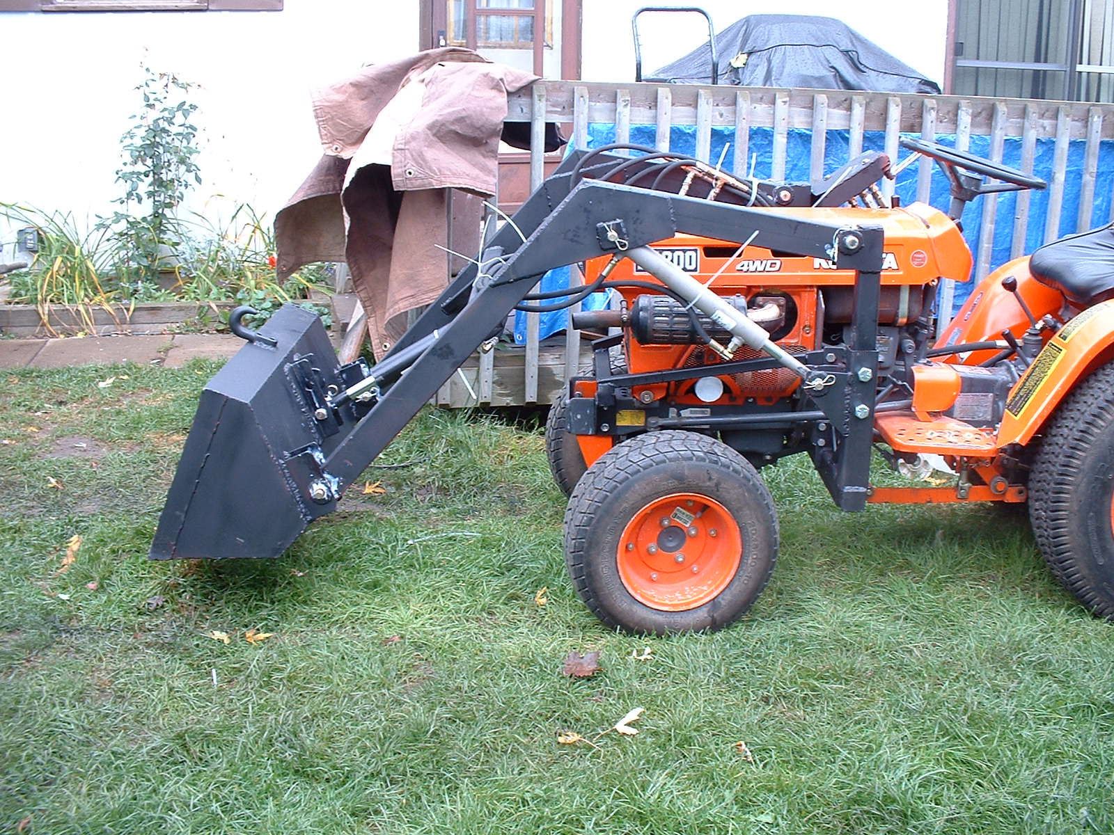

Alright! That worked. Here's another pic after the wheel weights were added. The hay spear was brought to me by a local farmer to be repaired. The Cub loader made it easy to move around.

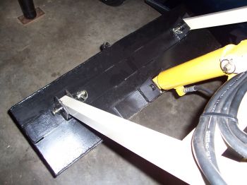

Thanks for the pics. Most of the small homemade loaders I have seen use two cylinders for the bucket. I like your design because it reduces costs by only have one bucket cylinder. Did you have to reinforce the bucket where the cylinder connects since it is in the center? Also what is the thickness of the metal you used for the bucket? If you could post some close up pictures of the bucket and cylinder that would be awesome. Thanks
   / Need Advice for Homemade FEL #22
Thanks for the compliments on my loader. Sure was fun to build and is really fun to use. I like the single dump cylinder because I'm cheap and the plumbing was easier. I went with a 2.5 inch bore here to keep the speed about the same as the lift. Another advantage of the single is weight savings. The lighter you can build a loader the easier it will be on your tractor. The bucket is .100 thick sheet. It sounds thin but it's actually sturdy, and seems perfect for this application. It's 40"w x 16"deep x 12" tall. The mounting is very simple. welded 1/4 thick x 3" wide brackets on the back. I also added a small plate to the top with a hook.
The frame of the loader is made from 1.5" x 3" x .125"wall tubing. The arms are 1.5" x 2" x.125" tubing.
If you have any more questions, feel free to ask.

Wrencher has a very nice simple design with a definite plus in that the cylinder is pushing (most power) when it is curling rather than dumping like most. The disadvantage is the exposed cylinder rod so close to where the action is taking place, which puts it at risk for damage. For example, back dragging to smooth things up or anything falling over the top of the bucket onto the exposed rod in full curl.
Mike

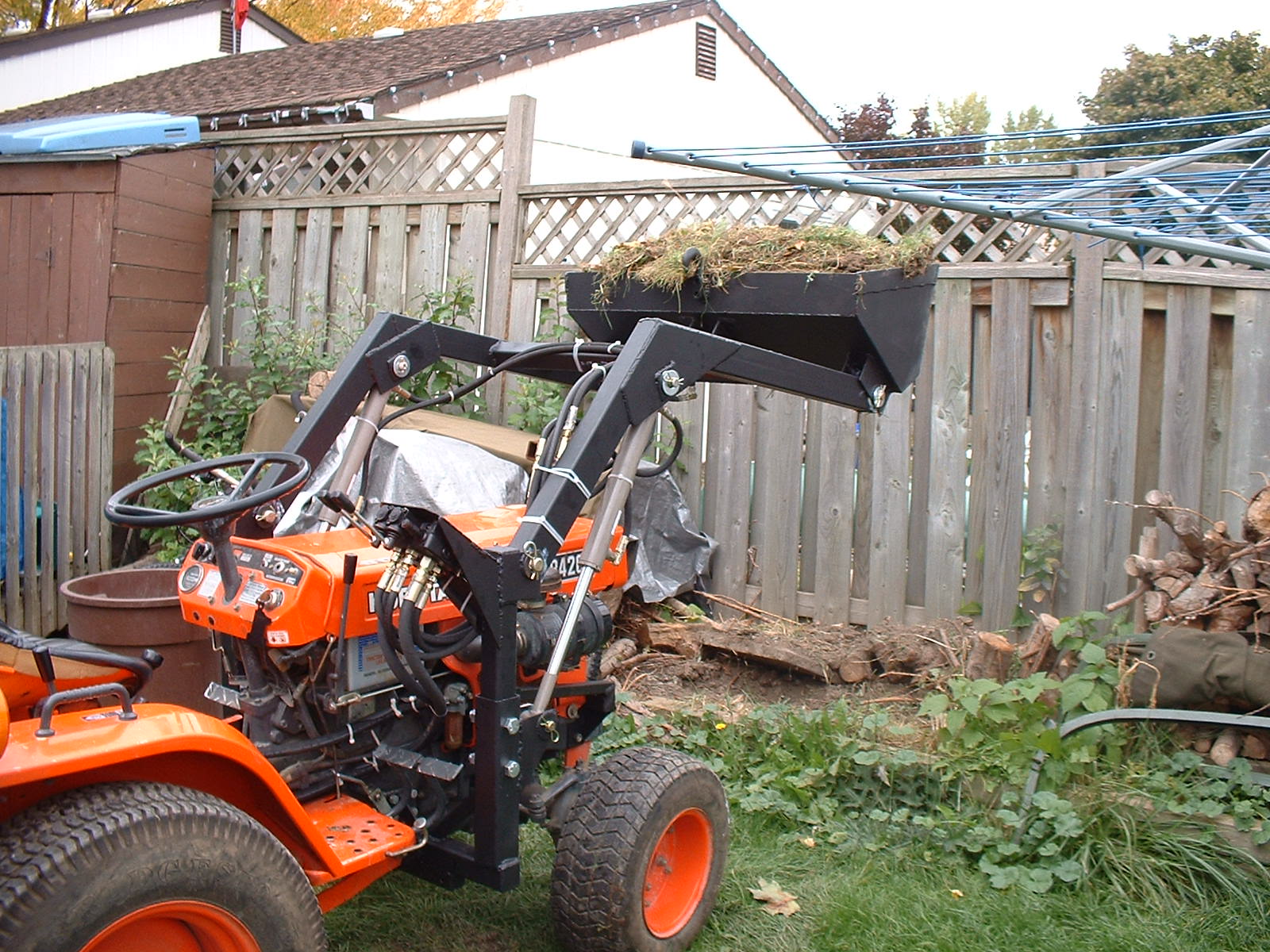

My little 12 HP Kubota has about a 4gpm pump and I use 1.5 inch loader arm cylinders and a 2 " single bucket cylinder. I made a 36" bucket and can fill it with sand and it lifts with ease and good speed. Its a little weak on breakout strength but has enough to lift a rear wheel a bit so don't really need any more power. Major issue is steering as I have no power steering. A rear counter weight in the 150 lb range will greatly help on the steering.
Counter weight needs to be on the 3PH as wheel weights won't help with the steering. Only improvements I had to make was to strengthen the cross piece the bucket cylinder attaches to and beef up my original subframe. I have used this unit for 5 years or more with no issues about damage to the bucket cylinder.

However, your attach point on the bucket is above the bucket pin pivot point--that means that your cylinder is contracting when curling and extending when dumping--which is opposite of Wrencher's--his attach point for the bucket is BELOW the pivot point on the arm and therefore, his cylinder will extend to curl and contract to dump. My thinking is that is good for power--cylinder has more power extending than contracting--but it leaves the rod fully exposed with a loaded bucket or back dragging to smooth things up. That is all that I am saying.
I like the idea of a single cylinder, for a variety of reasons, and there are some very interesting designs out there.
Mike
