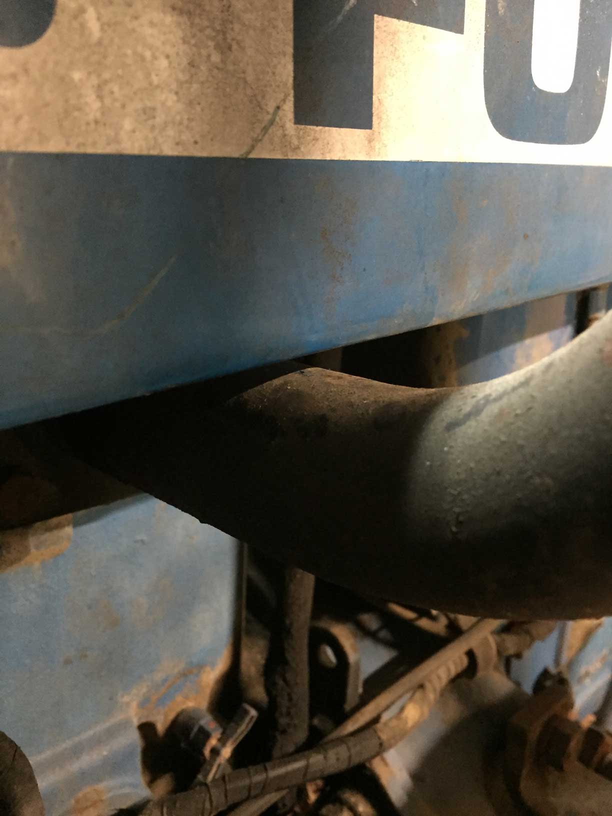

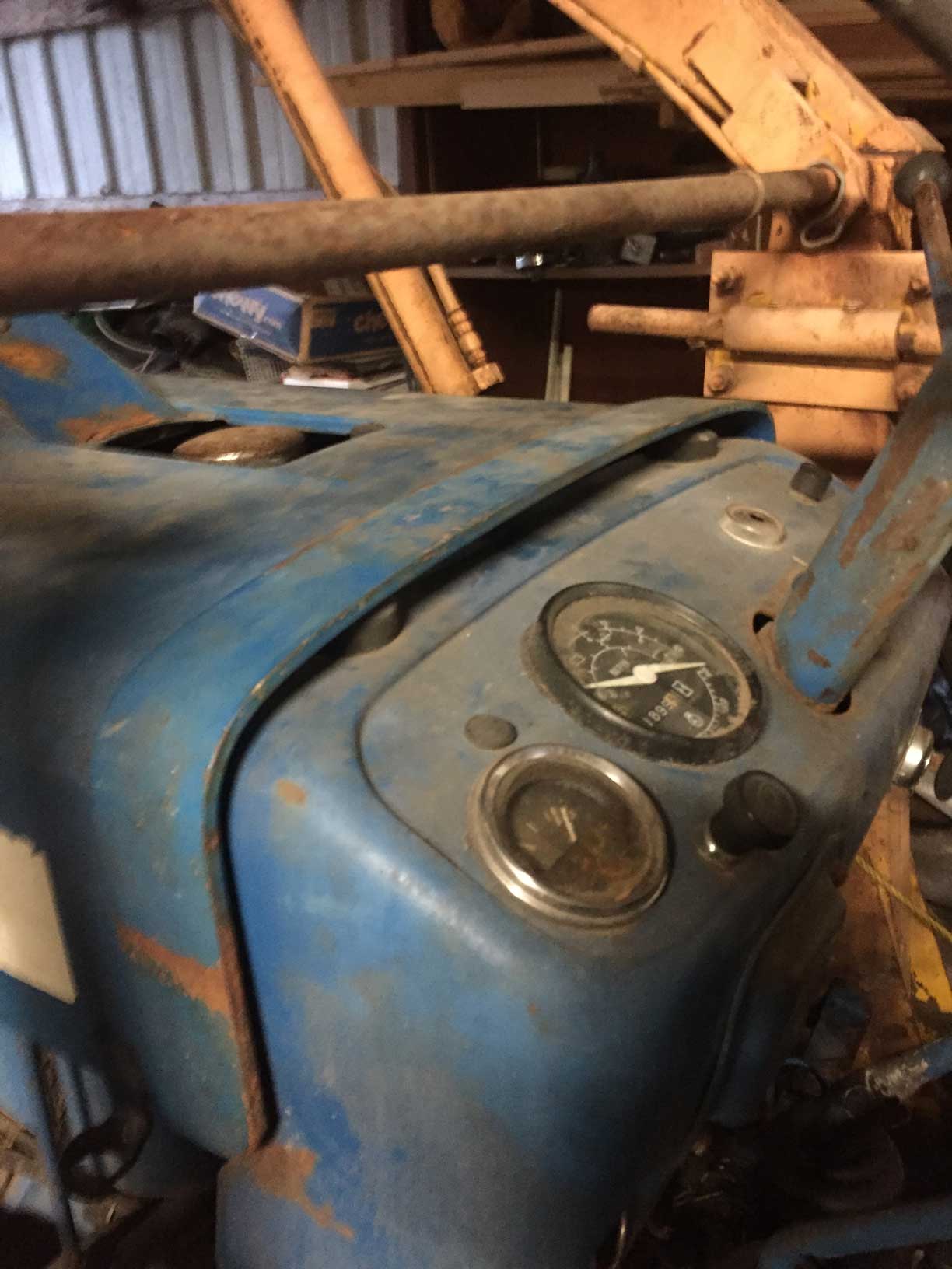

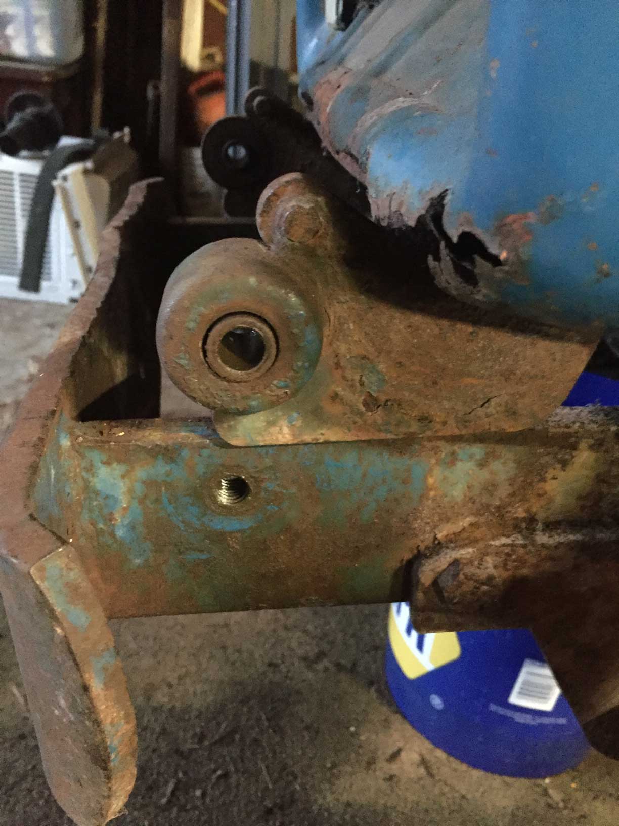

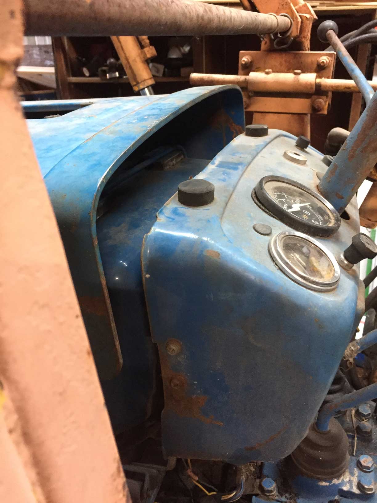

I've banged the hood and here's the issue. The hood/hinges aren't adding up. If the bolts are taken out of the hinges and I fit the hood in the proper position, my hinges are off by about 2". The hood is also sitting on the muffler.
If I attach the hinges my hood is off by about 2" and is sitting on the Air Filter.
HOOD-OUT-OF-ALIGNMENT.jpgHINGES-ATTACHED.jpgHINGE-AREA-BENT.jpgAIR-FILTER-NOT-ALIGN.jpg
So my question is this - Does this look like the area above the hinges has been bent in some way? Maybe it's been bent inward toward the engine?
Thanks

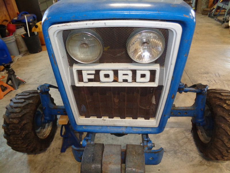

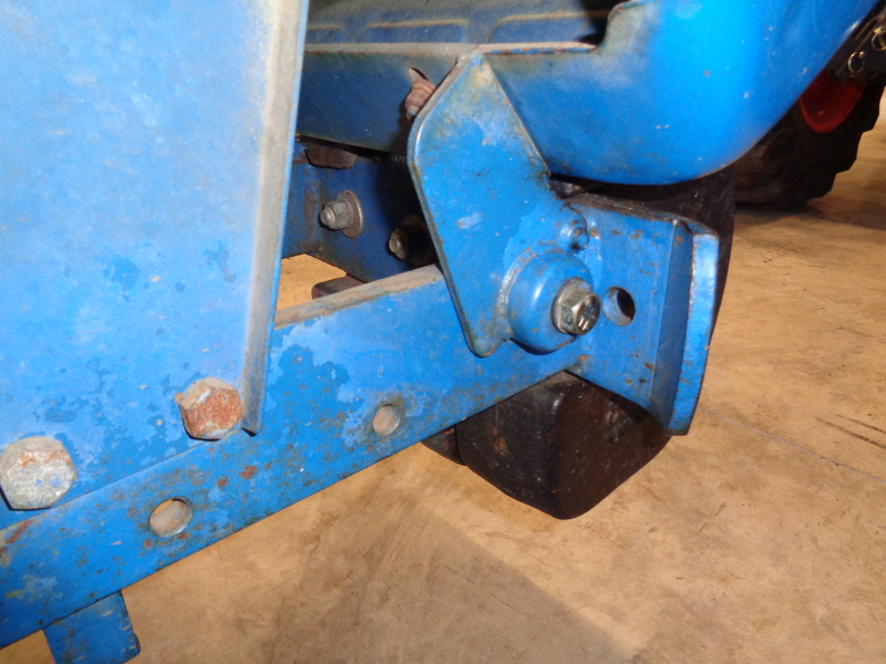

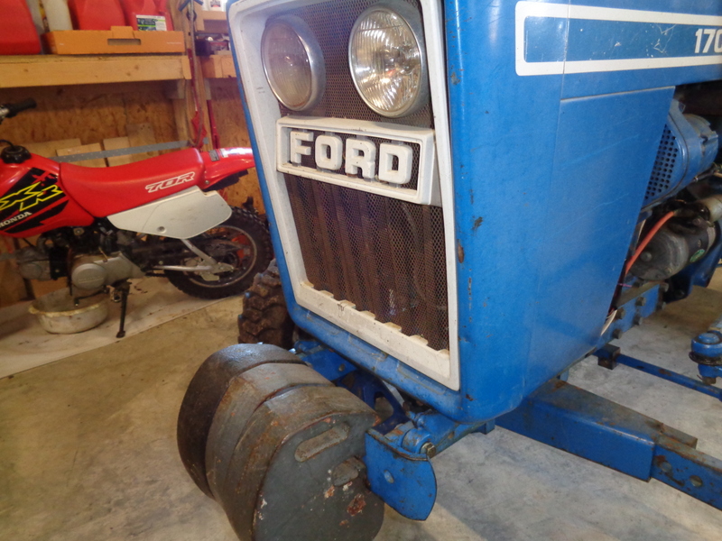

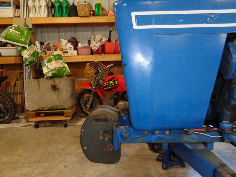

Ok. for the sake of dimensional reference I went to the barn and took several pictures that show your where things need to be by eyeballing it. Compare and contrast to what you have and beat the hood to submission to make all fit as best as you can. There is no wiggle room with air filter it is solid where it is. that should be your reference. Look at the holes on top of the hood for diesel fill, radiator cap and the exhaust top piece. The hinge on the hood is pretty beefy so I think sheet metal will distort before the hinge does. There are 4 bolt that attache the hinge to hood and you have about 3/4" forward or backward movement to line up with the aforementioned holes discussed. I hope the pics will help you to get it 1/2 way there at least.

DSC06095.JPGDSC06106.JPGDSC06102.JPGDSC06101.JPGDSC06100.JPGDSC06099.JPGDSC06098.JPGDSC06097.JPGDSC06096.JPGDSC06109.JPG

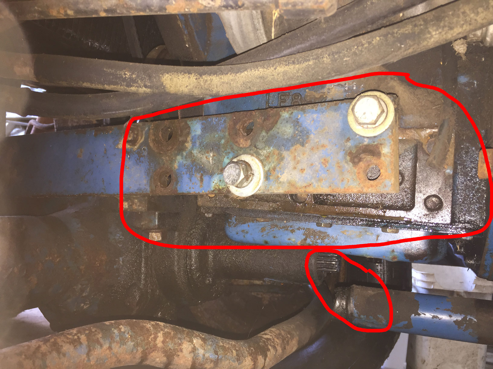

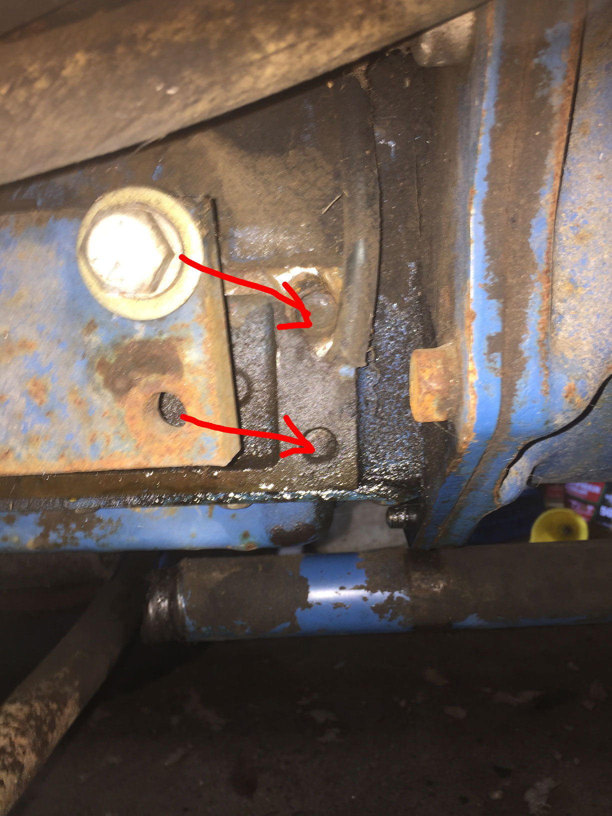

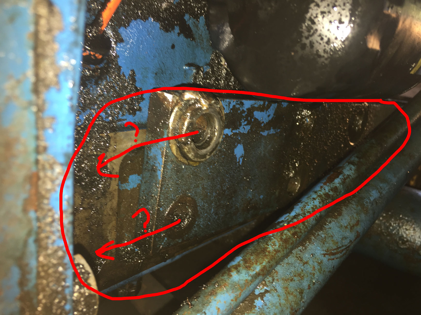

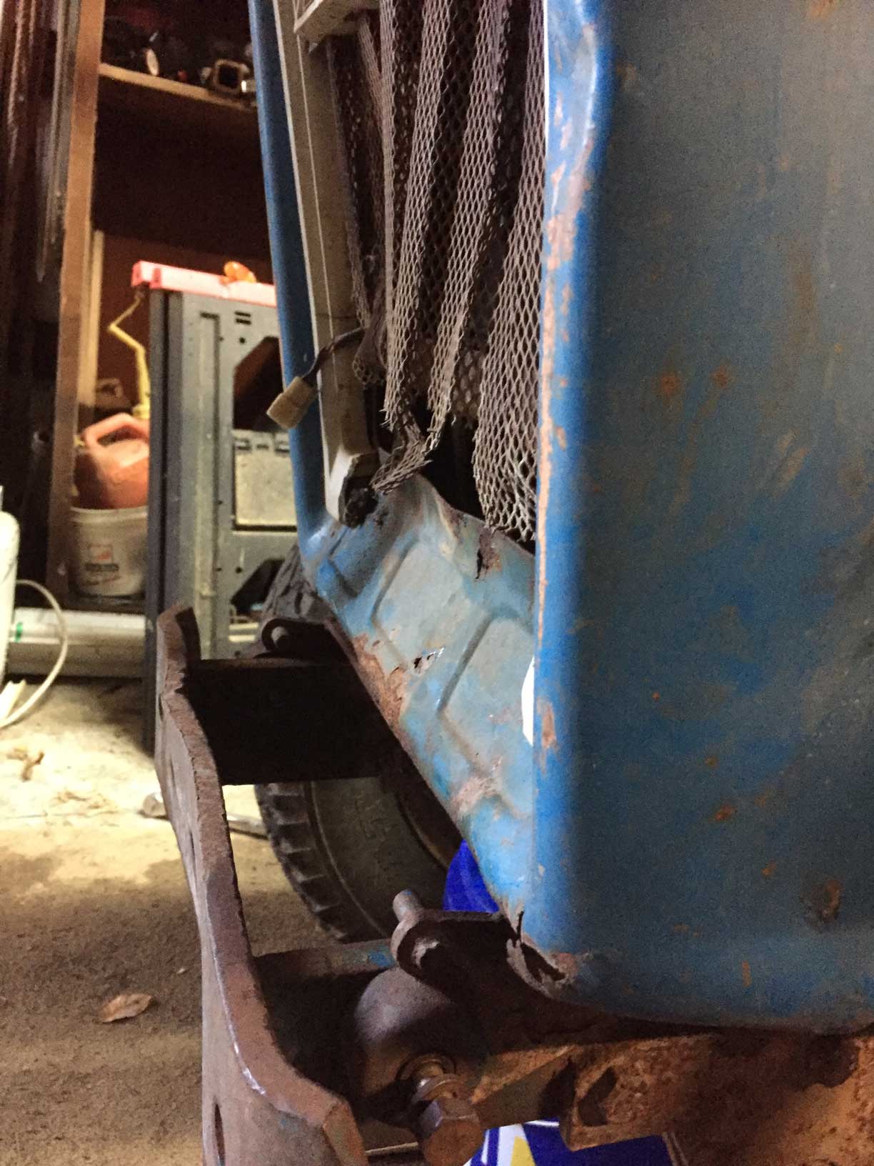

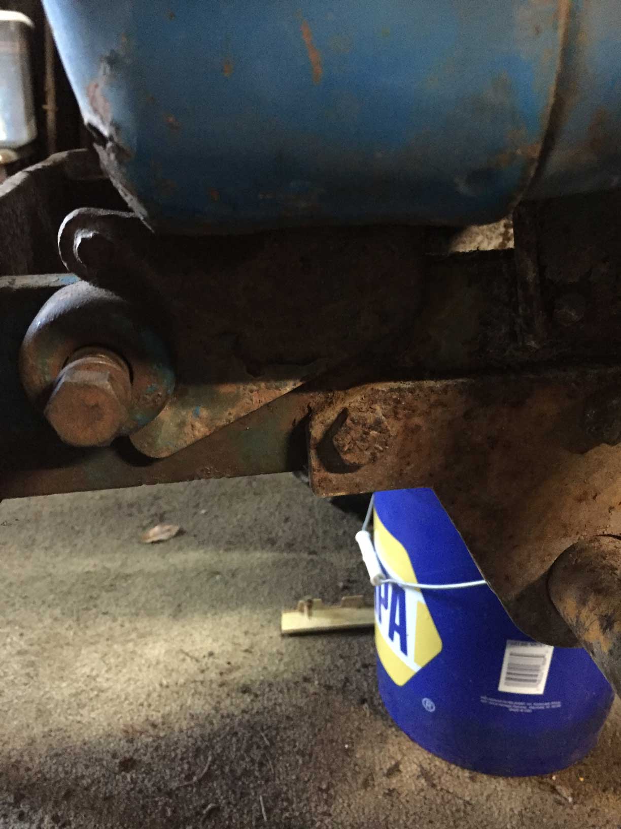

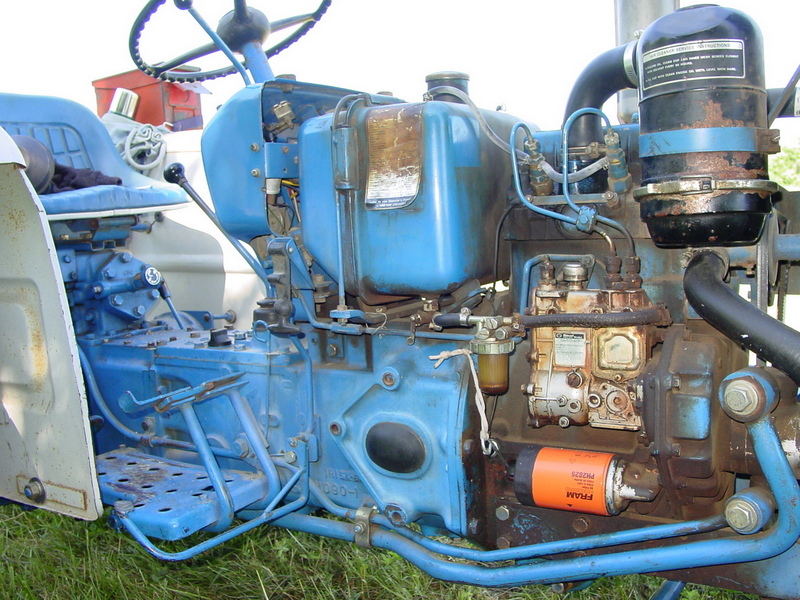

HOOD ISSUE SOLVED.... well sorta
First off, Thank you JC-Jetro and the many others that have given outstanding advice on the hood not fitting and how to get it back on straight. My next step was to actually have a piece built between the hinge and the hood to lift it. BUT mysteriously when I started the tractor to move some gravel, the hood fit perfectly! Took the tractor out and long story short, when I lifted gravel into the front loader, something went horribly wrong. The rubber lockdowns on the hood came off and I noticed the air intake was bent forward. I finally got the the top portion of the air intake off and BAM, the entire front end with the battery and radiator went forward on a pivot away from the engine. The radiator hoses came loose, spilling all of the radiator fluid on the ground. Oil filter damaged with all of the oil spilling on the ground. Wanting to get the tractor back in the shop, I started the motor, lowered the frontloader and BAM the battery and radiator came back towards the engine. I reattached radiator hoses, got an old oil filter on, filled what I could and backed the tractor into the the shop, dragging the front loader on the ground.
I'm missing almost all of the bolts that hold the front to the tractor as you'll see in the photos. I only know this because of the photos JC sent and I saw two and thought "uh oh, my tractor doesn't look like that". I have no idea when and how they came off.
First JC's tractor and photos
View attachment 684147View attachment 684146
Now my tractor/photos First two are on the left, second two on the right. And in the first one you'll notice the drivetrain detached from the front axle(We'll get to that. First things first).
I'm assuming the holes need to line up and the bolts need to be attached. I've also noticed the holes are different sizes.
While the above is the bad news, the good news should be that when these are all lined up and attached correctly, I believe my hood issues will be resolved.
Any advice as to where I can find the correct sizes of the bolts would be appreciated.

I wondered if your tractor was involved in a frontal to cause all the holes misalignment. Do I see it correctly that drive shaft for the front wheels is off and not meshing with differential input shaft gears? do you have the bolts sheared off flush with the engine block. if you want the mount the bar that connect to the front bumper and the engine block then you have to extract the portion of the bolt in the hole with an "easy out" after you drill a hole in what is left out of the bolt in the hole. It will not going to be easy. You can alternately weld inside of a nut to the busted bolt so you have something to grab a hold of the busted bolt. That is easier said that done though. it s really strange, did they drill and tap block for the new bolts?
