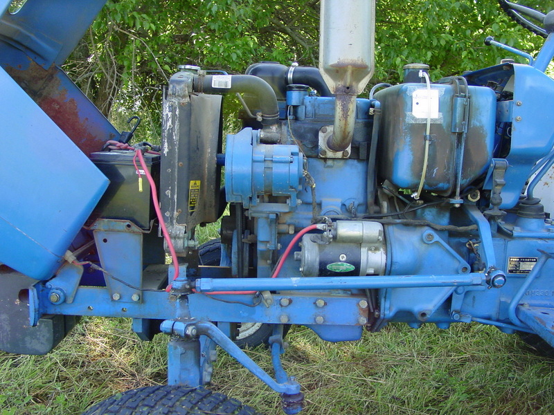

Out of curiosity I went ahead and looked closely at your pictures. What it shows is evidence of horrible treatment of the rig by previous owners. That is not at all normal. I am surprised the tractor is not broken in half at the bell housing. Never seen anything like it, no wonder nothing lines up. Just for a reference look at the pic below on a machine that is normal, not abused and is 42 years old. Look at the engine support mount that provide structure for the front wheel, radiator ,battery and hood. That is the left side of the tractor and right side is exactly the same. The only exception is I do not have FWA or loader. Your tractor was seriously abused by improper use of the loader, back drag and or frontal accident.

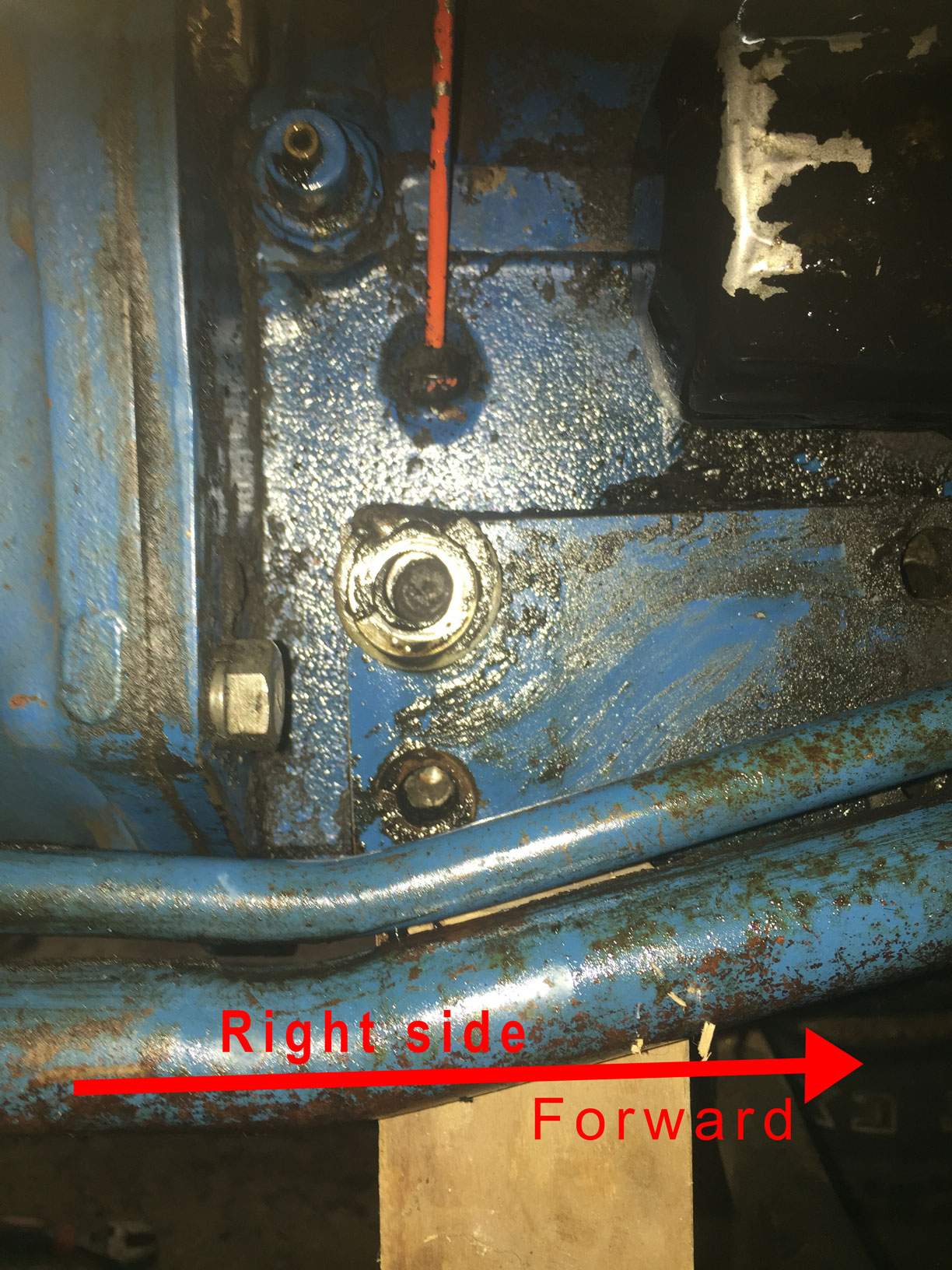

So the quick history is that my father-in-law took incredible care of his 1500sqft shop/tractors/etc. Approximately 7 years ago, he became unable to really work on his farm and passed away 5 years ago. In this time, and up until I got here in October, it's been havoc in the shop where the tractor is. I've been trying to get things back in order, especially to help out my mother-in-law who still lives here. After he passed, his shop was basically "raided" by what I would consider unethical family members until they deemed there was nothing left of value. The shop had become nothing more than a place for "storage", but more or less things placed, and not organized. Personally, my father taught me how to use tools and figure things out which is what I've been doing since October, but I'm a weekend warrior type with my full time home in Los Angeles.
So there's a 6-7 year gap as to the care of the tractor which I have no information about except for tidbits here and there. I haven't heard of anything about a frontal accident, but then again there is the damaged hood.
I can't imagine he would've taken the bolts off, nor can I see why anyone else would have, but then again, they're obviously missing. Only two on one side and NONE on the other. The one bolt that I took off has a 13/16" head on the bolt.
My next step is to clean the area thoroughly and try and figure out what's happening with the alignment of the holes. They are not stripped, nor are there any sheared bolts needing extraction. They're just missing. I'm assuming those bolts should all be the same size which the holes are different sizes. Could mean that at some point someone did retool the holes or some of them.
Thanks again, JC

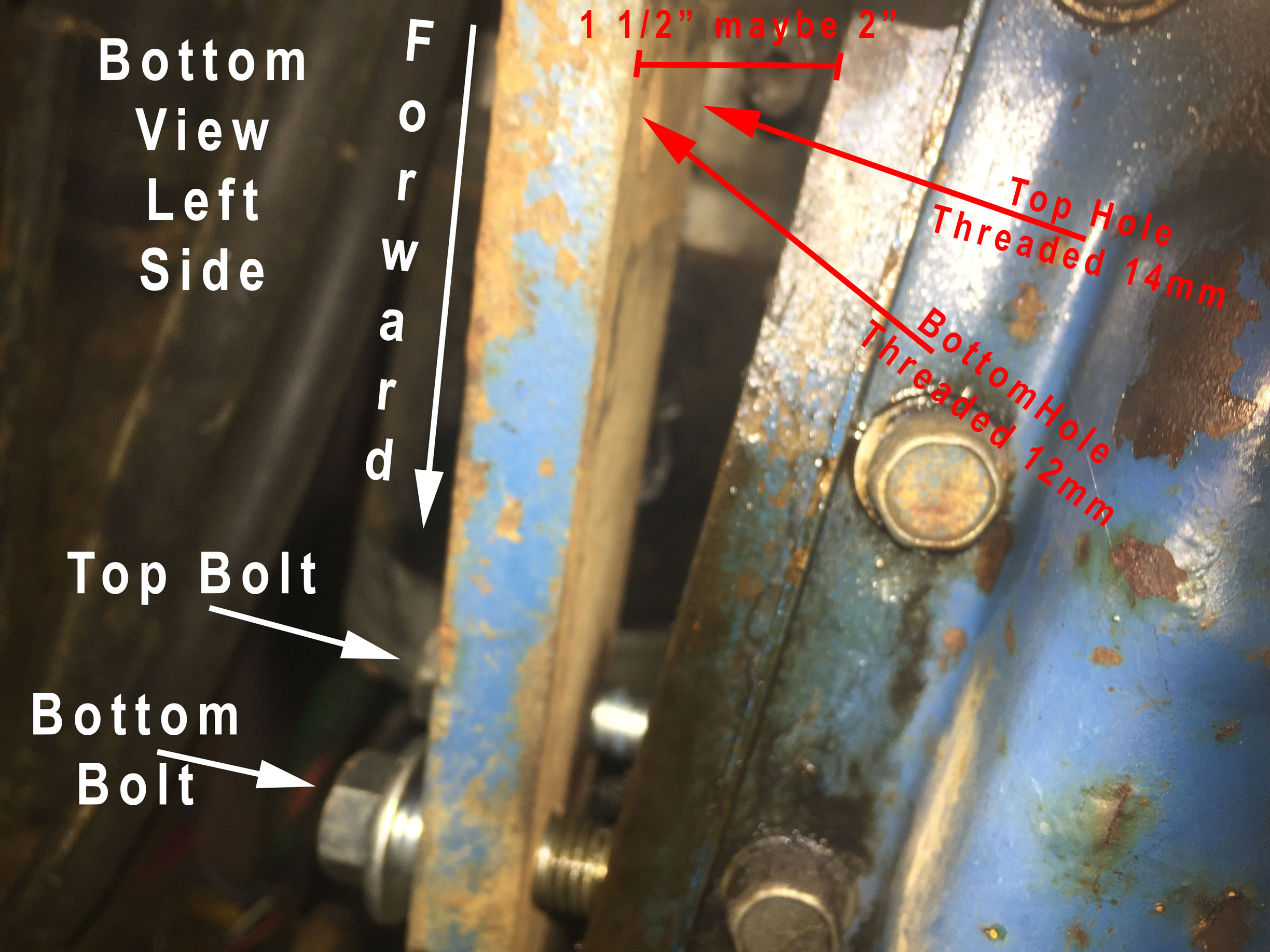

SUCCESS....maybe?
Here's the update. First, a huge THANK YOU for all the safety information and concerns. I took every precaution into consideration.

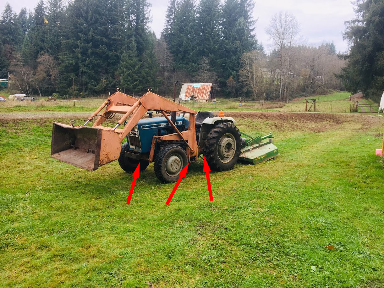

JC, you were referring to the type of front loader and I found out some more information from my mother-in-law. My in-laws were the second owners of this tractor which they bought back in the 80s. Originally it did not have a front loader and the original owner, who was an older, DYI'er found this front loader and attached it himself. I attached a photo with arrows pointing to the attach points. Different color, not factory front loader, as I understand.

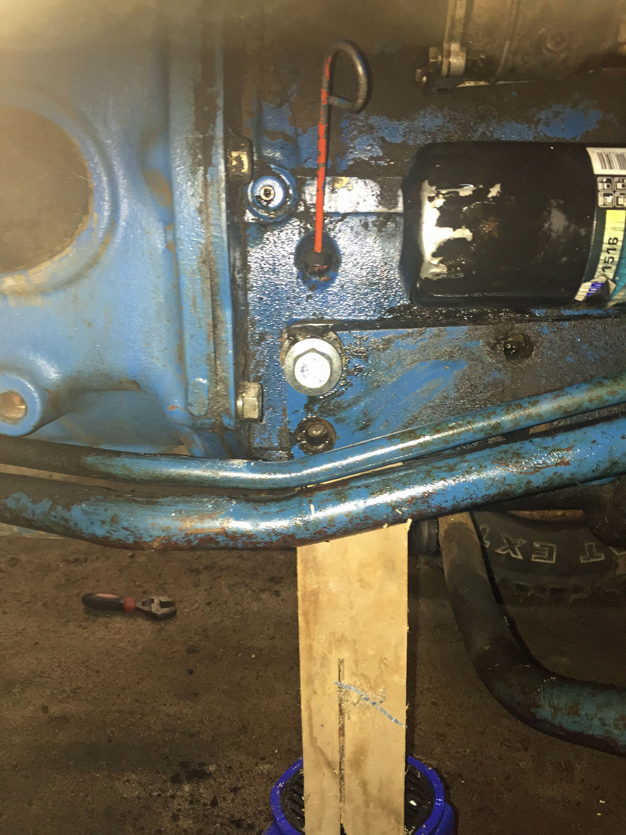

I had to move the assembly back approximately 2" and down about 1 1/2". I attached all the hoses, put an old oil filter on(smaller and might get demolished), and added oil since running it last. Started the tractor and with the front loader on the ground, used the hydraulics to pivot the assembly. I also put the tractor in gear and nudged it forward an inch or so and with some more finessing of the hydraulics, behold, I actually got a hole or two to somewhat line up. Add in some adjustments with a jack and here we go.
A little give and take and finally we have a bolt attached, holding the assembly somewhat in place.
I did the same on the left side and was able to get two in place.
So far, better than before.

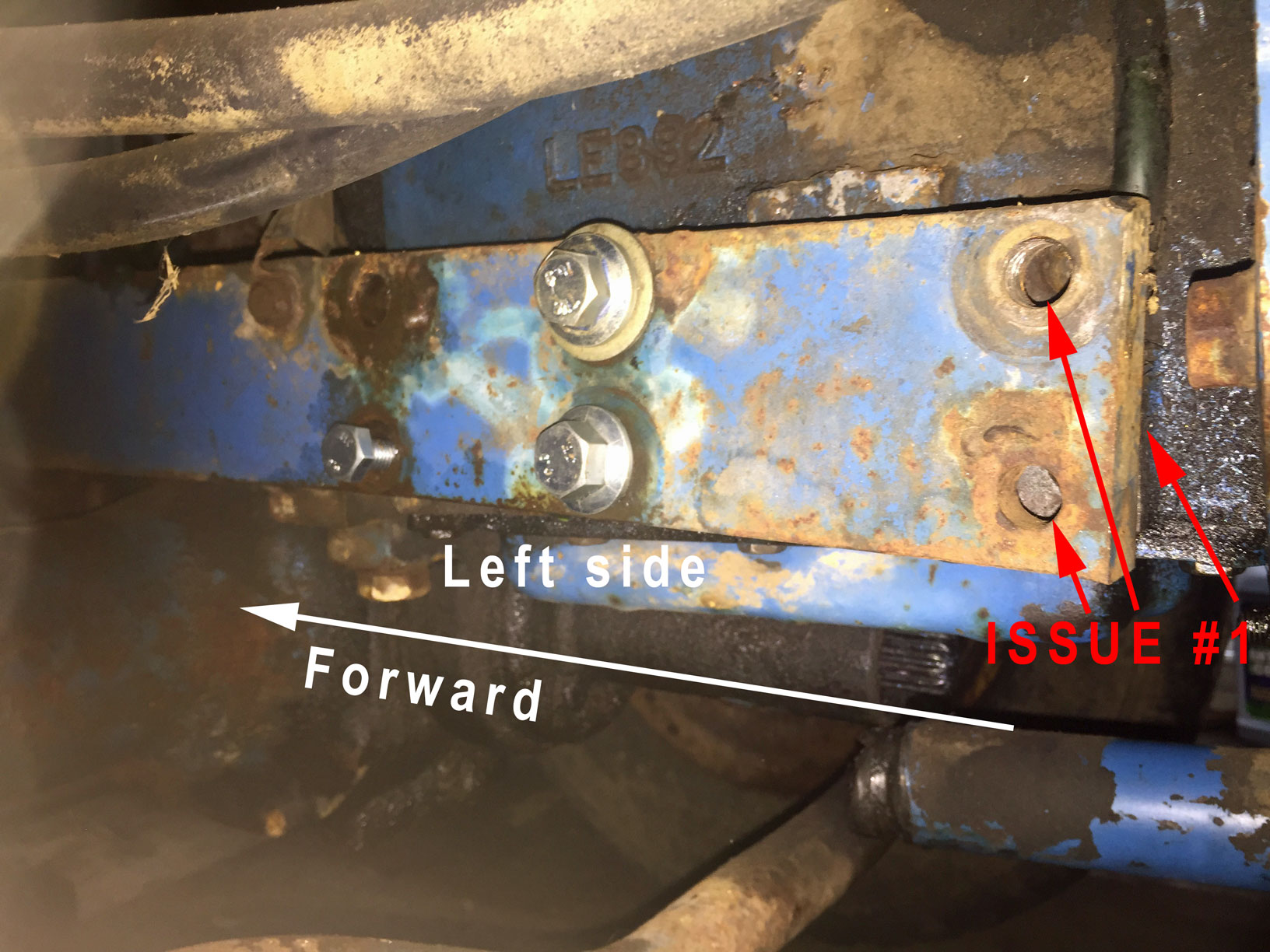

And now - First Issue:
Left side, assembly bent from the frame. I'm calling the bolts the first two, top/bottom, under the gas tank. It's bent out, away from the frame.
The 12mm and 14mm are threaded before they get to the frame. While a slow and tedious undertaking, I can see once I get the other holes lined up, slowly adding washers to slowly bend that back in place... Well that's my Rabbit Hole comparison. The assembly holes are threaded, and the frame holes seem to be shallow. Which is an issue.
The other holes are slightly off, but can be managed.
All thoughts welcome!

I looked at the pictures again and a bit closely. Following is my observations.
1- factory loader is connected to 3 threaded holes on the clutch housing. I zoomed in close but cannot see if loader is indeed connected to clutch housing . is it?
2- I would get a straight edge and visually verify if the mounting plate on either side of the block is indeed bent due to forces. I think you have created some spring action by manipulating things by hyd force and moving the tractor front and aft having the loader on the ground.
3- I think weight of the loader should come off the tractor to see if mounting plate mate up with the holes without spring action. I don't know if you can start a bolt in the hole and force the plate move toward the block without damaging the threads in the hole. There is a lot of spring action there.
4- Like I said before engine need to lifted up by a strap using the lifting lugs along with a gantry or engine hoist. in that fix the front axle and the mounting bracket should be free and dangling lose and that might give you opportunity to line the holes , bolt the mounting plates and the engine without any spring action.
5- I still don't know how the plate came off the block and potentially sheared and broke the bolts.
6- I still see the drive shaft off and dangling for the FWA, are you okay with that?
