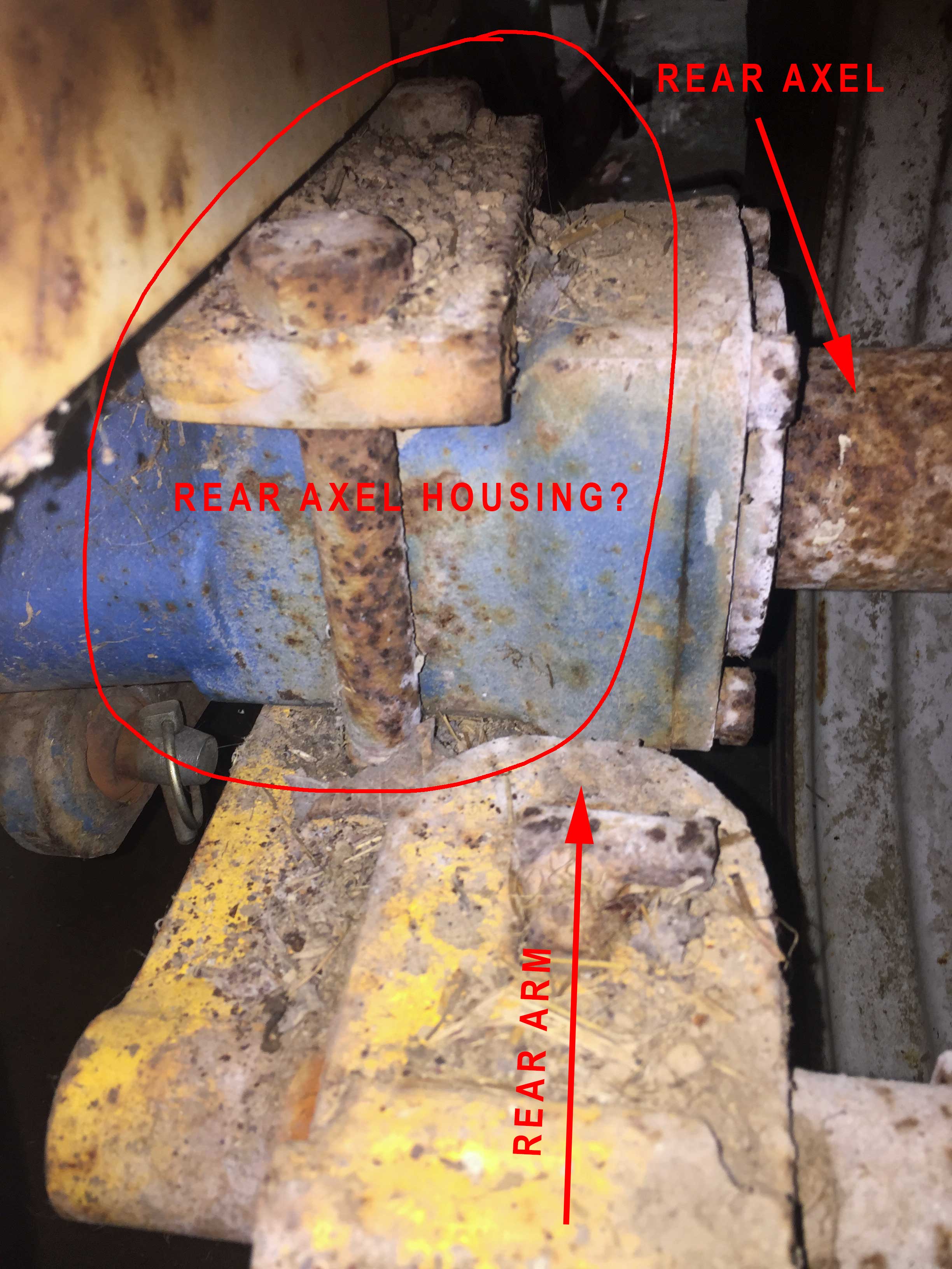

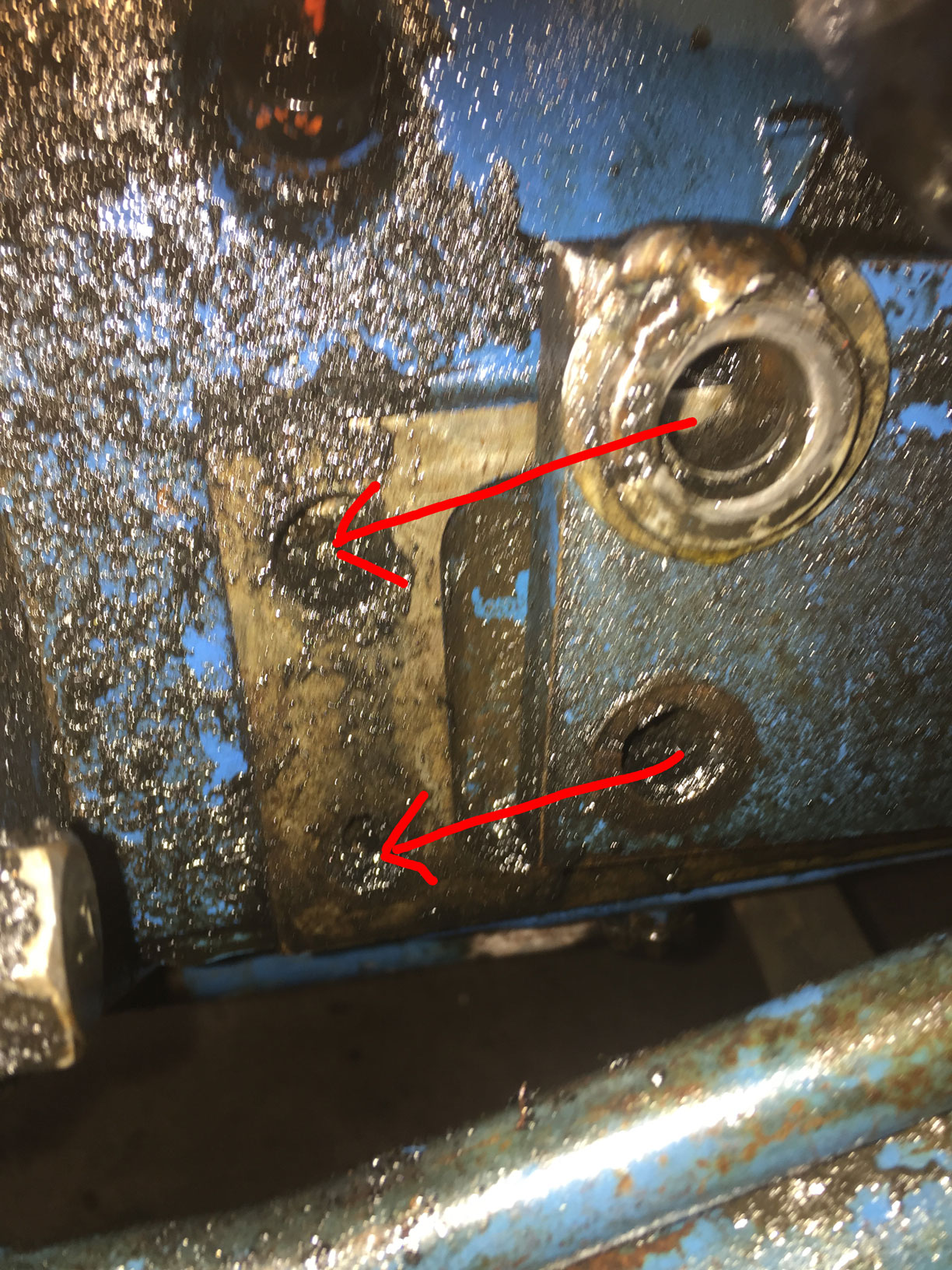

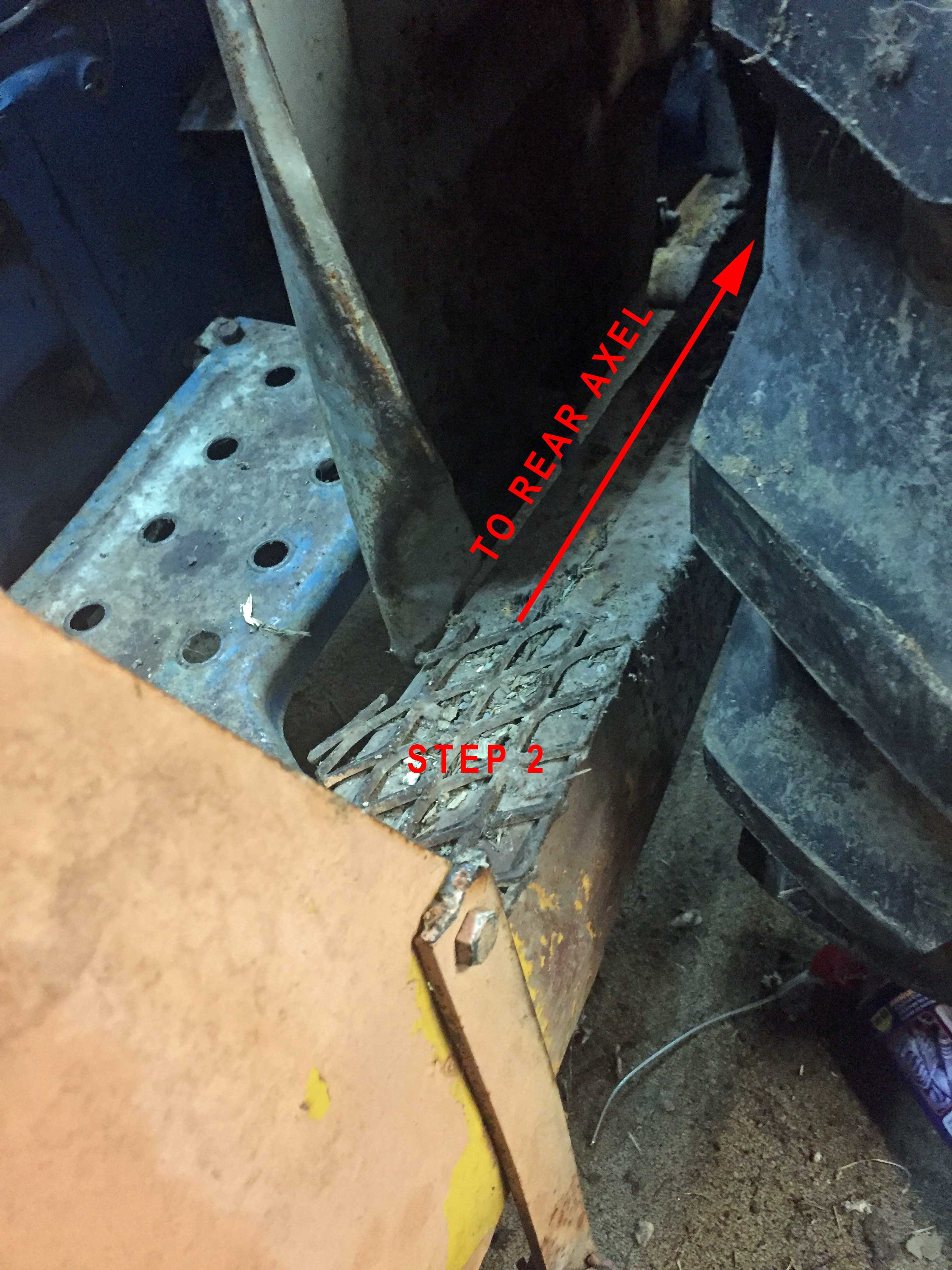

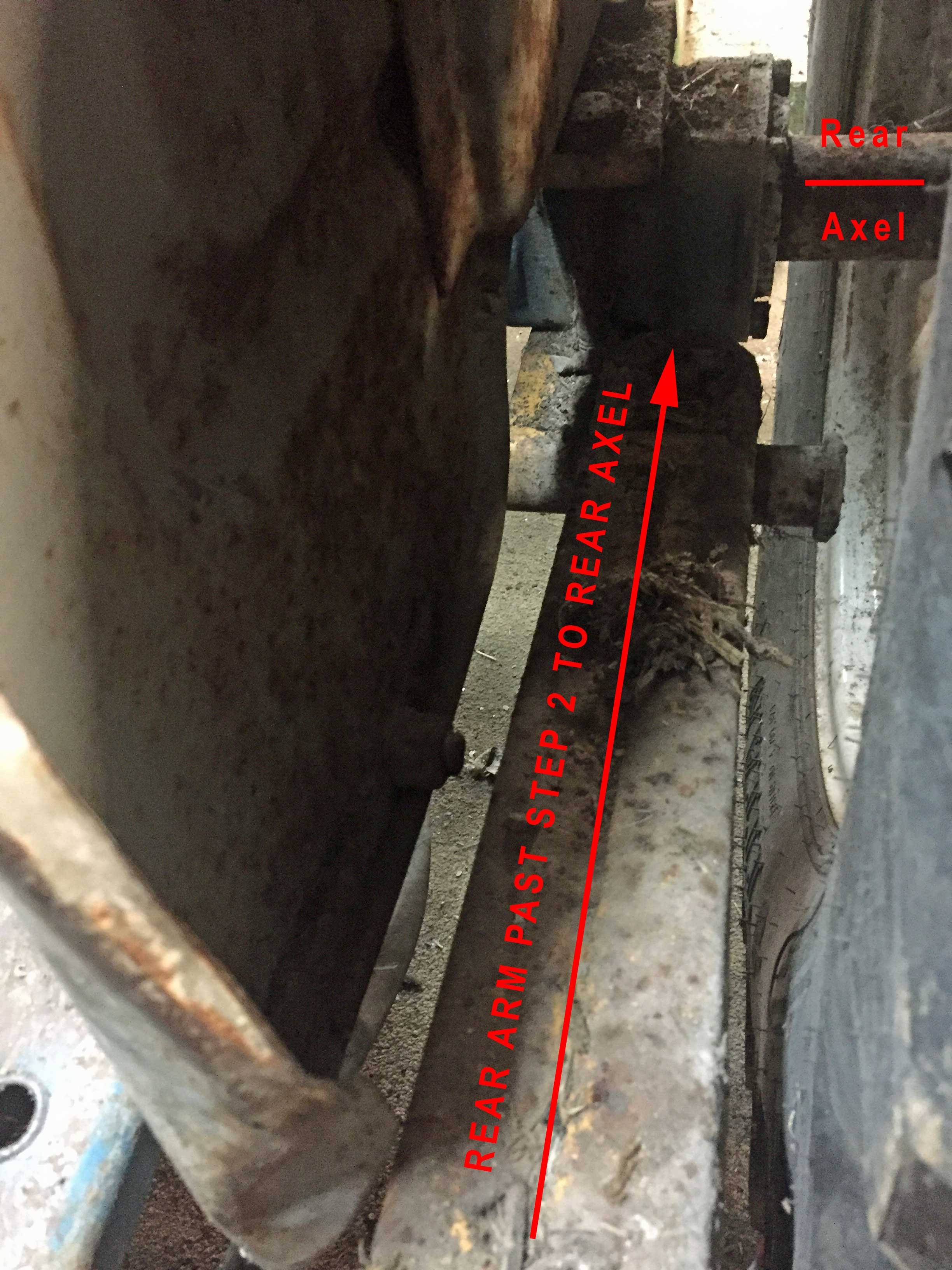

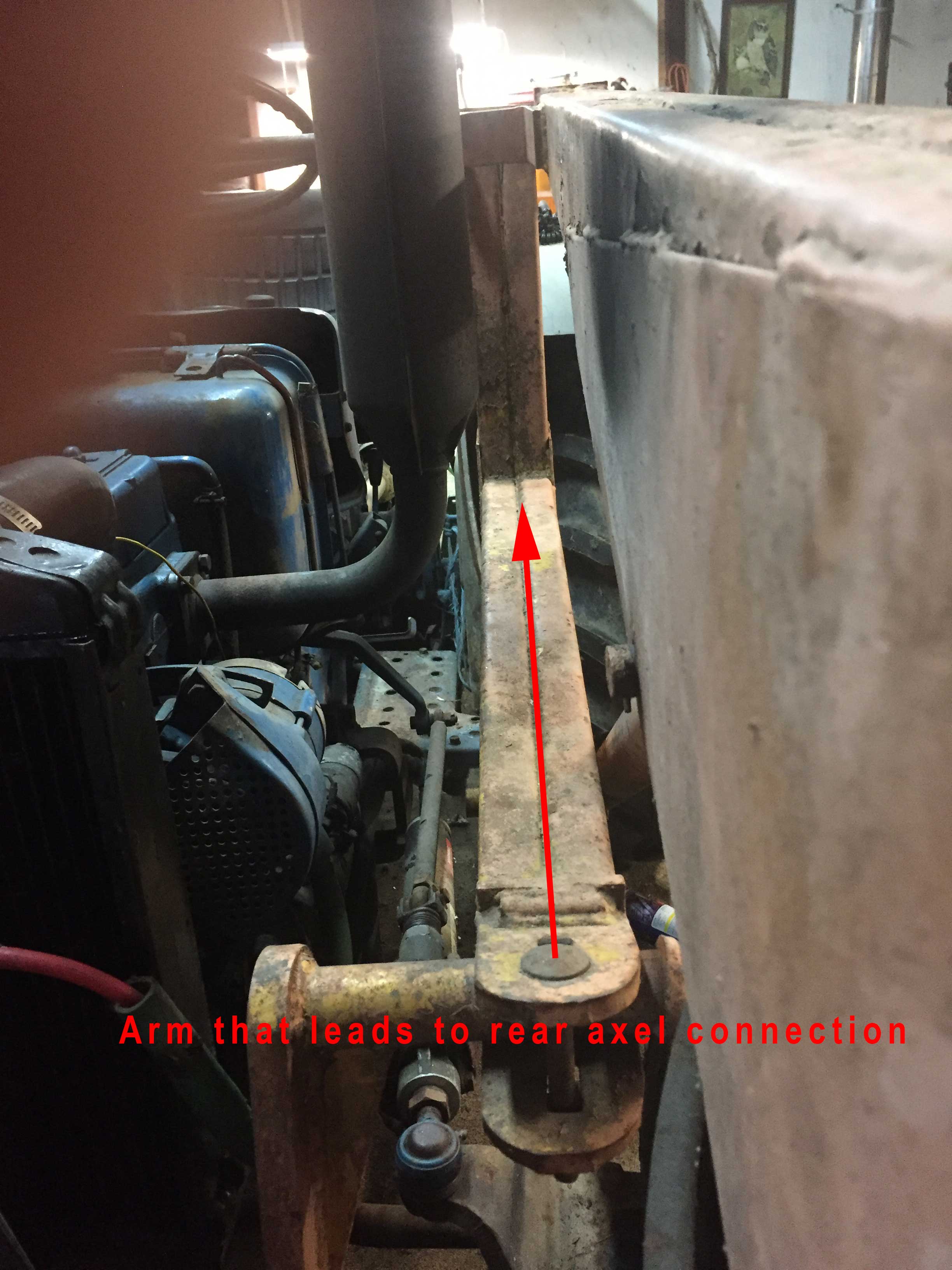

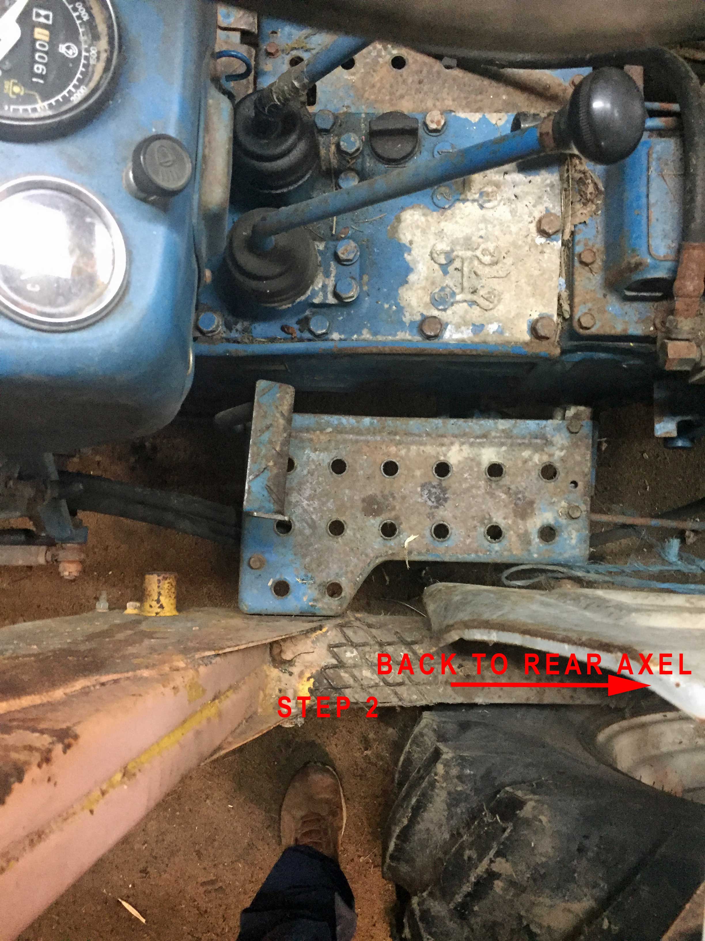

1- This loader is not factory and not connect at the clutch housing. It's connected at the rear axel and in the front at the assembly - Hence why it's moving the battery and radiator with the assembly not connected. I have attached more detailed photos of this.

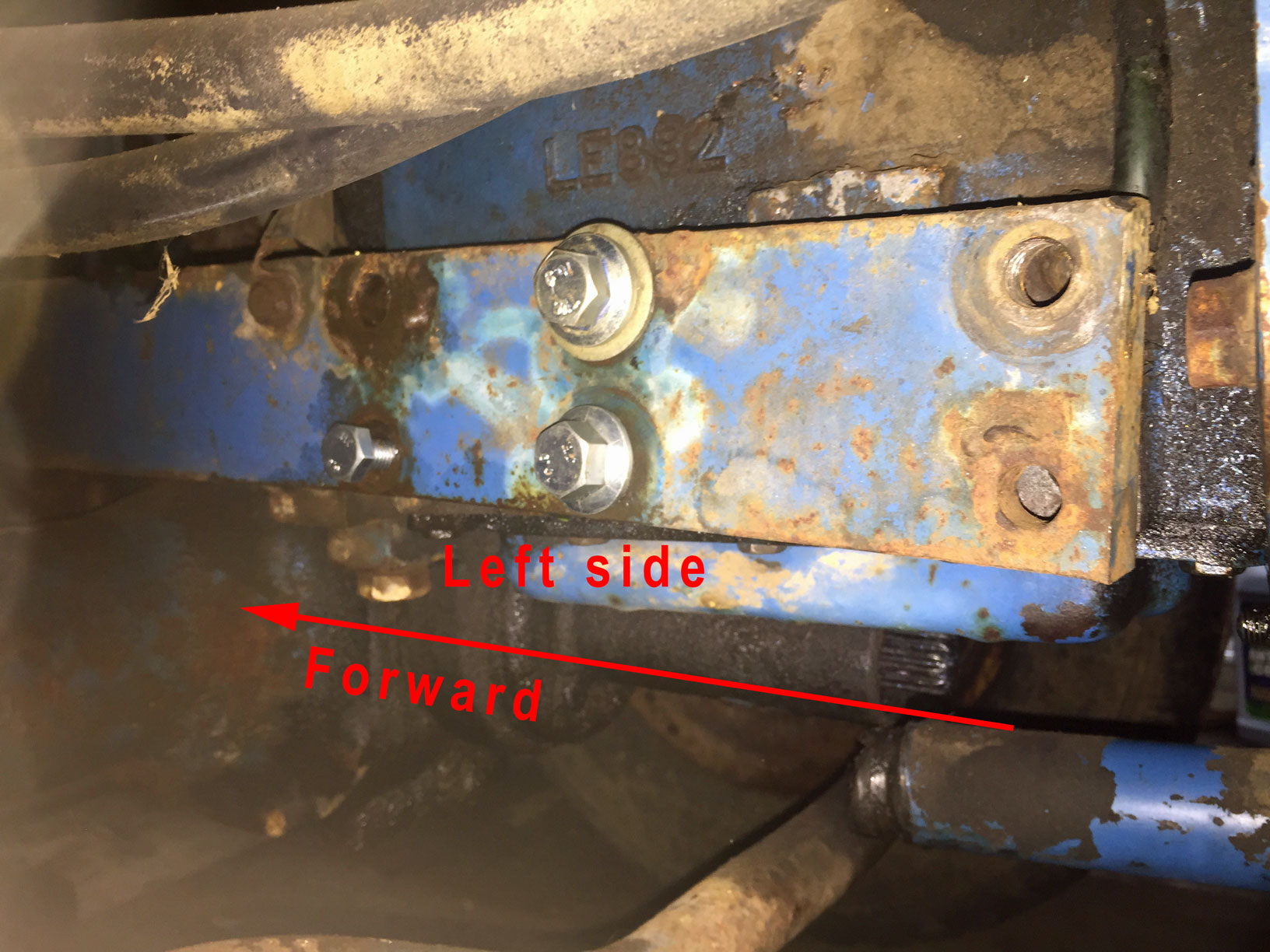

2- The mounting plate was bent before I started manipulating things with the loader on the ground. The bent area is where the only two remain bolts were located, but they were not bolted into the frame. If you look at the photo of the assembly about two inches in front of the hole, you'll see a "lip" and I believe the bolt(s) were under the lip, and the lip was holding the loader. Maybe, and a big maybe, the bolt finally got caught outside that lip and stayed in that position for some time, maybe years while sitting in the shop. The right side is not bent, but there were no bolts holding it together.
3- I'm going to attempt this tomorrow. I'm hoping to adjust the assembly down about a 1/4" in the front to line it all up.
4- Advice taken. It almost seems as if I have to attach the assembly to get the loader off to get the engine out, to detach the assembly to straighten it/fix and threading, etc - to then reattach everything.
5- Nothing sheared except something happened with the right/lower rear/frame hole. There's a hole, but nothing to screw a bolt to. All the other holes seem to be intact. ON THAT NOTE the assembly has been altered - It seems that a washer here or there may have been welded to the assembly mount. To the point where it would be worth getting a grinder in there to smooth the surface.
6- Yes, the drive shaft is off and dangling. I will address that after getting the assembly mounted. It broke when the front rotated, I'm guessing. I'm hoping it can be fixed with a weld.

Here are the photos of how the loader is connected to the tractor.

We went from this:
To this:

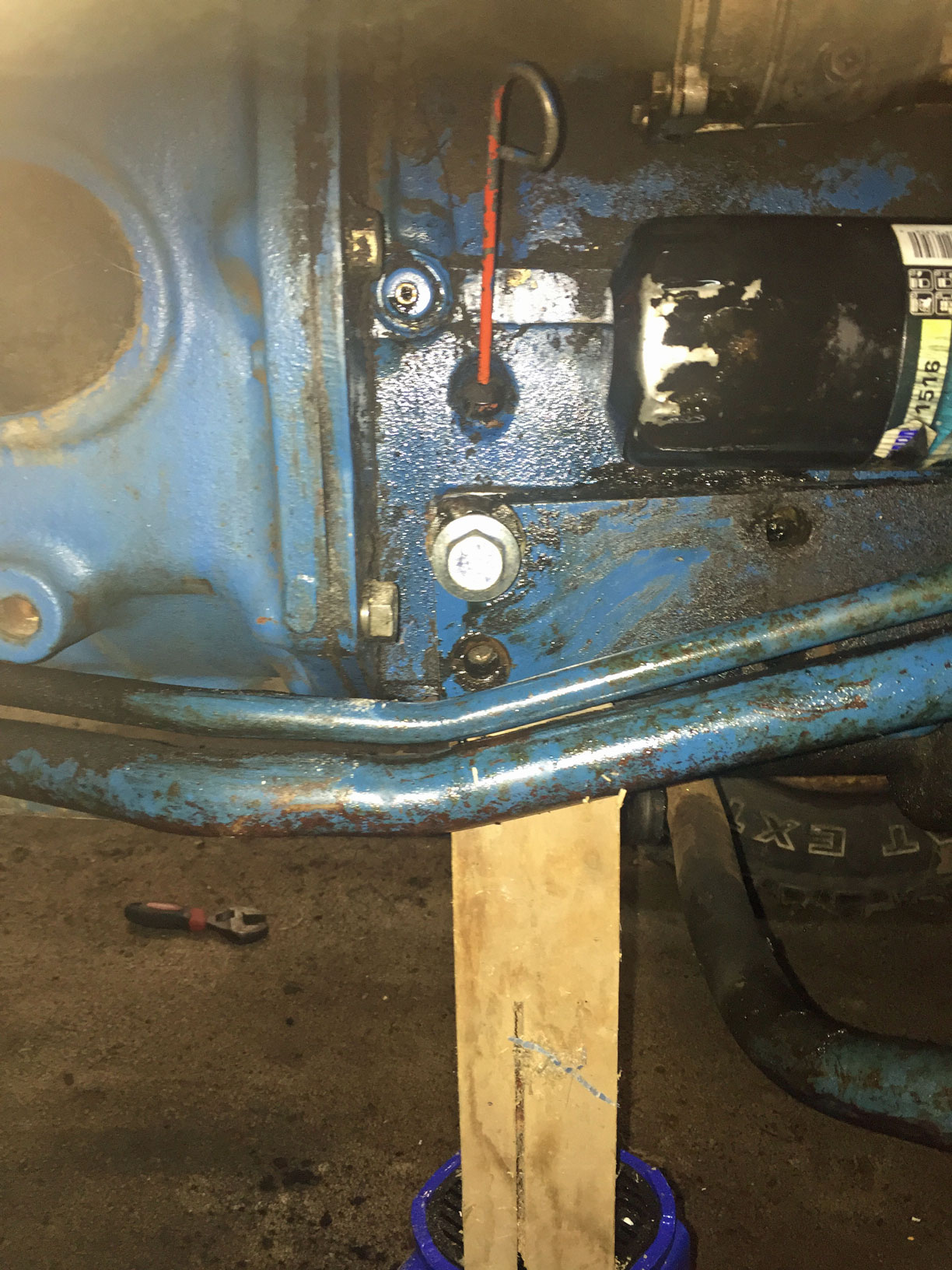

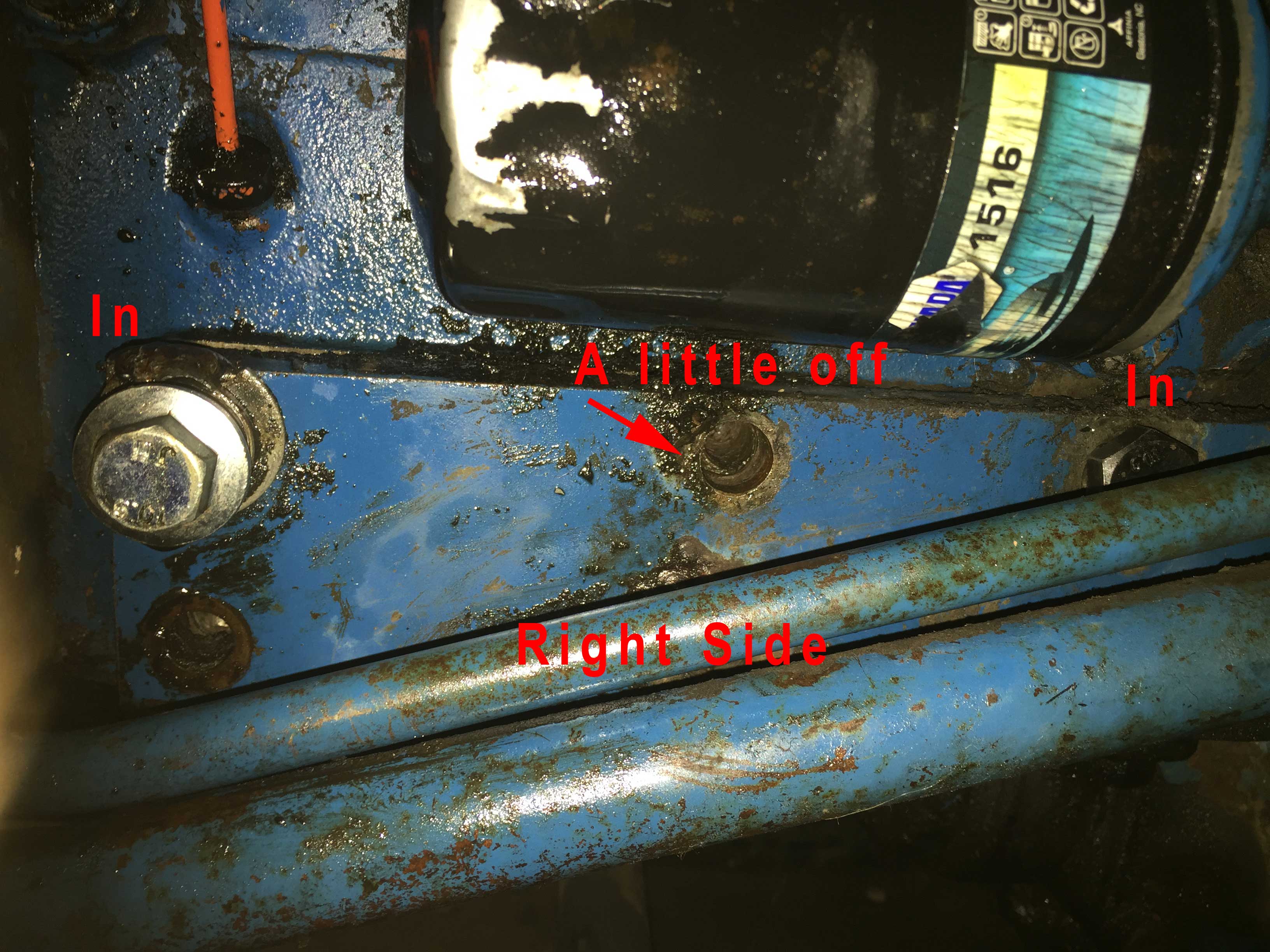

And now this:
Every bolt you see are temporary until I get it all lined up.

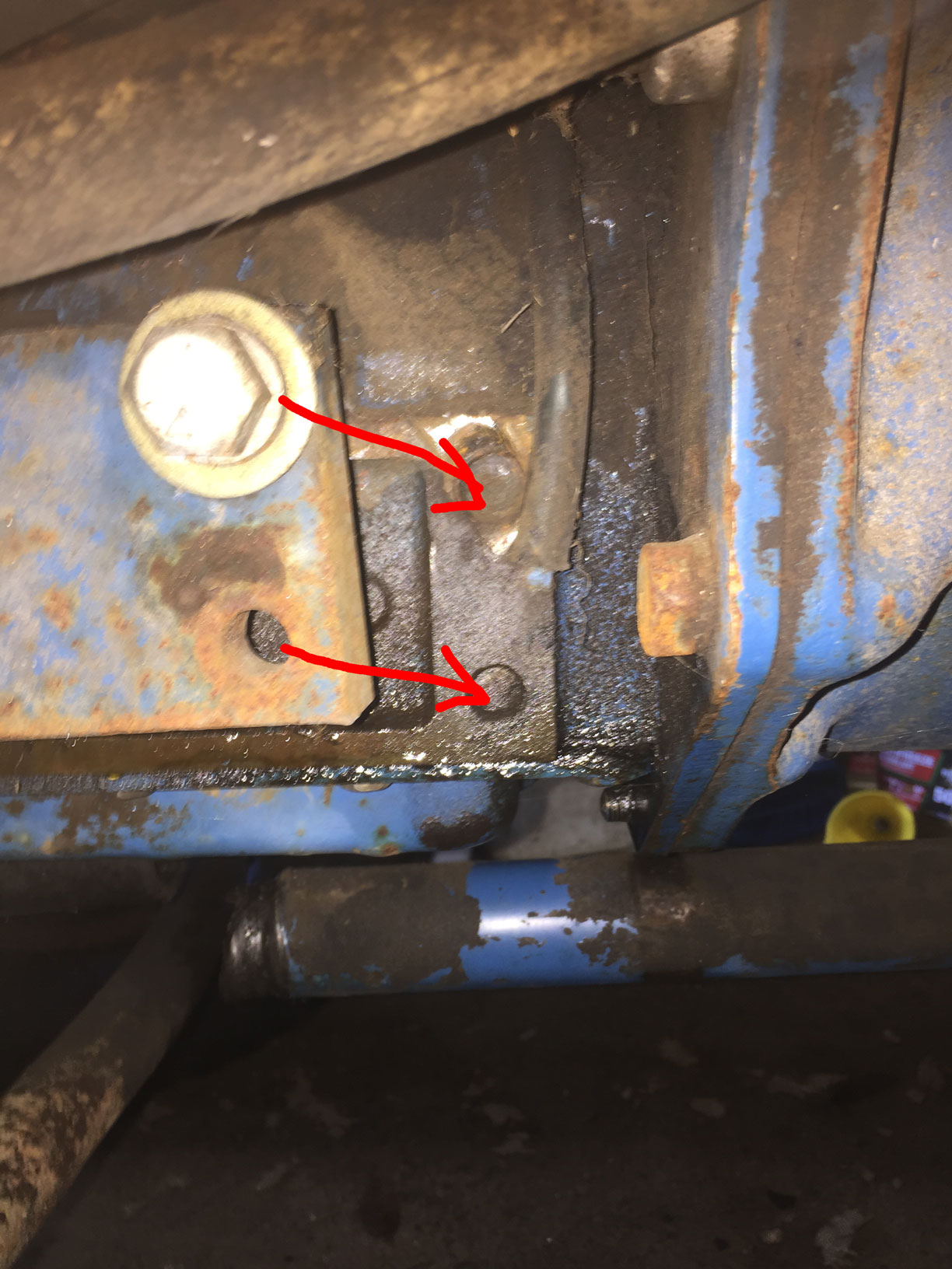

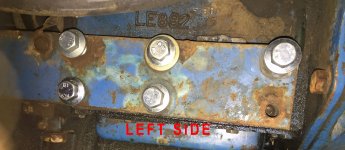

The missing bolt on the left side is actually 12mm instead of 14mm. I have no idea why. Also the missing bolt hole and the one above it are threaded on the assembly "arm", meaning not a clean shot to the engine block. Not a big deal, and will fill the bent space between the assembly arm and engine block with washers.

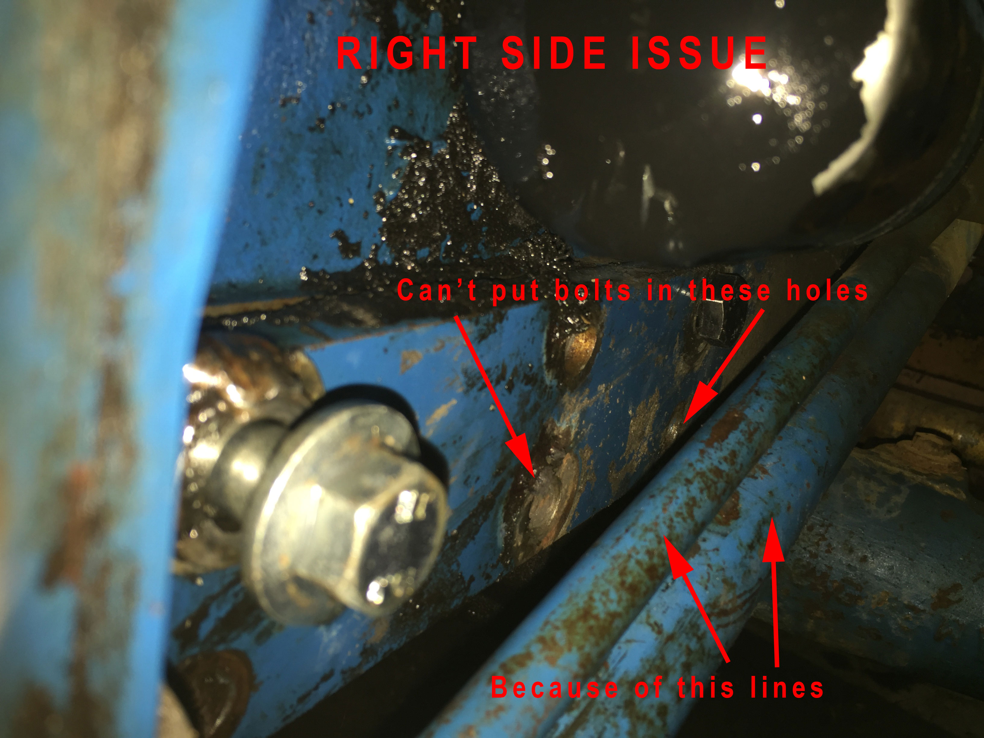

My issue is the right side.

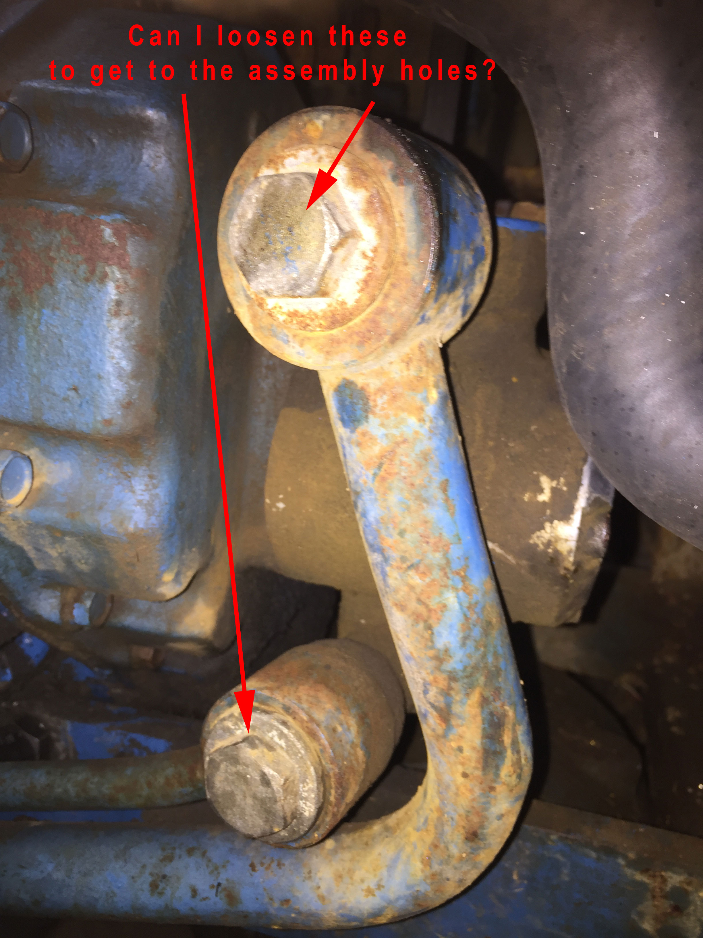

The lines that are running up to the front of the engine are preventing me from being able to get more bolts in there. The one black bolt is a 14mm x 30mm 10.9 bolt. As stated the hole with the clear shot is off and I'll deal with that tomorrow. But the other three holes, there's no way of getting to it unless I tend to those two lines. I'm afraid that I'm messing with a gigantic COW(can of worms).
Can I loosen those lines to get access to the holes? Not sure what the lines are.
Once I get this last piece together, I'll go back and replace each bolt with a proper fitting bolt, washer, lock washer and liquid "bolt lock". I have someone that said he can weld if needed.
All ideas about getting the right side bolts in are appreciated.
Thanks!

this one looks specially good. You will have some spring in the frame member once you cinch it all. Make sure not to damage the threads in the hole sucking it together
Those two lines are hydraulic suction to the pump (bigger dia and discharge /high pressure the smaller dia. You can certainty take them out from the banjo bolts. They are connected to the differential (suction) and to pressure control block next to the seat. Do be careful not to bust them . if you take it entirely then you would need to prime and burp that line of hyd oil. there is potential of pump damage if you are not careful. I suggest to remove from where you show and gently push it back only to the extent you can have access to the bolts.

let's see how this all come together. See how well you can tighten and torque the bolts without further damage specially to the threads in the hole. If the don't fully tighten then I would not force it getting a larger cheater bar. I am afraid of damage to the threads. if all relatively line up and you are happy with loader going up,down and curl then I still consider welding to keep things where they are permanently. The loader causes a lot of torsional force once things are picked up and right or left turn attempted. That stress goes directly to frame bolts.

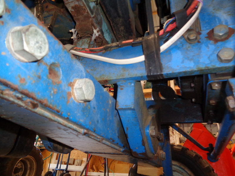

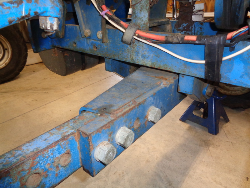

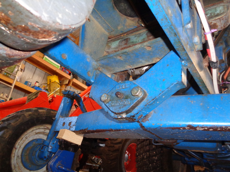

Here I have a picture of my from axle and how the support is welded with a cross member. You's will look different as you have FWA. Does the pivot looks straight and without stress bend? that axle needs to pivot up and down freely.
I loosened the hydraulics lines like recommended by JC and sure enough, while the lines started SLIGHTLY bleeding I was able to move the lines and put a bolt in!! THANK YOU JC!! While I'm not out of the woods on the right side, I have a play of attack. Bolts, washers, Locktight. Pictures sometime tomorrow!
