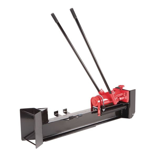

As far as splitting goes -
I bought one of those 10 Ton Hydraulic Log Splitters from HF, my fireplace of use was in the walkout basement.View attachment 728229
Used it sort of like a Nordic Track to exercise my arms while watching TV.
I have one of those. It works really well. It's not necessarily faster than splitting with a maul, but it sure is easy!

For me it was a LOT faster. I was splitting inside our "rec room" in the basement. Kept hitting the basement ceiling with the maul :)
