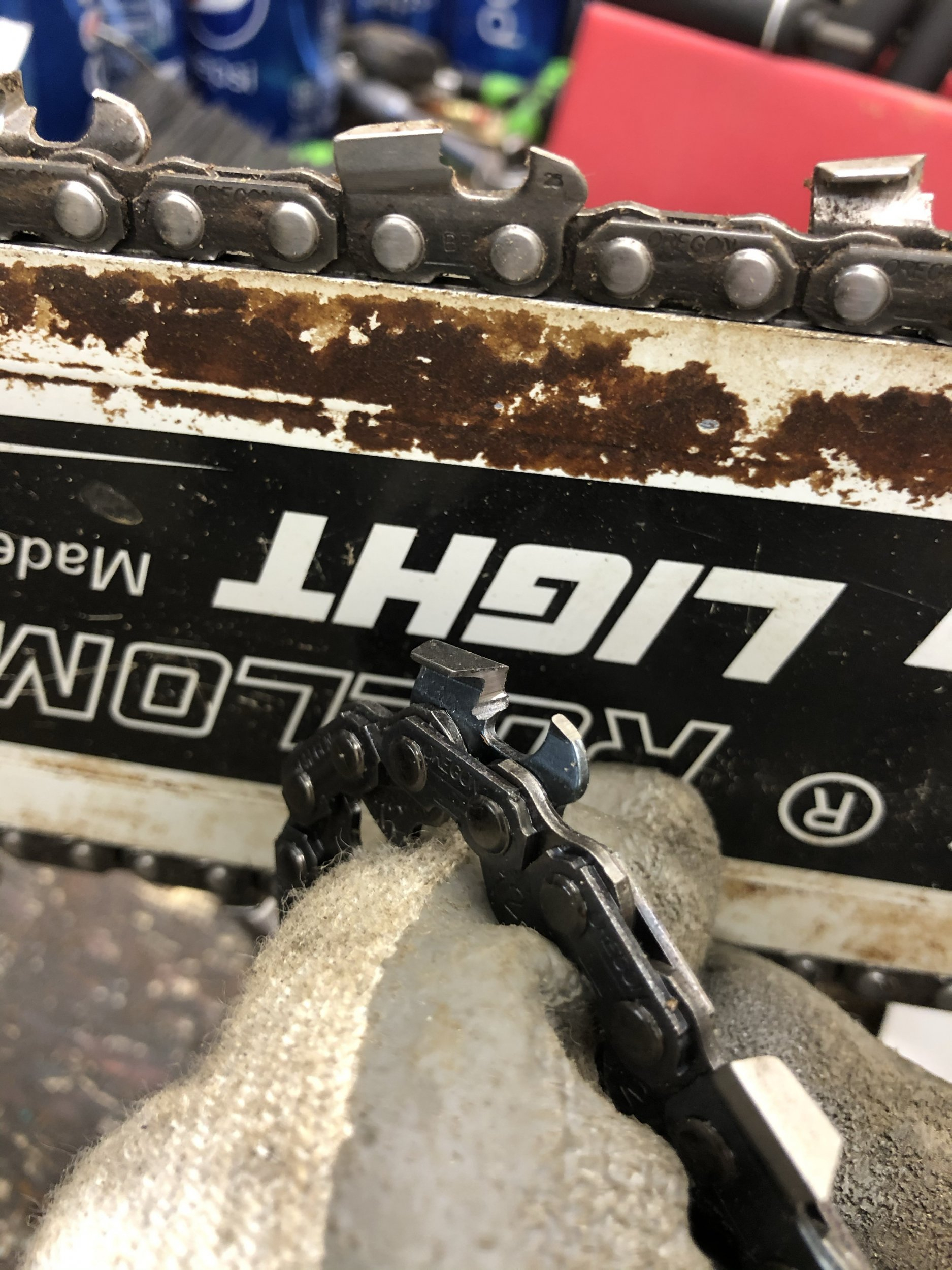

[mention]N80 [/mention]
Could you throw up a picture of the cutters and depth gauges of the chain? I’m very picky on a chain a fresh off the roll chain cuts like garbage it’s slow vs a ground chain.
As far as a larger saw having ran saws falling timber for around 15 years I’m more of a husky guy but do run Stihl as well the 500i is a great saw. Most of these saws are on the big side of what I’d recommend to most people honestly my smallest saw is pushing it for most it’s a 562 they will pull a 32 when asked to as well as being light.

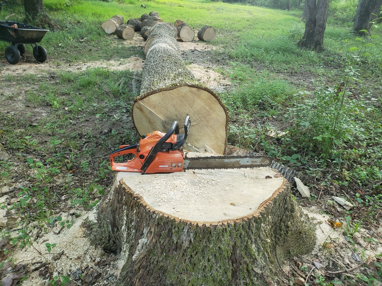

I have an Echo CS-490 for about 4 years and have bucked dozens of Ash and a few Maple/Oak/Poplar.
Still runs fine with 18" bar it is strong, with 20" bar it works well but can bog.
For the bigger stuff I have an Echo CS-620P and 24" bar. It is fast, but a bit heavy.
It is well balanced in the cut, so while cutting it feels no heavier than the 490
Both were significantly cheaper than the Husky's, and about 1/2 the cost or the Stihl (or less!)
Both start easy and the 620 has a decompression button, titanium cover and double bumper spikes.
Was using the 490 for this 34" tree, was a lot of work-switched to the 620 and all done in less time than 2 cuts from the 490.

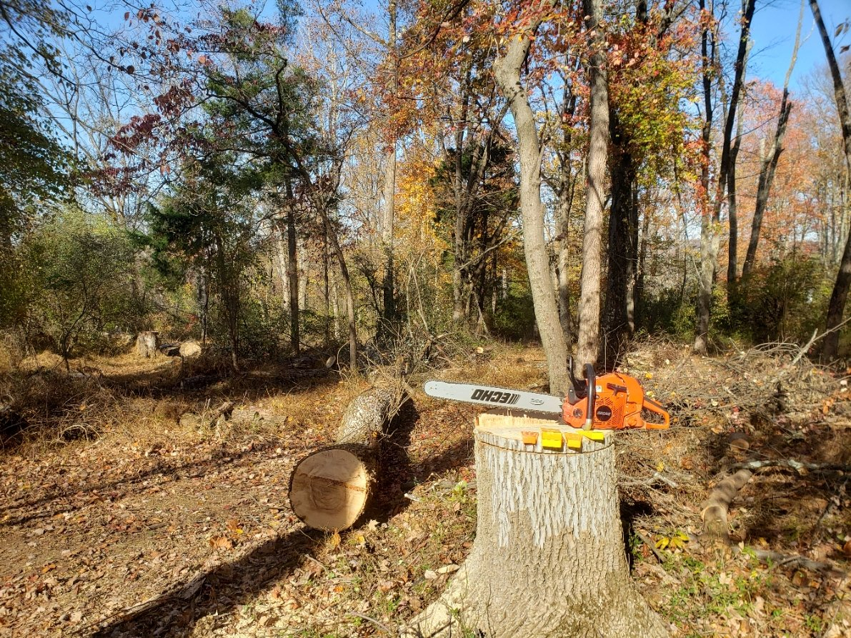

I bought a 620P 60cc Echo over a Stihl 362 about 4 years ago. 3/8" chain.
Both dealers are within 4 miles from home. I really ike the Stihl dealer and go in to chit chat now and then and the Echo dealer just wanted to sell the cheaper 60cc saws he had on the shelf instead to the more pro style saw he would have to order.
The 620P has compression release which is great, saw was quite a bit cheaper, doesn't seem to heavy. I can run a 27" bar but I just wanted a 20" bar. I ordered it from Arlington Equipment in Indiana I think. I took it out of the box 3 days later, put gas in and went to work. Never readjusted anything and runs as smooth as new. I maybe cut 30 cords of wood so far, oak up to 26" rounds and it never slows down. Of course I make sure chains are sharp.
I also have a 50cc 026 Stihl, 55cc John Deere which is a rebranded Echo, and a couple smaller ones. I would not hesitate buying another 620p. I always grab for the 620p for everything as it just makes cutting easy, in my view.
