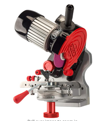

ho sorry i miss understood that i thought you wanted a chainsaw for both trail cutting and milling,
for sharpening I have seen this puppy (see image and link below) and without disrespect its fooled proof perfect sharpen every time.
