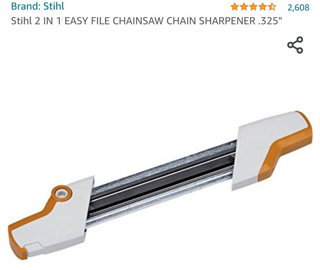

Also, the Stihl sharpener that Root Cause recommended is excellent. I've done all kinds of sharpening over the years and this thing is not a gimmick. It works amazingly and is fast. For $30 you can't beat but get yourself a bunch of the round files as they dull rapidly if you do a lot of sharpening. My personal rule of thumb is that I run the sharpener after each extended use of the saw; that way it's sharp and ready to go when I next pick it up.

I would not try to change your mind but unless you have tried a Stihl sharpener, you cannot make an honest comparison.
You may be an expert with a round file but the Stihl sharpener sharpens the cutter AND resets the depth of cut with a flat file.
There is an "Expert" chain saw guy on youtube who had the same opinion until he finally tried one. He hated it as it came out of the package and slowly changed his mind until he had to admit it was as good as he had used. He was honest enough to post the video.
Not trying to stir up an argument and detail the thread but this Stihl doesn't look like it will break and the files can be inexpensively replaced.

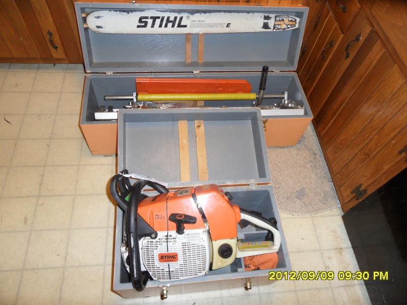

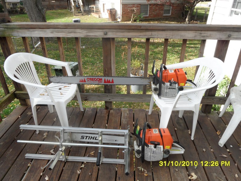

So young'un you've got about a 50cc saw.
To adequately run a 28" bar with some oomph you'll need more HP.
The Stihl 500i is EXPENSIVE for a chainsaw.
But you can expect to get 661 performance from it.
I've run my 660's quite a bit but my 088 only a little.
I'd suggest a 500i and an assortment of bars, a 22 to 24" for and at least a 30" for when you need it.
I found my self using a 42" bar on my 60CC saw for limbing, didn't have to bend over.
Now I don't know about modding a 500i but I know modding my 660's really "woke" them up. One simple mod was a dual port muffler, basically a $20 to $30 swap.
