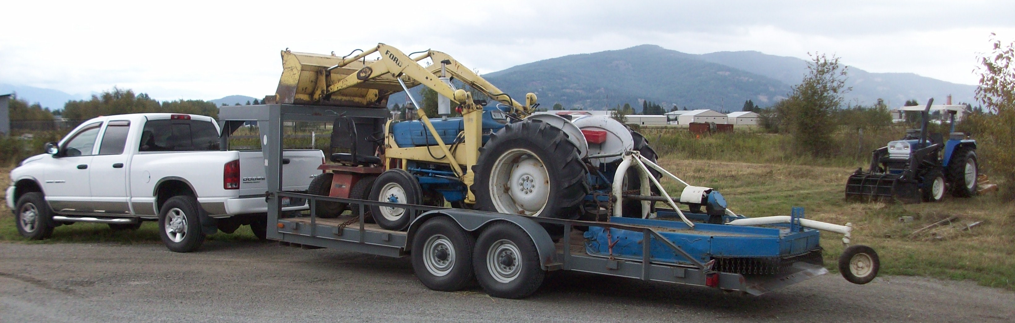

I would go no smaller than 18'. I have a MX5100 (50 HP) and I can squeeze my tractor, rear blade on with very little room to spare. Would't mind having another 2' or so....
Totally agree- even my 40 hp ford and the brush cutter is a little long for my 20 foot tilt trailer. mowing Kim & Dons finished 009.JPG
It would also be over weight if limited to 6850 lbs. on the trailer and or trucks load capacity
tractor 3800 + 1500 loader +900(loaded 14.9x28") 800lbs. Old ford 6ft. brush cutter + 700lbs. riding mower = 7700lbs. ... it adds up quick
You will have to be careful in your choices- to meet your weight limitations

Thanks to everyone for the advice. My tractor weighs 4585 with cab and then have the loader plus tires filled with beet juice. I am up to 6500 real quick. I would not be hauling anything other than the tractor at one time. And I forgot to mention I am looking at a bumper pull.

Rethink hauling just the tractor. That's like going fishing and taking only the pole but leaving the beer and tackle box at home. A tractor without implements is pretty worthless.
I usually have one under the FEL, one on the 3 point, and one in my trucks bed.

I went from a 18' to a 22'. It allows me to adjust the location of the tractor depending on what truck I am pulling it with. Pull the tractor all the way to the front with the F250 and about 2' back with the F150. The length of the trailer has never been a issue with the bumper pull. CJ
