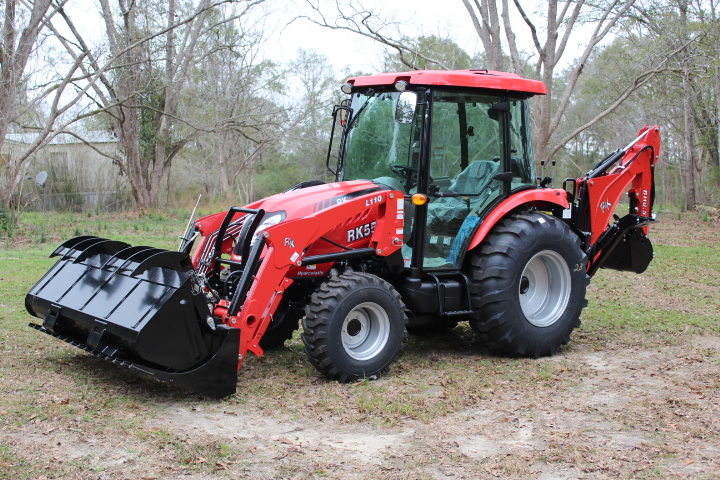

Well We Need a picture of the new 55HP RK tractor with cab
New machinery sure is Nice to have and about now sure wish I had a cab on a tractor.
TBN rules- Pictures or it didn't happen
Lol. Got it.
Just unloaded an hour ago:
It took a month for the most of the stuff to come in and get installed. The pallet forks are still on order.

Merry Christmas! The best present, with a cab!

Congratulations. It sure looks good. Most new tractors have a period of time when you have to adjust and fix a lot of picky things - if it happens, don't let that get you down.
