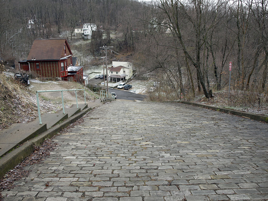

We have a lot of them around here that are steeper. This is one thing I hate about this area.
My wife and I were down there last week. We drove from here to Hannibal, MO, then down to Mark Twain State Park, Columbia, Rock Bridge State Park, Osage Beach, Lake of the Ozarks State Park, Ha Ha Tonka State Park, Bennet Spring State Park, Branson, MO, Table Rock State Park, Eureka Springs, AR, Bentonvill, AR, Crystal Bridges Museum of American Art, 4 casinos in Oklahoma, back to Branson for the night, then over to Cape Girardo, IL, another casino, Trail of Tears State Park, down to Cairo, IL to see the Ohio dump into the Mississippi, and back home.....
Yes, you do have steep roads down there! :laughing:
