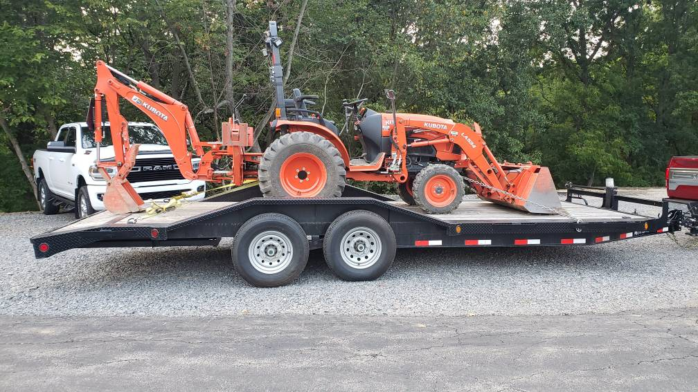

That looks like a trailer built for half the capacity, that just happens to have double 8-lug 7k axles underneath it. Interesting.
It very well could be but it has worked really good to haul around my little tractor with FEL and 6' bush hog.

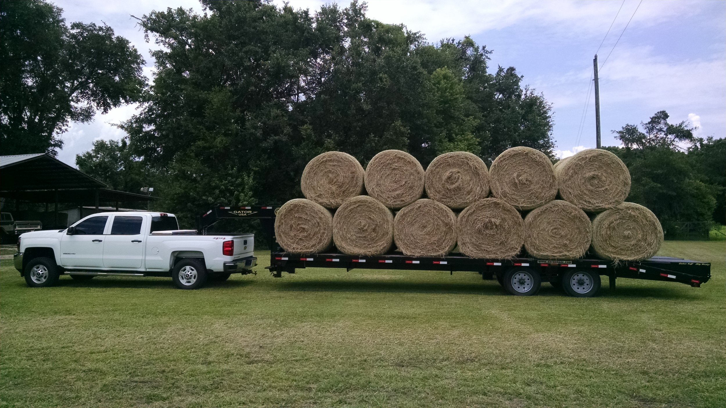

This is what I use to haul my bigger tractor equipment and hay.
Heck yeah, perfect for that! Exactly the kind of trailer I want to own, actually.....
