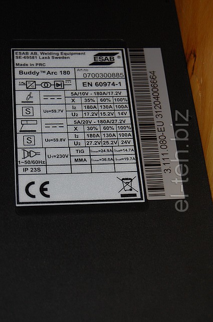

I've checked ESAB equipment BUDDY ARC 180. Could be good as well, even if maximum electrode diameter is 3,2 mm (comparing to Kemppi EVO 180 - 4 mm). Good price - $330 only.
ESAB Buddy arc 180

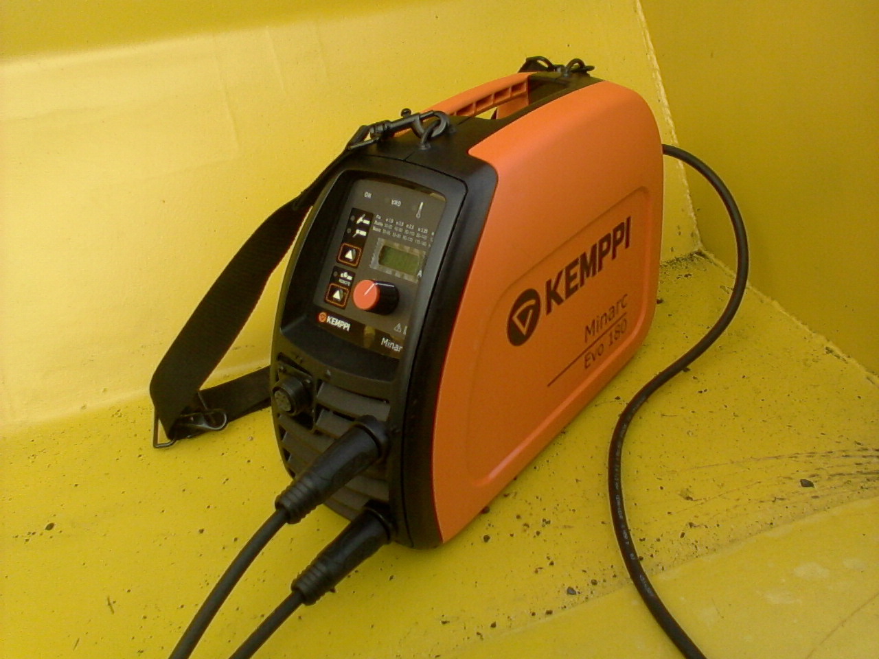

Made a decision on Kemppi EVO 180. I already have it.
Welding for me is another world I'm coming in. Still doing many training attempts with different sticks, current, stick moving speed and angles.
The machine itself is doing its job perfectly. All the rest depends on me.
Thank you guys for your advices and comparisons.

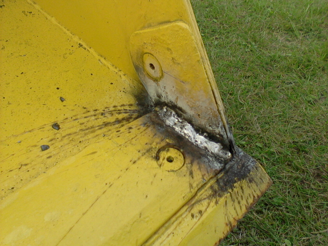

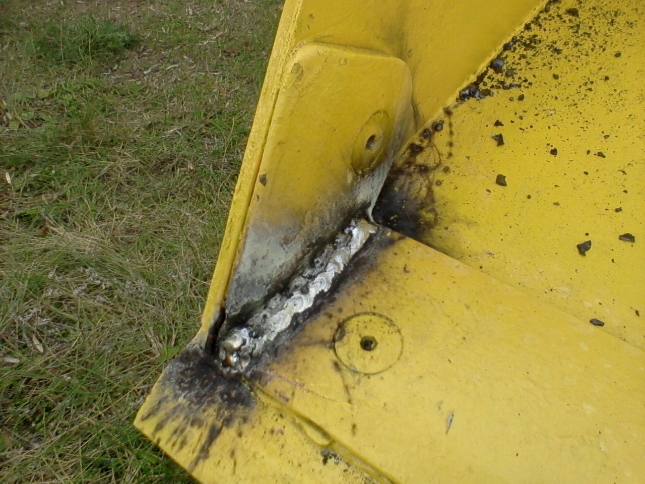

Here is my first serious welding job with a new machine. Looks not enough good to me, but a bit better than at the beginning.
Steel - 65G (GOST standard, soviet - it's a spring steel), electrodes - ELGA Cromarod 312 (3.25 mm), thickness of pieces - 10 mm, current - 100 Amps.

Looks to me you are just starting the arc and dragging the rod. Try weaving the rod side to side as you drag it across the weld. Weaving from one side, pauseing for just s second and then in a semi circle motion, weaving to the other side and pausing as you drag the rod will tie in the weld a little better and leave a smoother bead.

Before welding I've made the chamfers on both sides of the horizontal part (edge) so to sink deeper the first two passes. I was thinking, maybe I had to choose greater diameter rod and greater current. But you're right, I was too fast to move a rod. And this technique - to move it from side to side - is known for me. Yes, I had to apply it in this case.
Thank you for advice.
