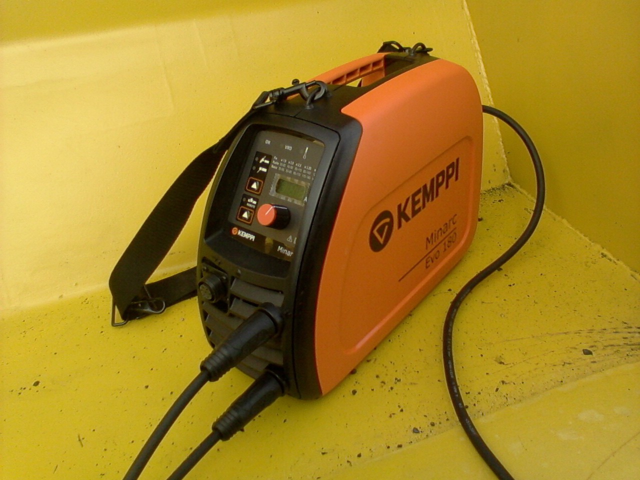

That makes me feel better about the Kemppi.
If it was me and I was set on that brand it would be a tough decision whether or not to upgrade to the 180 EVO if it's priced only 25% higher.
   / Need advice on welding machine purchase
#12
Yeah, I'm looking at both and thinking...
Just thought for me as for beginner Minarc 150 would be enough. I'm afraid if I will not overload 220V input power supply with Minarc EVO 180, which is more powerful than Minarc 150. Although they declare EVO 180 uses technology PFC, which reduces impact into input power supply by 30%.
http://www.tonolini.it/wp-content/uploads/2015/01/MINARC-EVO-180_en.pdf
Today I've visited dealer who sells Lincoln. Got a proposal on Invertec 170S, assembled in Poland. With some discount (both cables included) they can sell it for $767, exactly the same price like EVO 180 costs.
Anyway, no decision yet.

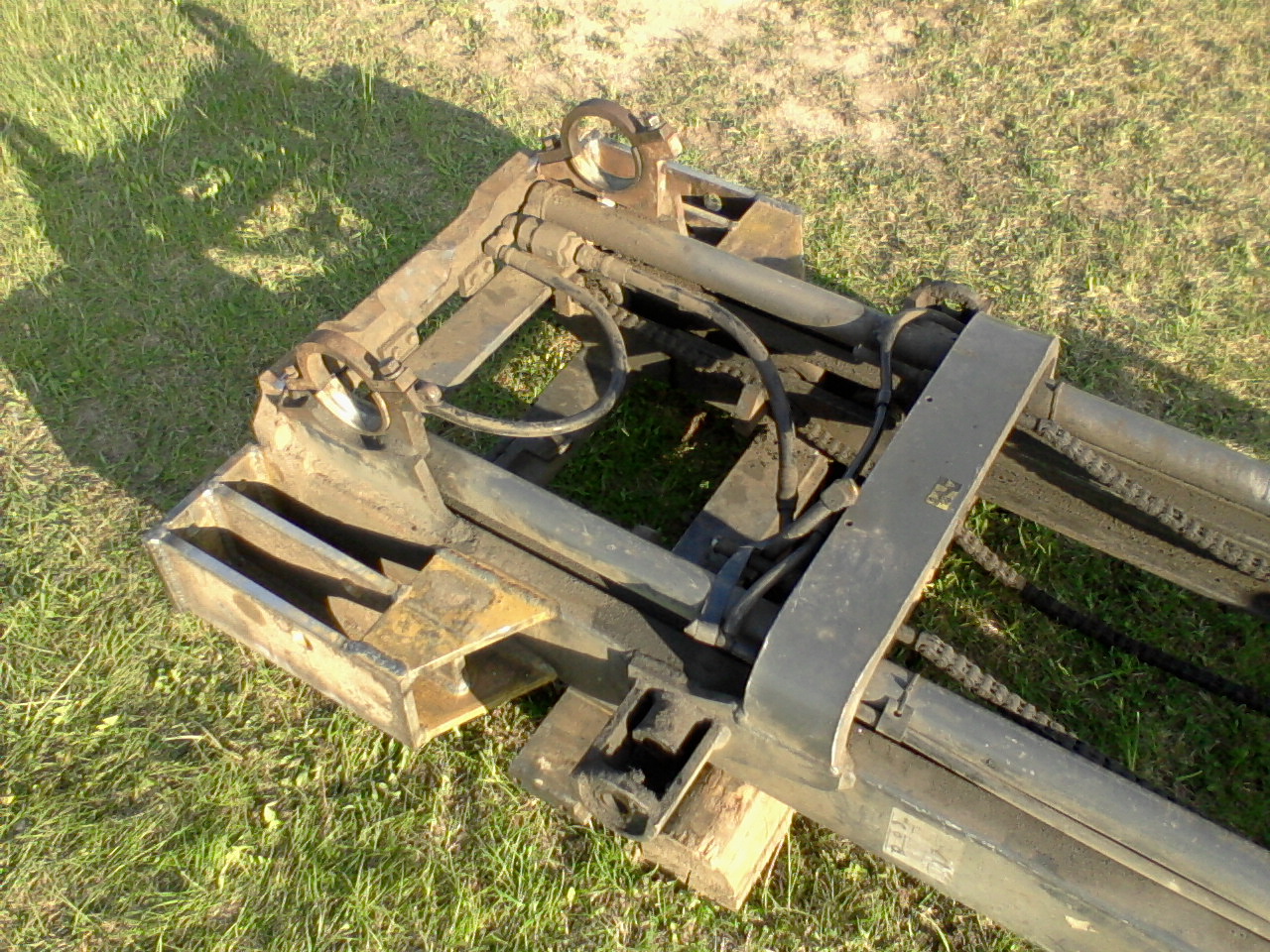

This is an example I'm now working on. I've just obtained a forklift which I'm going to adapt to my tractor. All is good, machine shop guys have welded the supports (according to my drawings) so they would fit the lift arms of a tractor. But the top link bracket on a forklift is a little bit complicated. You need to find a correct point for the top link on a forklift. Tomorrow I'll bring them that bracket already third time to correct, what means I'm wasting my time and money.
If I'd have a welder, I'd do it myself. I guess for this job EVO 180 would be necessary.
muddstopper, both welders are using 220 V, 50 Hz of AC power supply.
Big Barn, I love your exception. :thumbsup:
Thank you fellows for the advices if even they are controversial.

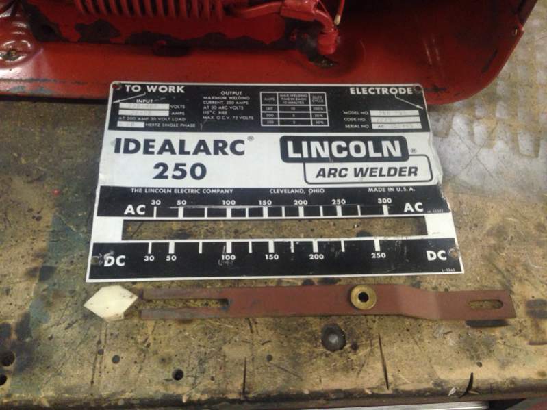

I know all the charts say 105 amps is to low for 1/8 7018, but that old Lincoln ac/dc machine would start producing undercuts at 110-115 amps and would turn the rod cherry red at 125 amps. May have been because it was plugged into a 60amp service, other than that I cant explain it.
   / Need advice on welding machine purchase #20
I'm currently restoring an Idealarc 250/250. Maybe the dial/pointer mechanism was out of adjustment??
When I reassemble mine I'll probably put in "in the middle" and see how it goes.
Terry
