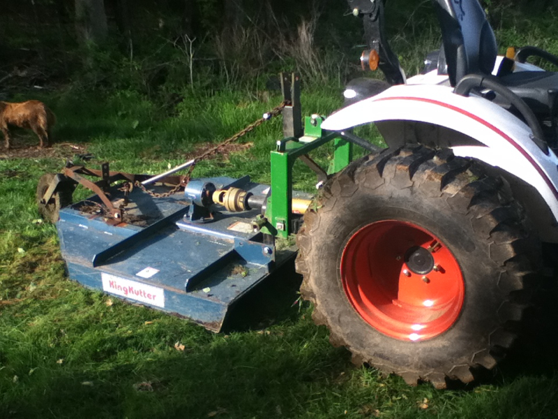

This was a pull type and I converted it to a 3-point and this serves me very well, mostly light mowing but have taken out 2-3 inch saplings and brush. But it's a king kutter 5 foot with the shear bolt. And i use a bobcat CT235 and thats 35hp. for me I have too have the quick hitch, (I'm lazy) so if you do buy one make shire it's quick hitch compatible. I would be cautious around trees with that cab though, we've gone through a lot of glass on cabbed dozers and skid steers.
