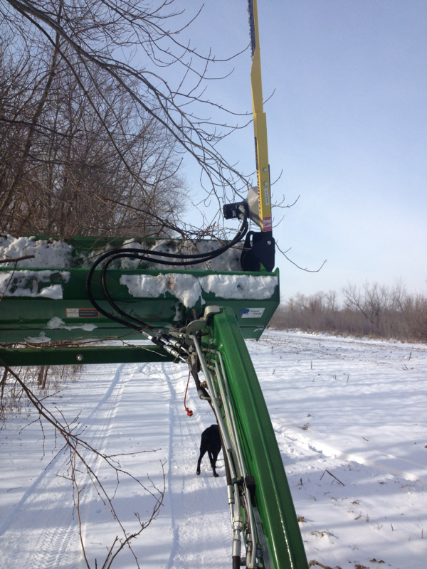

I second the samurai Sabre -- I have one for this exact task. If the overhanging / encroaching branches are 1-inch or less, this works great and reaches as high as your loader goes. You can angle it in infinite angles -- to cut ditches or above the trail. It is slow but effective. Here is an old snap shot...

That Samaria Sabre looks to be your best option for keeping the limbs cut back, albeit an expensive option. I like the pristine woodsy look for your drive rather than the cut back interstate highway look of trimming back 15 feet on each side and sloping the ground. A rear extend-a-boom bushhog would work also but much more costly. A pole saw would work for trimming the limbs but that would be a major work each year. I think I would invest a couple thousand in the Samaria and just trim it back with the FEL each year.
