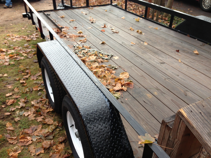

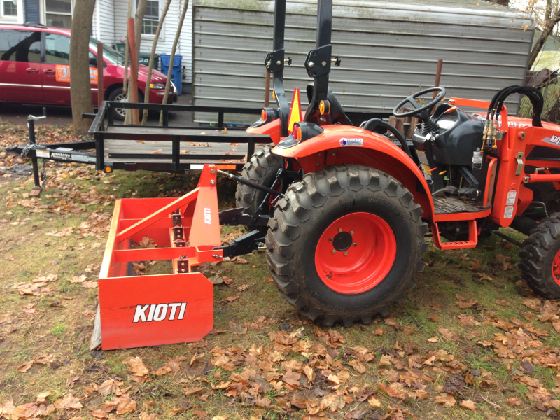

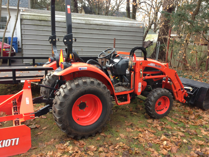

Thanks for all the comments.... Like I said, I loved my kubota but I did find it to be a bit too light for my use. I have a 2 acre lot where I like grow things,... only for the fun if it. Pulling a single bottom plow with a 1400 lbs kubota was a challenge mostly because loss of traction. The loader was a bit weak too... Kioti is twice as heavy, which should help with traction, and it comes with hydro transmission which will help with the loader work. I don't want to go any bigger than this for my use around the house. The funny thing is that I went to look at this deal only cause I was looking for a trailer the guy had in the pictures..... The way I think about it is that I got the trailer for 2 grand, and tractor/back blade for 12K. Seems like a good deal... I'm going for it! Anyone looking for a clean kubota?
