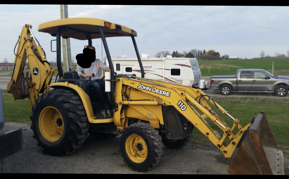

Hi, new to the forum. I just bought 7 acres and looking to demolition an old house and build a couple houses and shop. I have an opportunity to purchase a JD tbl110 and thought I could do all these projects with it. It comes with 2 buckets and forks and bucket up front. Plan on putting a thumb on it too. I have a couple of friends telling me that it would be frustrating and slow, and my money would be better spent on a excavator 3.5t minimum. Would also need a skid steer. Double the $$. What are your thoughts? I'm not a machine operator these controls over those controls don't mean much to me. Thanks for any input. Cheers
/ Need advice #2
Welcome to TBN..................
Be careful buying a JD tlb110. Many (not all) had problems with cracking around the bellhousing. Check it good for any welding repairs. An excavator will work way better and faster for digging foundations than a tlb.

Contractor quoted me 30k for demo and disposal. 30k almost pay for a decent used machine that I can use for all the projects on the property then sell it if I no longer need it. I am a contractor but don't have machinery. Just to be clear some thought I'm asking about a lawnmower tractor lol. I may not have been clear. I'm asking about a backhoe. I am aware of the bell housing issue and will inspect it carefully if I purchase it. Cheers

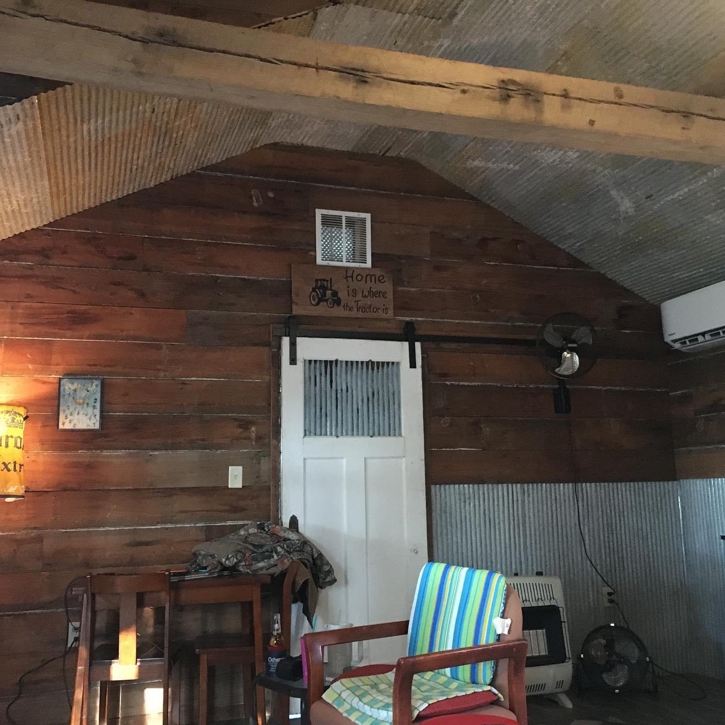

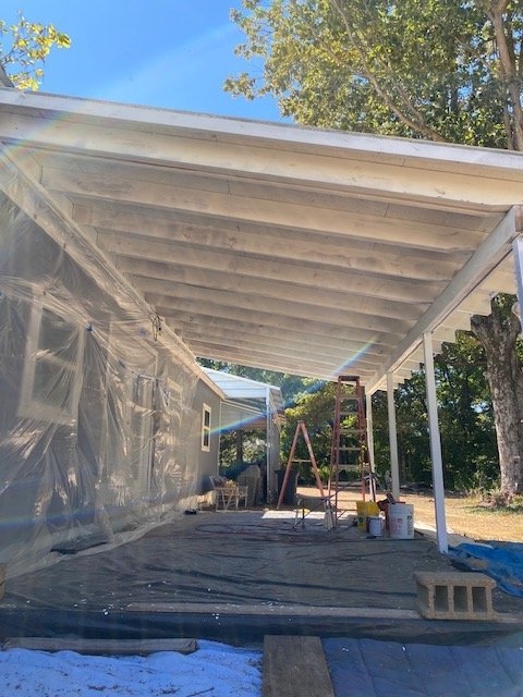

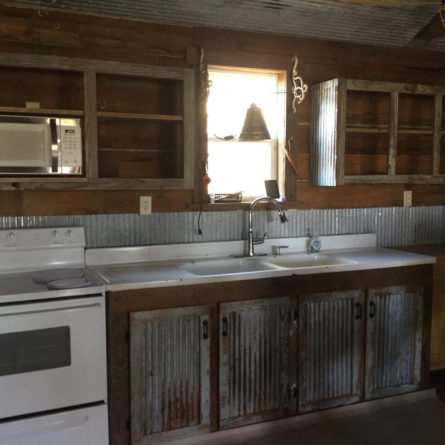

It will clean up with a brush bucket and thumb but will be slow.
I own a cut/backhoe and hired local farmer to bring a big excavator to dig a hole twice the size of the old house here and demo it in
to the hole after I had stripped all the pine & oak t&g, saw mill 1x12 cedar sheathing and as much of the oak 2x framing lumber that was salvageable.
Picked a damp day and all the old oil with some diesel made it go away, stirred it couple times with a old Ibeam using the bh thumb.
There was a 5 hr minimum so got a couple hours cleaning up the ditch bisecting the farm before my hours were up. Took longer to walk the trash 50’ to the hole than the actual demo. $200/hr was quickest and cheapest way to deal with the old .
Took me year to pull all the nails, square cut the ends, wash both sides and dry on slats to get about 3k sf of good lumber. I used every piece to build out the cabin interior.
Hardest part of the whole project was getting help. I did hire the plumbing done by a local contractor.
Im a retired contractor and I swear this is the last big project out of my pocket I want to do. But its done and being well used by family and friends.

Nothing wrong with your plan except a couple of things I would change.
A JD110 Tractor/Loader/Backhoe is NOT the right tool for that job. That model BH/Loader is cute as can be but they did have some problems....nothing JD couldn't have fixed or shouldn't have fixed...but they discontinued the very popular machine instead.
The machine you want is also by JD and is yellow, but it is a JD310/Case580/Cat316 of any vintage, not a 110. Those are the backhoe loader combo you see by the dozens on every construction site. Buy a good used one from your local utility company or school zone.
Start with the JD310. Most popular and best price...usually. Then Case580 if nice condx.
Second, for demo work the backhoe MUST have a thumb on it.
A skid steer competitive in price will not lift high enough dump far enough forward to fill a dumpster or commercial truck. It's what the JD310 was made to do.
Third, be sure to include the cost of either big dumpster roll-offs for trash.... or else hauling and dumping. It will be substantial. For a job here including 10 miles to the dump:
A standard JD 310 front loader bucket holds one (1) cubic yard of material. The green roll-offs that the truck drops off for you to fill with trash and broken lumber hold 12 cubic yards packed down hard. Here, they cost 600/700 apiece to drop off/pickup/dump. If you do it with a pickup truck instead, a PU bed will hold a bit less than 2 cubic yards and costs $100 to dump at the dump/trash site. A 12 foot trailer will hold 2 to 3 cubic yards heaped and tarped... and cost $125 to dump. I figure that house is going to be somewhere between 7 and 20 roll-offs demoed.
It all depends on how you stack the roll off... Using a helper with a contractors trash saw, plus the bigger 310 with a backhoe thumb and xtendahoe can save you $4/5K in disposal costs.
All that is assuming no hazardous material.
I'd say the bid you got is too high for the photos you show. See if someone else will do it for $20K. If so, let them. Be SURE to include concrete removal in costs.
