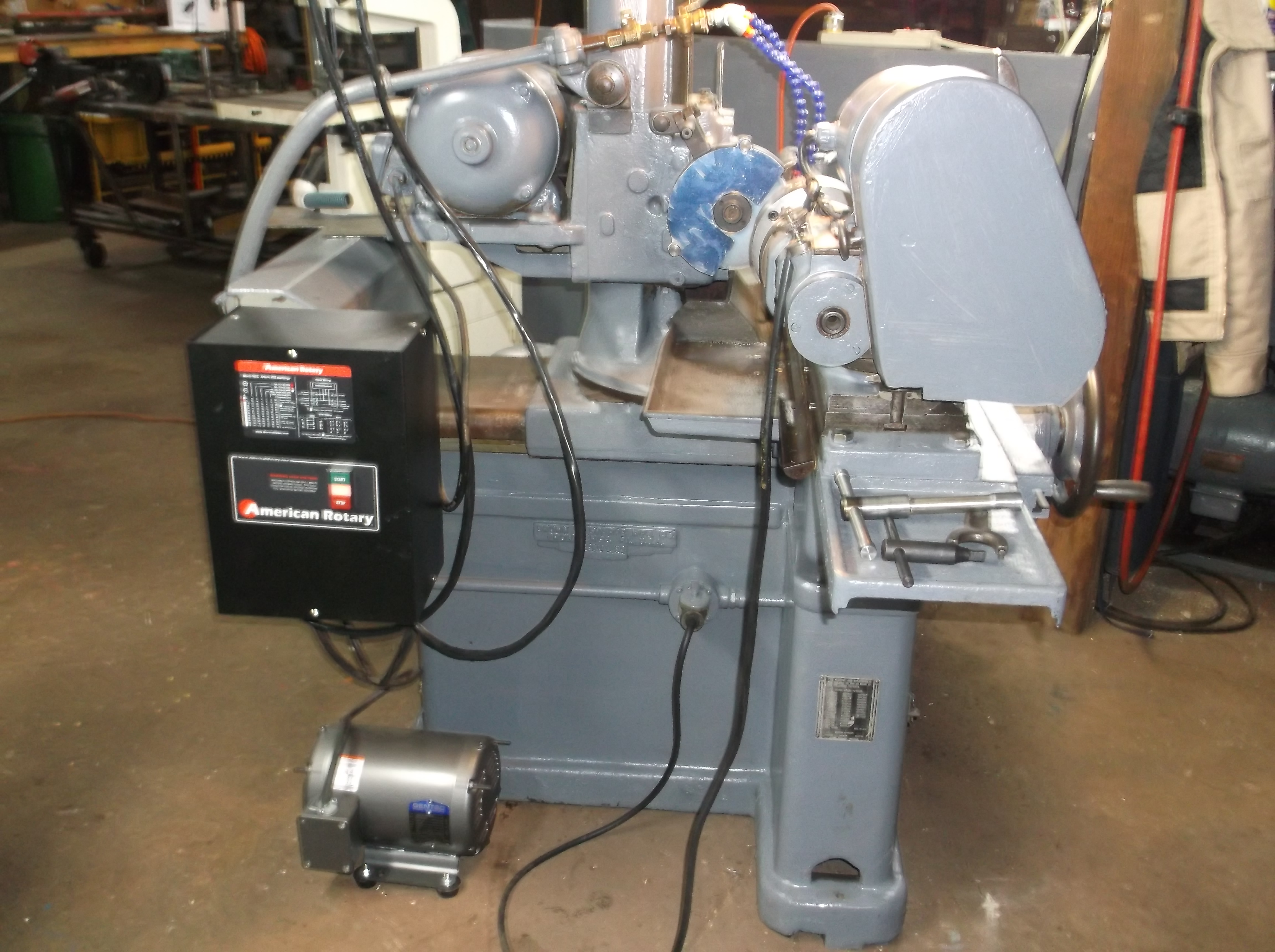

You guys are great and thank you for your suggestions and information. I have ordered a 5 HP Rotary Phase converter. The 4 motors on the grinder are all wired to be powered from a single point. Ken Sweet
   / Need advise on wiring a OD Grinder
Update: I got the Rotary Phase converter installed over the weekend and it works like a charm. Ken Sweet

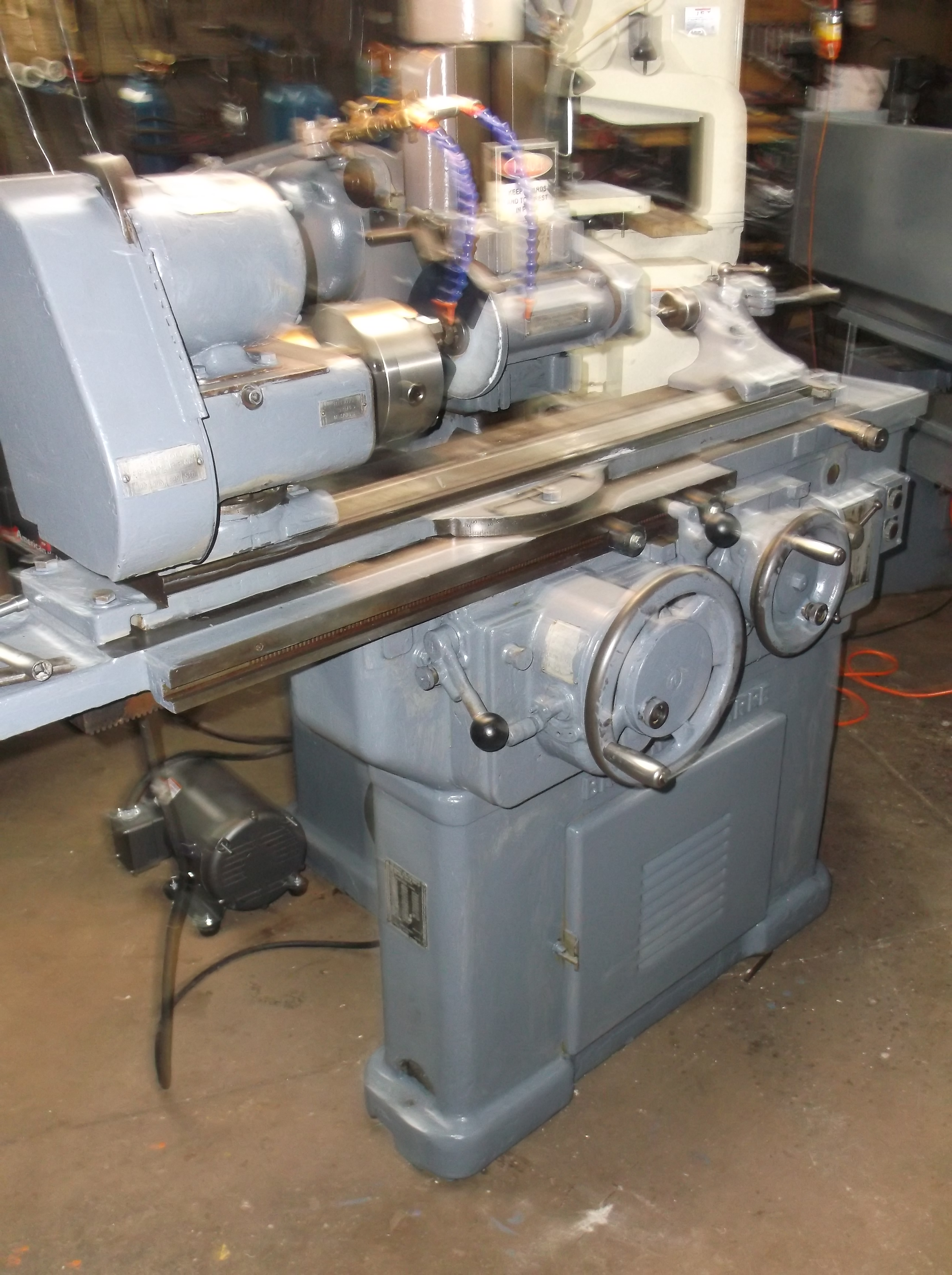

I finally got a few pics of the Brown and Sharpe #13 OD grinder. It has took a little longer than expected as I also just installed a Boyar & Shultz Challanger Deluxe surface grinder and have it wired into the same 5 HP American Rotary Phase converter. Both grinders are working very well, even when operating both at the same time. Ken Sweet

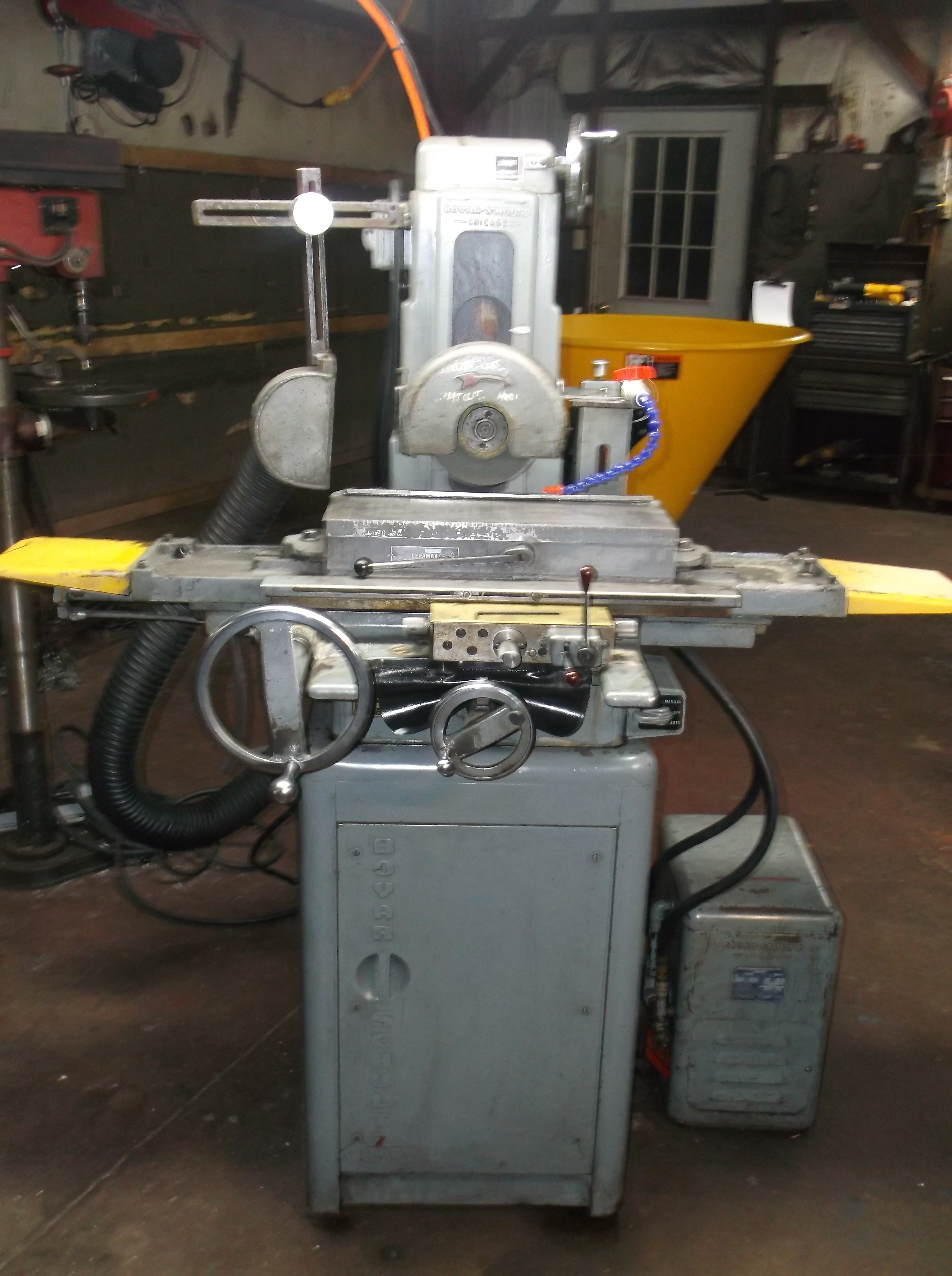

We have a Boyar-Schultz Challenger surface grinder here at work, it's a tad dirtier than yours but close to the same thing. The magnet is 6" X 18".

Nice looking surface grinder. Does it get much use at your workplace? Mine is a 6" x 18" as well. So far the only thing I have found that I dislike about the Boyar & Shultz is that it is a little harder than I am used to when using the cross feed manually. Ken Sweet
