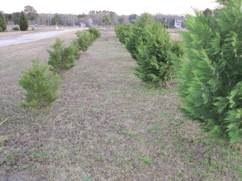

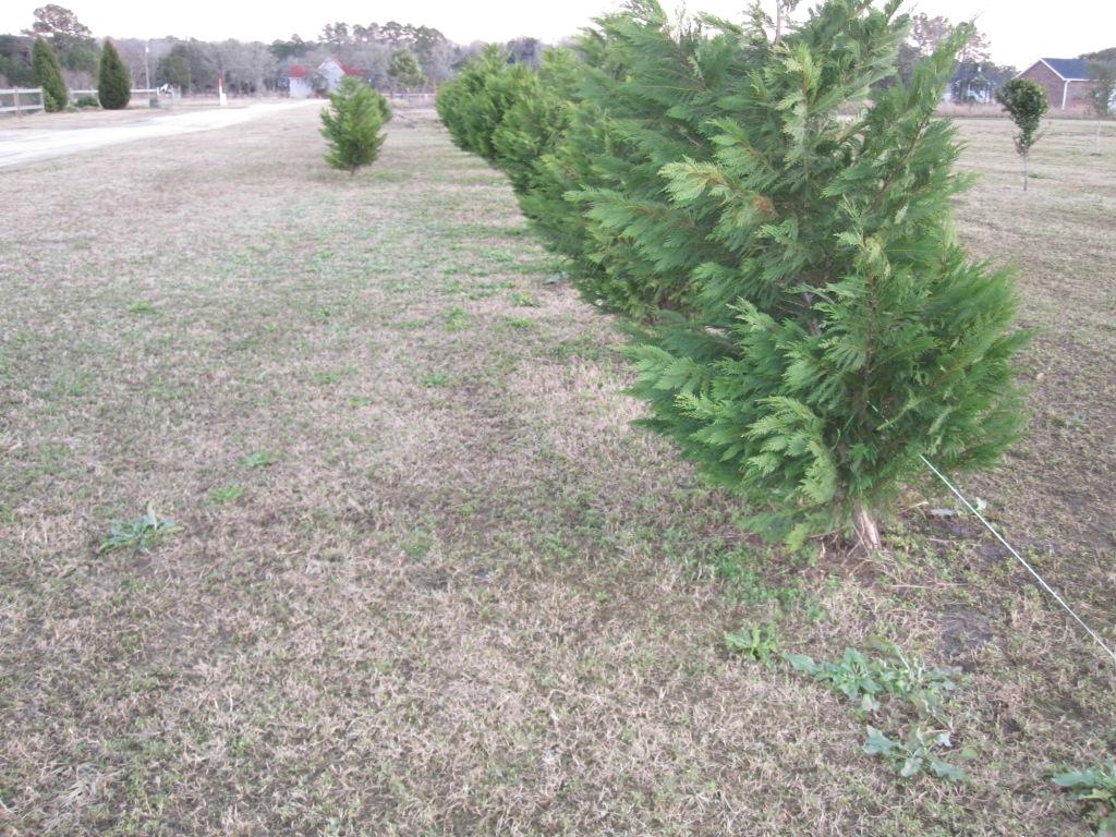

I have two rows of young leyland cypress trees, approximately 5 years old and 6 feet tall.
During the winter when the ground gets saturated, some of the trees will blow over a little when the winds kick up. This only happens in the winter and is a direct result of standing water on the root balls.
I need to dig a ditch between the two rows of trees to reduce the water table and firm up the ground. problem is the trees are only 10 feet apart.
I guess I need to rent a mini excavator to dig a ditch?
I would rather cut a swale between the trees but 10 feet is not enough room. I need to address this problem before these trees get larger.

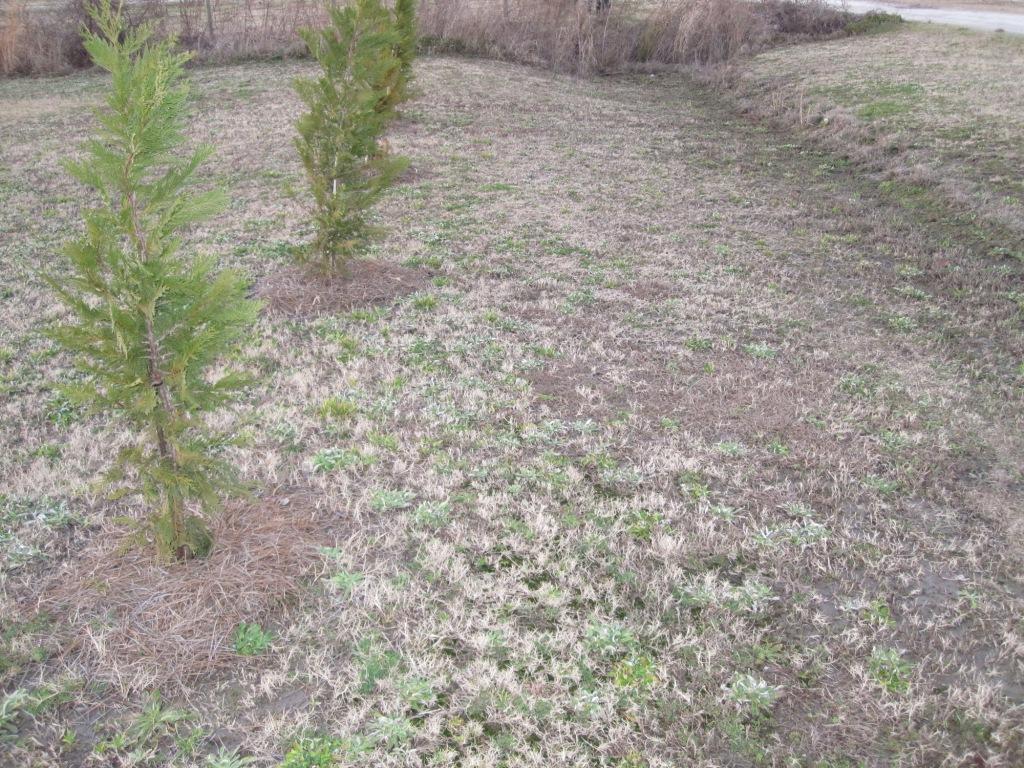

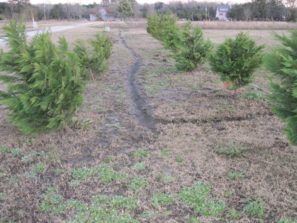

Here are some pics....
You can see in the first pic I have planted some small leylands on in October. You will see they have a swale besides them.
The other pics are of my 5 year old trees. Notice how the left hand side is smaller ( I believe due to lack of drainage).
The last pic is a poor attempt to remove standing water with a shovel.
