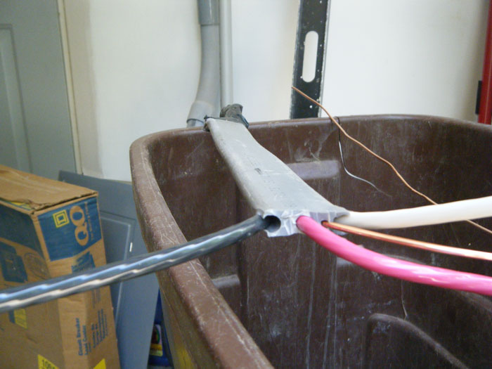

I practiced a few times so I made my decision. Rather then cutting the insulation on the flat side I slowly and carefully sliced away insulation on the edge of the black conductor then pulled the conductor away from the the insulation. Going to the opposite side I freed the red, then the ground lead, and finally the white. Whew it came out unscathed.
Before I cut my wires and snug them down could I ask a little more?

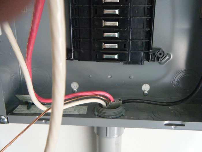

In the photo of the sub panel where I have entered the panel using plastic conduit should I be using a plastic grommet screwed onto the exposed threads as you would with metal conduit?
Lastly (I hope) should I install a ground rod outside of the garage with Number 6 wire?
The second photo is just to show what I have been working with for cable.

Yes to the ground rod "required" and no to the plastic end bushing,, The NEC says #4 or larger only and you have#6...
PS.. good job stripping... :)
   / Need electrical advice #17
CeC is #8 awg or large needs bushing regardless of the conduit diameter. So I guess there is differences.

As long as the breaker in the house is 60 amps, you can leave the shop panel with the 100 amp main breaker and there will be no problem. The 100 amp panel is protected by a 60 amp breaker at the house. so all is well.
You DO have to drive 1 ground rod at the subpanel (shop) even though you have a hard wired ground wire run with feeders (NEC REGS).

I have found a real easy way to do it. I use a sharp utility knife and insert it between the bare ground wire and the white wire. Then I PUSH it away from me while angling the blade into the bare copper side. i NEVER nick the hots or neutrals doing this. Then i do the same thing on the other side of the ground and the RED wire. After i have separated the ground wires, i make a slit at the end of the White wire side in the area left available after the ground wire was removed. Then i simply peal the White wire out of its sheath.
I do the same on the hot side. After the Red wire is removed, a small slit into the red leader will allow its removal from the outer sheath.The black follows the same way.
These slits are done towards the cut ends of the wires, and always on the inside layers (the inside are the layers that were next to the ground wires. The insulation is thinner there.
