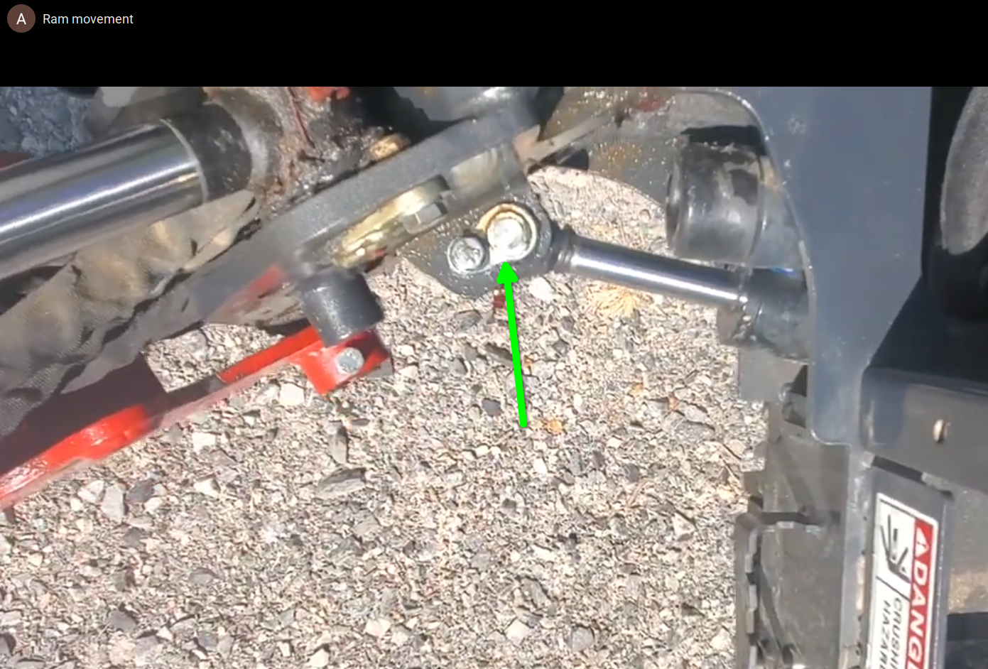

Hi guys.
I was posting on the hydraulic forum about my backhoe BH150 problem with my 2022 2515R
On the swing it starts real fast, then slows down, then jumps again slamming the tractor,
I recorder it on idle RPM because on the 2000 it is so violent.
Here is the forum
below are the videos.
Could you guys who has similar tractor with backhoe run a similar test and even better to record how your backhoe is moving.
Branson claims it is OK which IMO they try to shake me off and do not honor the warranty.
If i have a video of correctly running BH, i can have a case.
   / Need favor from Branson 15 series owners #2
That looks like "slop" in the hydraulic cylinder mount/hinge points to me.
You can even see it moving in your video.
