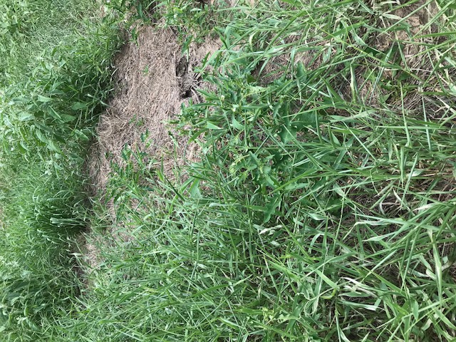

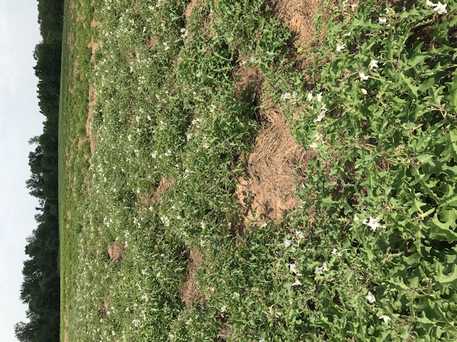

I am retiring on Dec. 31 after 30 years in Federal Law Enforcement. The wife and I bought 20 acres in the sticks to build a house, and enjoy the country. Approximately 9 acres of pasture, 11 acres of trees. The land has very sandy loam soil. I plan to have a road laid with "recycled asphalt." Water will be from a well. The pastures have old matted dry grass with large weeds that have taken over (pics will be attached). The sandy soil is, how do I describe it, "bumpy?" Kinda like you might have wet muddy pasture that was driven thru with a tractor, and then it dries with the tire tracks. But this is very sandy, so the bumps could easily be smoothed out. I really want to get the pastures under control with some coastal Bermuda.
Main topic of this thread it to understand what kind of tractor I will need, and what implements.

Pic of Weeds and Pasture
