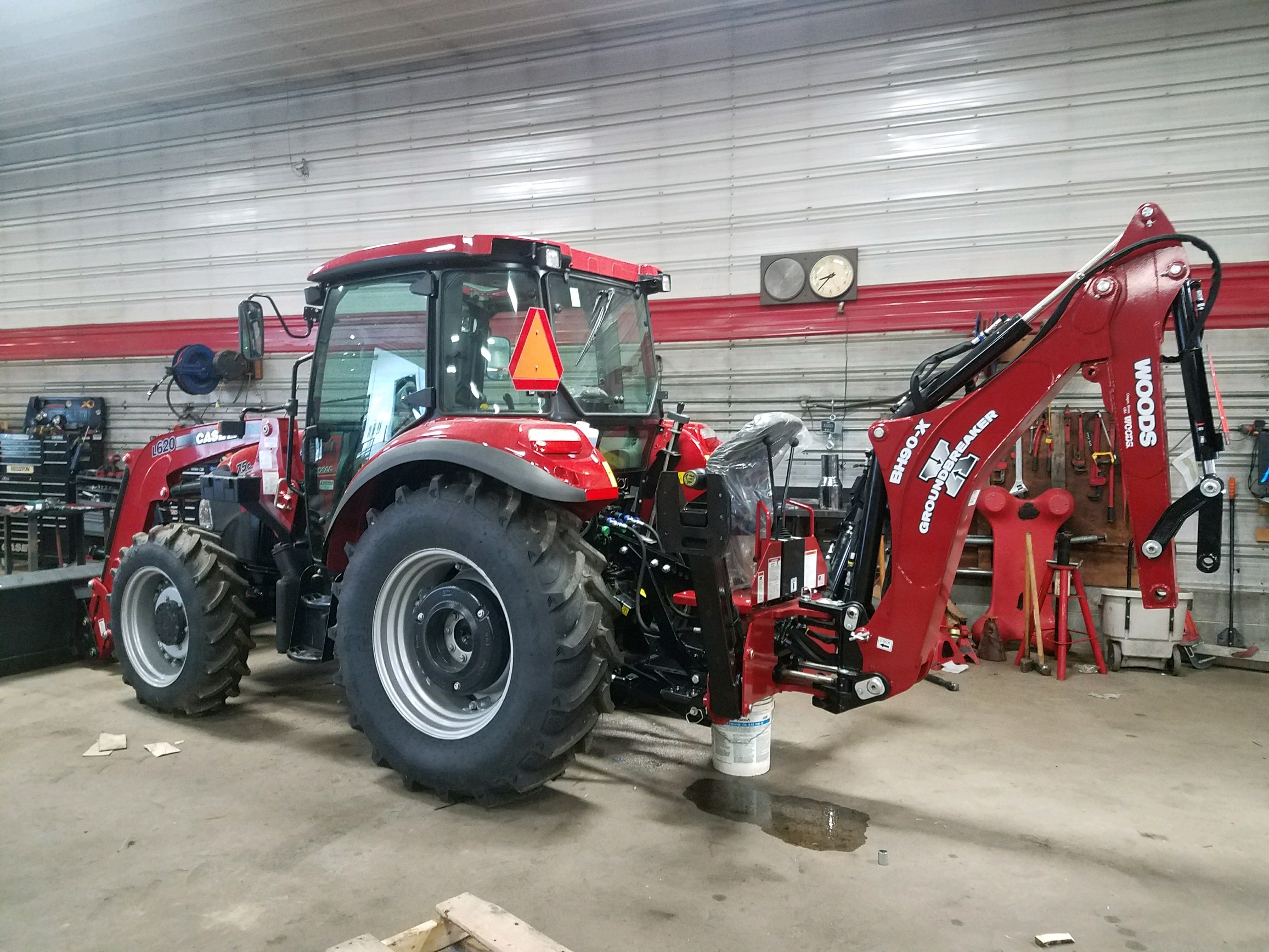

/ Need First Tractor. . . I want to learn! ! ! #56
Okey Doke. . . I致e been soaking it all in, but I have a question. A couple of y誕ll have mentioned backhoes. RandyinTN mentioned he just ordered a new tractor with a FEL and backhoe. Other than digging holes, what types of jobs around the property would I use the backhoe on? Don稚 spend too much time on this question. Sorry for the stupid question.
I have a thumb on the backhoe and that makes it useful for lots of things. A thumb makes it a whole different tool. It carries trees and big rocks and can place either one of them easily and accurately. With the thumb I can also pick up piles of debis and put them somewhere else. The backhoe is very handy as a crane for picking up heavy implements or tools and putting them down somewhere else very gently and accurately. Of course it is good for digging holes and trenches, but I really don't use it as much for that . Most use is as a landscaping tool or handy stong crane for lifting and placing.
rScotty

/ Need First Tractor. . . I want to learn! ! ! #58
Not a stupid question. It is one widely debated on both sides of the aisle here on TBN. You will have to evaluate what tasks you will for sure be able to use the backhoe on or specifically need a backhoe or excavator of some type to perform. Do you have enough tasks to justify purchasing a backhoe with your tractor? Then you have to look at your availability to use a backhoe or excavator time-wise. Since you are retiring and "should" have more time (I know some guys who are busier retired than they were working) it may be cost beneficial to you to rent equipment for a day or 2 if you can line up all your projects to be done one right after the other. You will have to evaluate the cost of getting the backhoe attachment vs the cost of renting equipment or hiring out the job. If it makes sense to get the backhoe then get it. If not, then rent or hire out.
In my case, I work an average of 60 hours or more a week so I have limited seat time in big blocks of time so I need availability of my backhoe at all times so I can get a couple hours in here and there. I also have enough projects on my 20 acres including building a house over the next 2 years to justify the cost. Everyone's situation is different - the main concern is not to frivolously spend money on an item you won't use but on the other hand not waste money having to hire out or rent if it doesn't suit your situation. In the end, it is your money and your choice, we can only give good or bad advice. :D hth.
