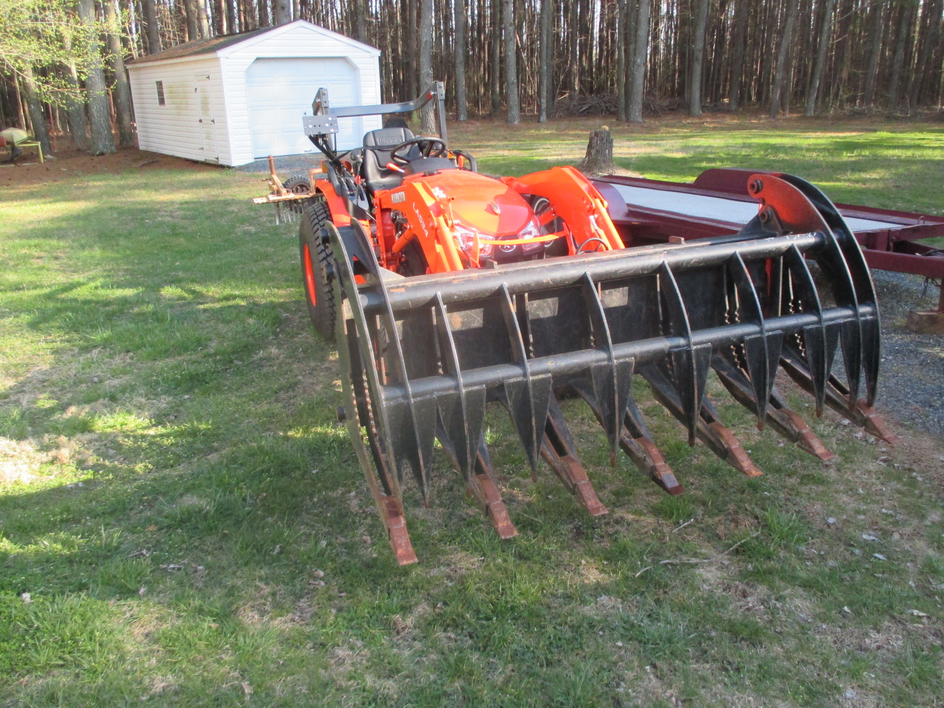

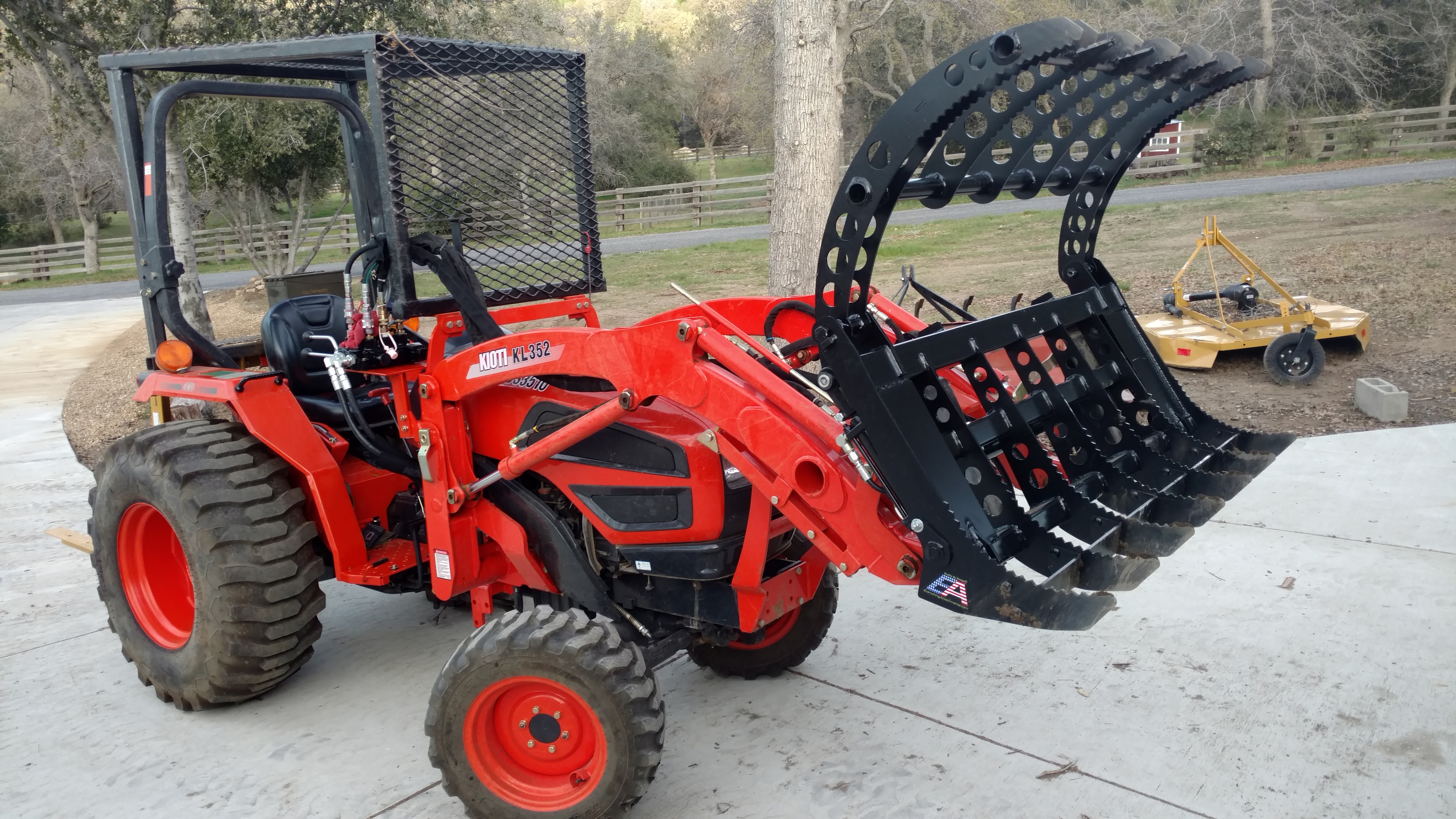

EA also does true grapples, not just bucket attachments. Here's one specifically for a BX: Root Rake Grapple For Kubota BX
Here's another slightly bigger one on a small CUT (mine).

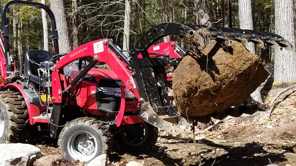

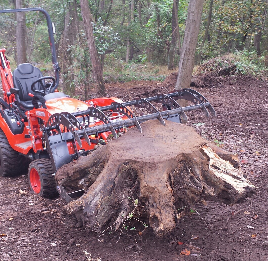

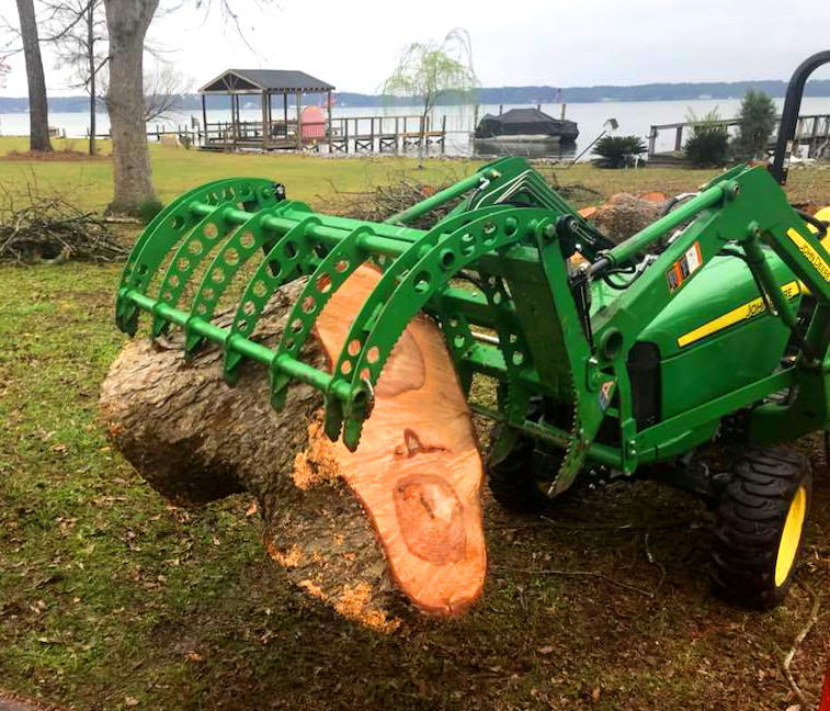

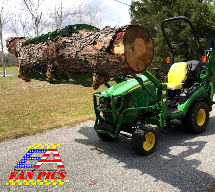

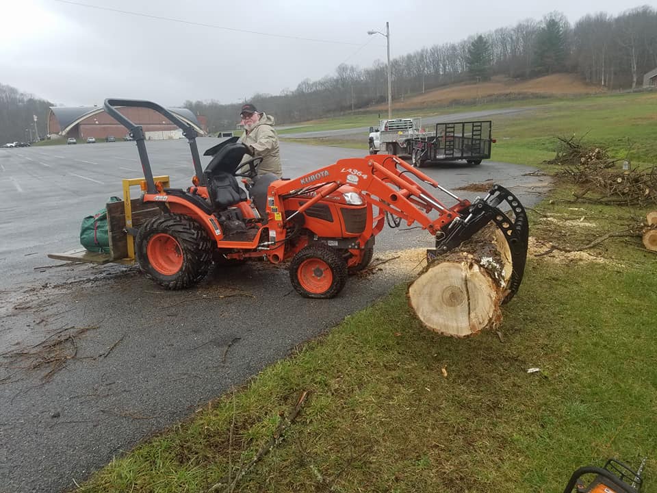

Our Wicked Grapple lineup has grown to allow me to recommend the MOST IDEAL grapple for so many tractor sizes, unlike any other manufacturer in existence..
The 200 pound Wicked 55 root rake grapple allows small tractors to do BIG things. Here are some examples.
Travis
Kubota BX23S
Kubota B26
Kubota B2650
Kubota B2920
John Deere 1025R
John Deere 1025R
John Deere 3032E
Video of a John Deere 2038R. VERY impressive! John Deere 2038R with 55" Wicked Root Grapple Tackling Big Log - YouTube
Mahindra Max 26

I am 100% getting a Wicked 55" to share between my new BX2380 and my Branson.

FWIW...Almost all the loads (including the brush) depicted in the images could be done with just a thumb type grapple on a regular FEL bucket...

My tractor was the biggest I could handle on my property, and the FEL is a small step above a BX. Weight was a consideration when I was thinking about a grapple, which led me to the Wicked 55. It weighs less than my bucket, and when I have the bucket on I'm not carrying the weight of a grapple. As an added bonus, I can see through the grapple, which is a great help for a newbie like me.

When positioning to pick up single items (like a rock or railroad tie) I can see what I'm doing better than looking at the back of the bucket. The grapple also digs rocks out much better than the bucket. It also rakes a whole lot better than a bucket.
I felled a dead pine the other day and limbed it where it fell. Grabbed the trunk with the grapple and raised it up to section it. Transported the trunk sections to keep as bonfire wood, then raked the branches and took them up the hill to the trailer. I've done similar without a grapple, and this was much easier and a whole lot faster. A thumb would have worked the trunk OK (as did the strap on the bucket), but the branches were easier with the grapple rake.
