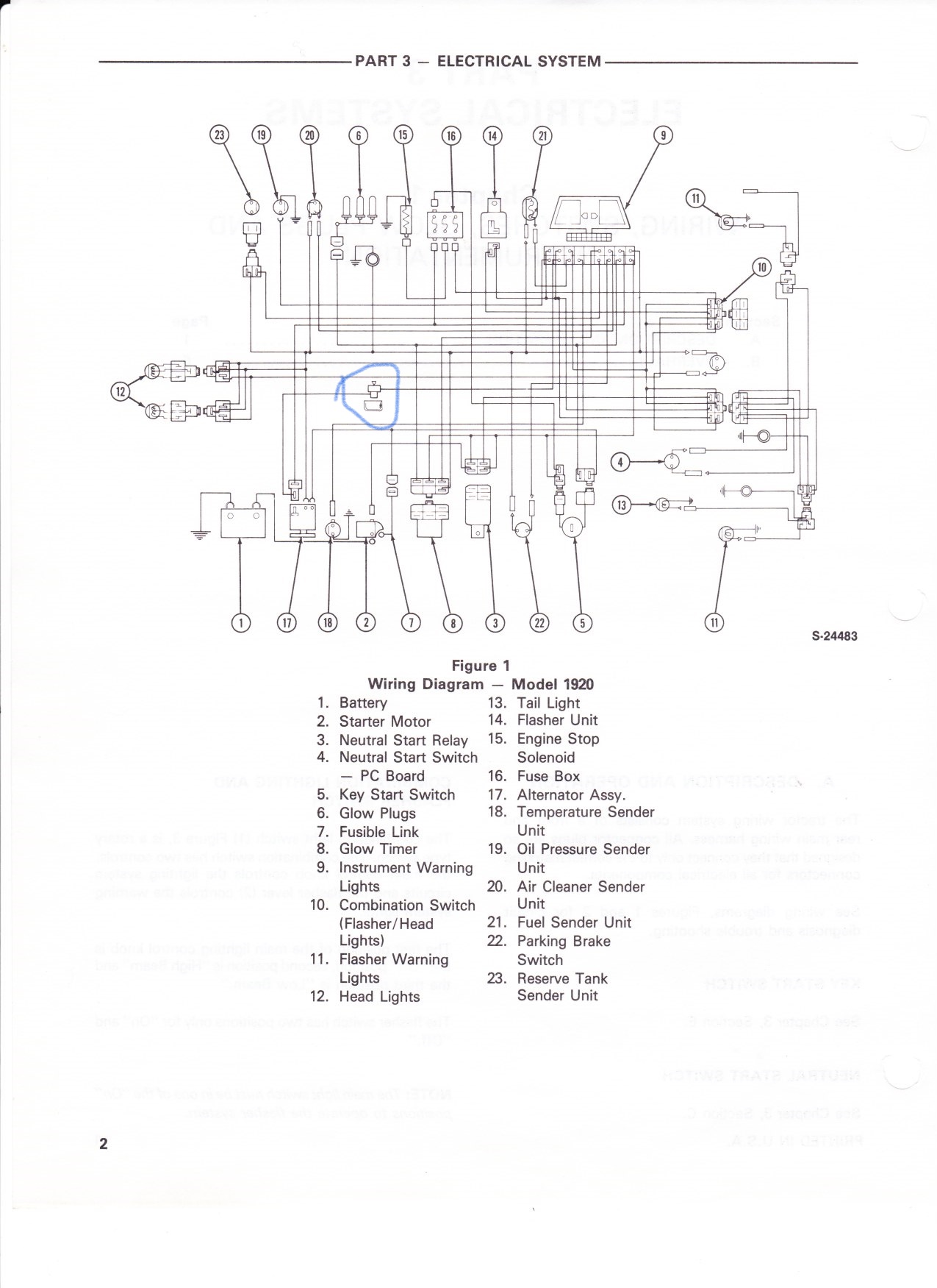

Me again. Before this weeks snow, I chipped the last of this years brush, put the backhoe on and dug out one of three stumps that I want out. The fuel gauge is stuck on full and the temp gauge stayed on cold. I took the fuel gauge out and the winding on the voltage side of the gauge is dark.
A few observations:
the voltage coming out of the alternator is just over 14v.----seems normal; not excessive
the new fusible link is fine; not like the old one that was hanging on by a thread.
every other electrical function operates as it should; the only exception is the glow plug timer light, which doesn't go off after the 4 seconds as designed to. BUT the service manual states:
"If the timer relay malfunctions, it will adversely affect the indicator lamp, however the glow plugs will continue to function normally."
The manual didn't explain the function of the diode I circled in the wiring diagram. Does anyone know what the diode controls? Thank you.

Your boys haven’t been using the battery charger again have they? Don’t have a clue about the diode.
Smilingjak
Nope, the battery is only 2 years old, no need for a charger. That was funny though.:laughing:
