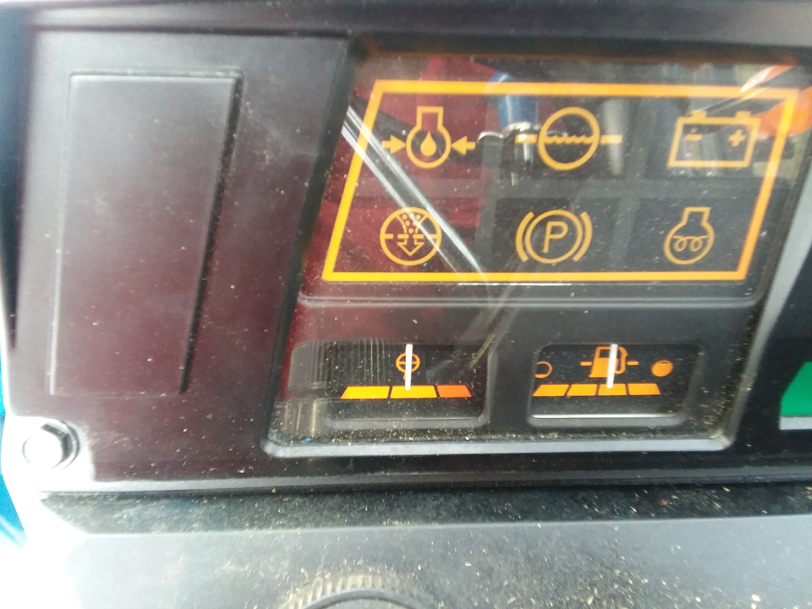

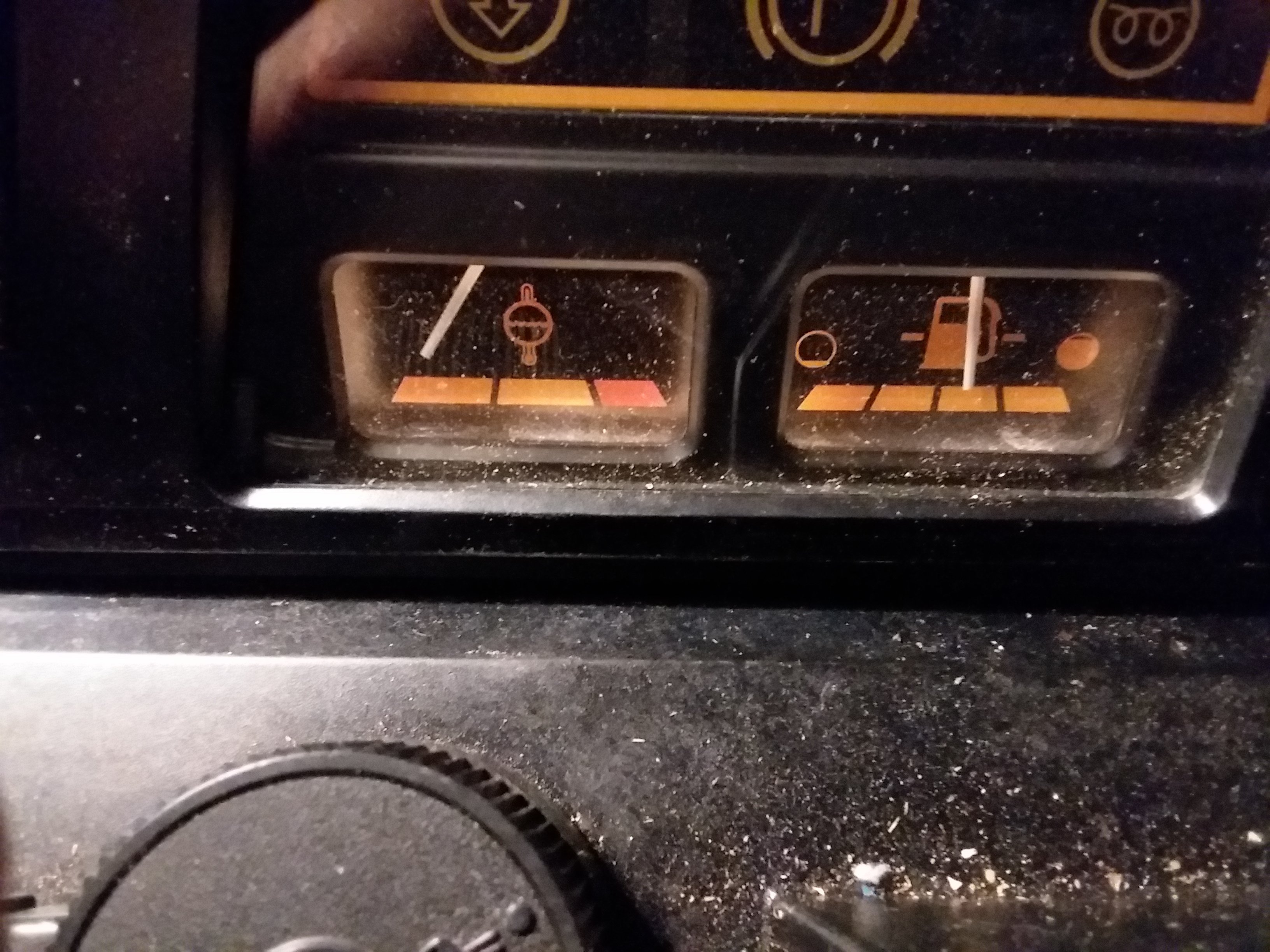

Today, 12/8/19, is an awesome day, the Patriots lost :thumbsup: and my gauge saga is OVER!!! :) Over Thanksgiving weekend I took off the neutral start safety switch and cleaned it. A new one is over $120. I saw a YouTube video where a guy with a 1920 cleaned his switch, so I figured I'd try it. Yesterday I recleaned the main ground. It's shiny now.
I spent about over an hour moving a snow pile yesterday, but the temp gauge wouldn't budge. It was only 23*. Today I covered approximately 80% of the radiator with cardboard and moved more snow and started digging around another stump.
The first pic is from yesterday, second is today. Thank you to everyone who responded. I'm not looking forward to the next electrical gremlin, but I won't be afraid of it, thanks to the advice from the more experienced among us. Thanks again.:thumbsup:
