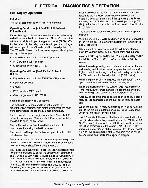

   / Need Help.. 2305 won't Start #14
Hope this helps.
#15
Thanks Davkir, That will give something to go by when i'm trying to trace down the problem. I'm thinking it has to be the Pull-in Relay or the Relay timer. Thanks again
#16
Ok guys, it's fixed... Problem: k2 pull-in timer relay!! A local JD dealer gave me a step by step procedure to find problem and after about a hour of research , i found it. If anyone ever has this type of problem , let me know and i'll be glad to send you the info. i received from JD. Thanks again for everyones help.
