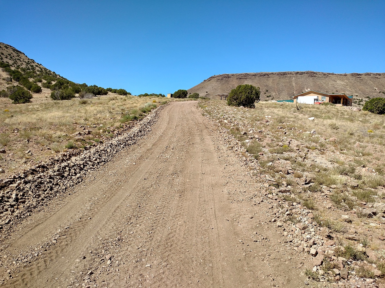

My property is pretty much rocks with a little bit of dirt mixed in. My "driveway" was carved out of the native soil with a dozer and has no gravel or other materials added to it. Just last week I cleaned up where recent rains had brought the rocks up. I used a landscape rake and box blade.
What it looks like after about a week. Don't have a before shot.

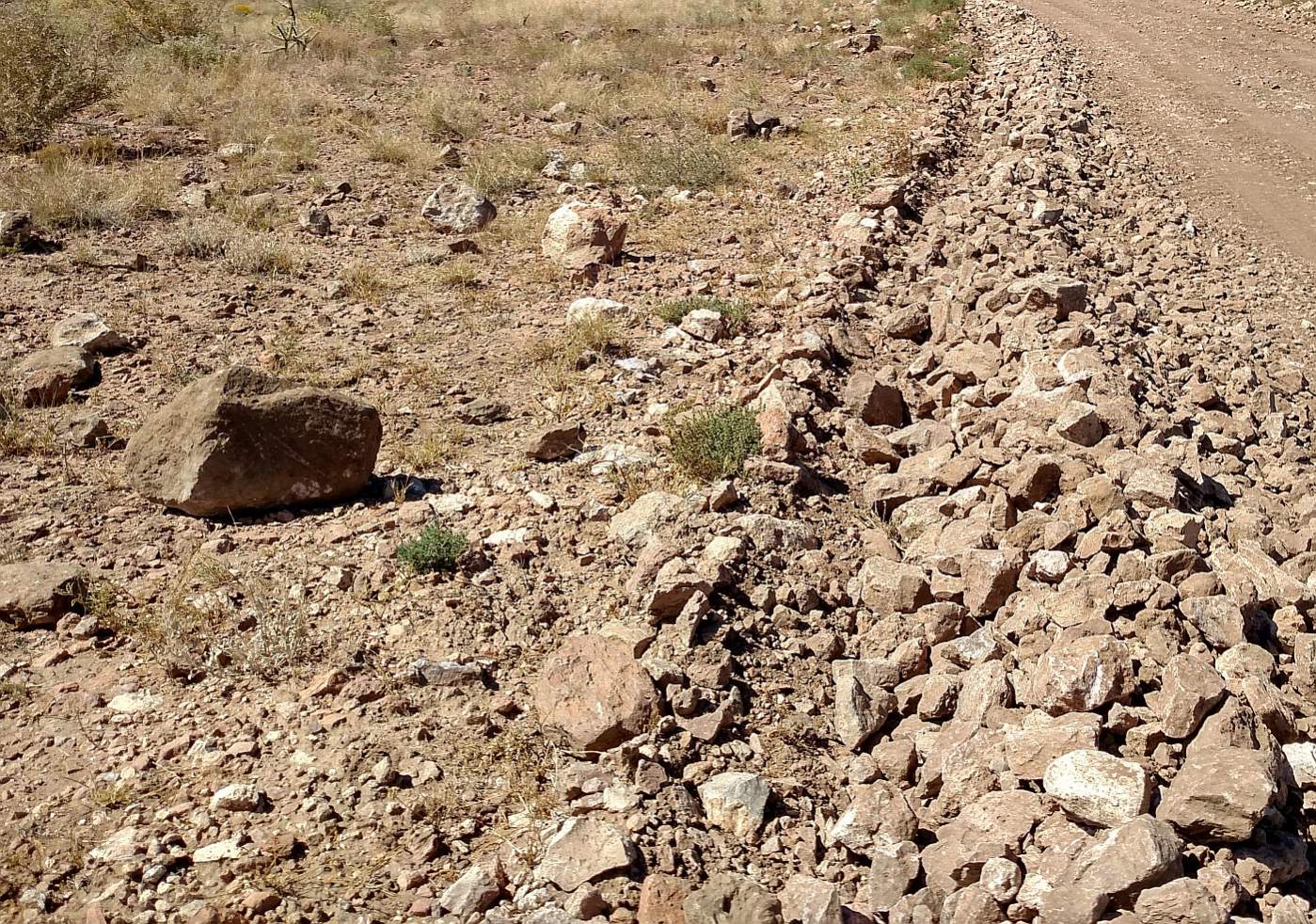

Close up of the windrowed rocks at the side of the road. See the lovely boulder.
I used my box blade with the rippers dropped down all the way and the box tipped aggressively forward but not really using the blade itself. After several passes up and down to bring up the top layer of rocks I then walked it and tossed out most of the cantaloupe-sized and larger rocks off. Followed up with the rake set at 45 degrees. As it is only a 72" rake (tractor width 60") it left the windrow right behind the trailing side tire which is why in the picture it isn't quite off the driveway. Getting ready to order a rake with offset capability so that I can push them the rest of the way the next time.
As someone else mentioned if there are that many rocks on top there is at least that many underneath. Turning that into a field suitable for planting doesn't seem realistic to me (if that's what hte OP is thinking) but you could certainly clean up the surface with a rake.
